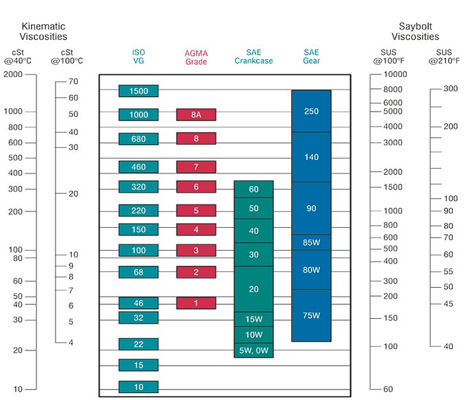

I can say that for my 1445 there is no detectable difference in cold starting going from a 15W-XX oil to a 5W-XX synthetic oil, at least down to 32F. This is about what is to be expected from oil viscosity tables. For me, there wasn't any obvious improvement in high temperatures going from XXW-40 to XXW-50 either. You might want to consider that wide viscosity range oils (e.g. 5W-50, or 0W-40) breakdown faster than narrower range oils, such as 15W40, because more of the oil's properties are in the additives, rather than the base oil. The first number is the cold (Winter, W) viscosity, and the second number is the high temperature viscosity.
I have attached a plot of some oil viscosities below, so you can see how small the differences are at low temperature between 5W and 10W oils. Note that 0W and 5W oils have nearly the same viscosity.
Based on my experience, I think that oil heaters and oil coolers work better than trying to go for a different oil. The synthetic oil that I added seems to be aging as fast as the original oil that Power-Trac filled the tractor with. (Based on darkening of the oil)
YMMV of course.
