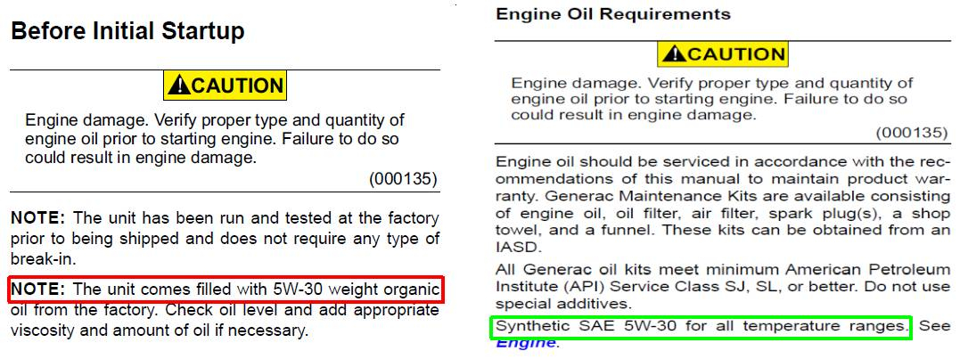

   / I apparently don't understand oil weights #24
This is from my generator Install (left) and Operator's (right) manuals. If 5W30 is supposedly only good below 50F, why are they spec'ing it for all temperature ranges?
Also note, they supply 'organic' oil, but recommend synthetic.
5w30 is good for the 212 F it sees against your thermostatically control cooling water typically at 190 F.

   / I apparently don't understand oil weights #26
they want engine to break in with non-synthetic oils is the only reason. they recommend swapping to synthetic after 25 run hours.

   / I apparently don't understand oil weights #29
It isn't the hot rating. It's the cold so to speak. If the ambient is below the hi number they suggest a lower weight oil. Got nothing to do with it's hot performance. They are saying when the ambient is cooler use lighter. It's still about cold starts.
   / I apparently don't understand oil weights #30
