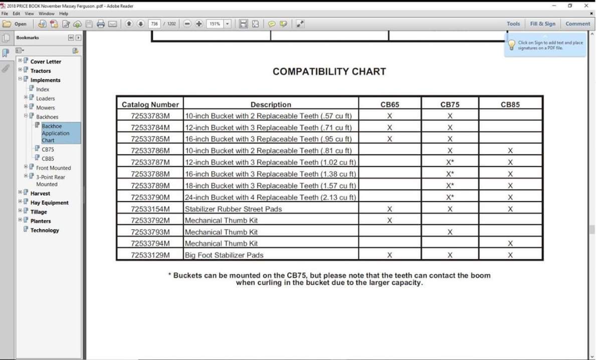

I wanted to add this incase someone searched this post. My tractor came with CB65 backhoe. They sell them with a 10" or 12" bucket but they offer a optional 16". Here is screen shot MF price book.
It does look big on a sub compact but they are a strong backhoe and made to take a bigger bucket.
