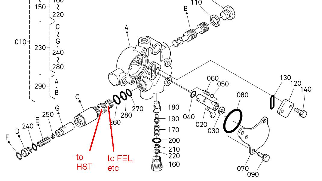

I am trying to troubleshoot a HST problem on a bx1830 and looking through the flow diagrams in the WSM the one part I can't figure out is that it shows the transmission oil comes charged at high pressure from the hydraulic pump to the flow priority valve, which then sends it to the power steering (or to the implements). The flow path then shows it passes through the power steering and on to the HST at low pressure (i.e. charge pressure spec is 40-70psi), where it is then pumped back up to high pressure by the HST pump.
So how did the power steering reduce the pressure from just under 2000psi to 40-70 psi? Did I miss something?

There is a charge relief valve, item 8 in the schematic that I would assumes maintains the charge pressure. The oil coming out of the power steering will not be at 2200 psi as there should not be enough restriction to build that much pressure. The PTO relief will maintain a much lower pressure, sufficient to keep the PTO clutch engaged, maybe 150-200 psi. The drain out of the PTO relief feeds the charge relief and most of the oil flows over the charge relief to tank. If you do not have enough charge pressure, you could have a problem with the charge relief or you could have a leak in the PTO circuit.

The power steering likely will never see 2000 unless you turn the wheel all the way to the physical stop, at which point the power steering will relieve...but what it relieves past the relief is just flow, not pressure. The pressure was on the power steering side of the relief. So flow goes on to the PTO...and the PTO selectes it's pressure with it's own relief...and that flow (not pressure) goes to the HST, and it selects its desired pressure with its own relief.
The HST relief just mainly tries to make up for leakage if I understand correctly. The pressure is quite low. It tries to form its own local sump...so that that the HST pump has fluid to pickup and pump to the motor side of the HST.

Its a problem with an bx1830 (500hrs on the clock, garage kept and babied) that I posted about a few weeks back. I don't have power under load and get a chattering that sounds like the HST is starved.
I first checked the transmission oil level, it was fine, went ahead and changed the transmission oil, filter and cleaned the screen as it was due. They all looked fine and I used super UDT2 as directed. This didn't give any positive result.
Next I checked the pump pressure at the front end loader, it was actually about 100psi high so I removed a shim and got it within spec (about 1800 psi). I also left the tester on and drove the tractor under load and then actuated the loader control during the chatter and got a reading of just over 1800 psi, so it seems the pump is keeping up under load.
I then got the parts to check the charge pressure and the forward motion circuit pressure. The charge pressure was at the low end of the range around 45 psi (range per WSM is 42-71) at a standstill, and when I drove the tractor up a hill to get the chatter going the charge pressure dropped to around 20psi or less.
I also checked the forward pressure under load (fyi, chatter is in forward or reverse), and got a max of 1100 psi. The high pressure relief per the WSM is 1991 psi.
So it seemed I wasn't getting oil to the HST in my very amateur opinion. I wondered about the flow priority valve as it splits between the implements in one route, and the power steering/HST in the other route. I took it apart and cleaned it, replaced it, and it didn't help. I also cleaned and inspected the charge relief and PTO relief although they looked fine.
My thought now was that the priority valve may be acting up. If you look at the design its spring loaded with the idea that if the pressure drops it blocks the flow to the implements. On the flip side under high pressure I wondered if it would push the plunger far enough (i.e. with a weak spring), to block the flow to the HST and give it all to the implements (under load chattering the FEL has tons of power).

I thought I would post an update. I picked up the flow priority valve yesterday and once I installed it seemed to clear 90% of my problems with loss of power and vibration with my BX1830. Before it didn't even have power to drive in and scoop up a pile of light mulch. Now it can easily drive into heavy topsoil and doesn't seem to have any power problem.
The only reason I won't call it 100% is I still have some minor vibration when I was really pushing it and normally the high pressure relief trips on the HST.
I am thinking those valves might need to be checked as I was pretty certain in the past when I got to the point where the HST just simply hit its pushing limit there was a more smooth relief feeling, and usually a bogging down of the engine. Anybody else want to comment on how there's feels? In a few weeks I may get the ambition to check the forward/reverse HST pressure and dig into the relief valves but for the time being I'm going to mow some grass!
I just wanted to let you know the flow priority valve does seem to be the main culprit for my BX's loss of power, and in the slight chance any of you see a BX with the same issues you might want to look there.

My thought on the flow priority valve was based off the fact I had about 45 or so psi charge pressure at a standstill (just within spec), and then it dropped like a rock under load up a hill to sub 20psi, while the pressure to the loader was OK. It shouldn't be this way, the valve should shut off flow to the loader/3pt and give priority to the HST/power steering per the manual.
Looking at the design (attached pic) if the spring assembly was shot it could push the plunger at high pressure back and block the HST port and open the accessories port. Holding the valve in my hand it seemed like it was a delicate balance.
The gamble was $140, since kubota doesn't sell the spring and other essential parts a la carte. As for the result after install the charge pressure stayed around 55 psi at rest and under load.
The vibration I am seeing is a bit atypical. I do have turf tires and they do break free but I get a high frequency vibration that is not the tires just grabbing. You can feel the feed back all the way through the rocker peddle. It only happens when I was really pushing hard with the loader, or when I chained the tractor to a tree to force the wheel spin!
So my thoughts on why this happened. The only idea I have so far is about 50 hours back I checked the pressure at the loader as it seemed weaker than it was new, it was below the lower end per the manual, so I shimmed the pressure relief valve on the assembly shown in my picture. When I rechecked, I was perhaps 50 psi over the limit, but thought there was little harm that could be done (per the tons of posts on TBN related to this) and left it. It worked great until the vibration suddenly occurred. Right now the shims are back out and I am running at the low end of the range.

Hello Matt,
Over time the springs do do loose thier
tensile strength and this affects the ability of the
control valve to work properly.
The centering springs in the directional valve may be
weak as well and this may be something to look at as well.:thumbsup:
