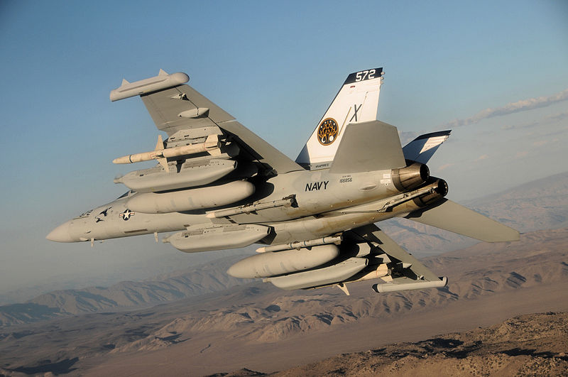

I like this one. EA-18G Growler
   / Hypothetical Doomsday Scenario #272
Yep, that is the replacement. My understanding is it is not a tail hook airplane, ie, no aircraft carrier capability. Lots of PERDIEM for squadron folks traveling arround the world. Folks living near OLF Coupeville should be happy, no more FCLP's
mark
I thought they went carrier ready last year some time. The image shown also has a tailhook.
   / Hypothetical Doomsday Scenario #275
mark
Airborne Electronic Attack Squadron (VAQ) 130, the Zappers, landed its squadron’s first operational EA-18G Growler on the aircraft carrier USS Harry S. Truman (CVN 75), July 18.
The Growler, a variant of the F/A-18F Super Hornet, replaced the EA-6B Prowler as the primary electronic warfare strike aircraft for Carrier Air Wing (CVW) 3.
