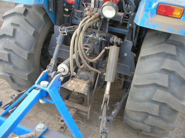

I was wanting to put a hyd. cylinder where my adj. link is on my TN75. Not the top link just the side. Does anyone know what size cylinder I need? Maybe a link to one for sale?

I have an 3" diameter x 8" stroke on my 7520 Mahindra. Your TN75 should be about the same size machine. CCM might be able to help you out or just do a search on Google for one. eBay maybe? I would think that either an 8" or 6" stroke is what would work best.
Good luck

Brian has a good sized cylinder on his Mahindra and I also used big ones on mine. My tractor isn't quite as big as either of yours, but I decided to use 3-1/2" diameter cylinders with 1-3/4" shafts. I had bent one of the stock turnbuckles which was 1-1/8" diameter. So I opted for larger rods. I bought these from Surplus Center who advertises on this board.
I also put them on both sides.
Here is a link to their installation if it will help you.
Adding Hydraulic Side Links
