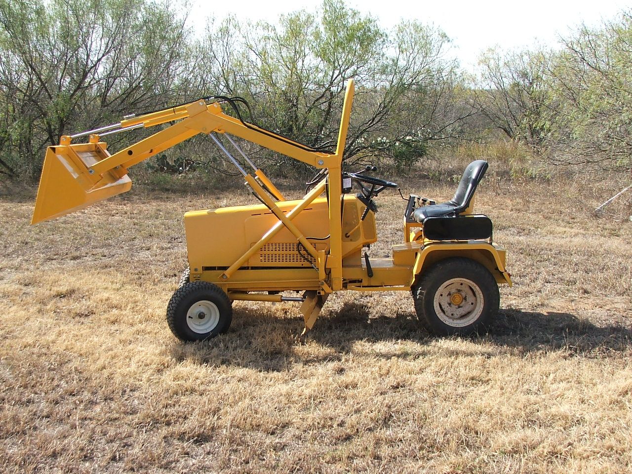

The Kenbota has been in service for about 11 years. It spends its life outside 24/7/365 and shows the wrath of the South Texas sun. It's now a cream color and all the hydraulic lines show extreme aging and cracking. The roll hoses on top have some areas of missing rubber covering from hauling tree branches. I even made a new seat cover for it a couple of months ago. I wish I would had covered the hoses when I put it together but got in a rush. It's due for some updates/mods but I intend to cover the hoses this time.

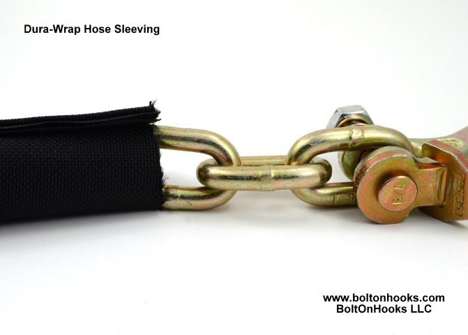

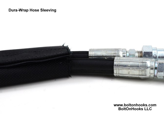

Some various "solutions:"
Hydraulic Hose Sleeves - Hydraulic Hoses and Fittings - Grainger Industrial Supply
MegaTuff(R) Cover For Hydraulic Hose Protection | Gates Corporation
LifeGuard™ Sleeving For Hydraulic Systems | Gates Corporation
