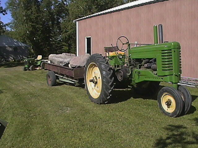

I am looking for a small dump wagon for a 29hp compact tractor I am purchasing- I plan to have rear hydrolics for the hook up. Anyone have any recommendations?

I suggest you consider a "dual power" wagon. I had one built that had the standard battery powered pump to run the hydraulic cylinder and a valve that allows the tractor's hydraulics to run the cylinder. If you'll be using a hydro tractor, make sure the the hydraulic fluid in the trailer's system uses the same fluid as the tractor.
With a dual system the trailer can be used behind a truck or other tow vehicle. Most of the trailer builders should be able to furnish what you want. Appalachian in Ohio is one that will build anything you spec.
/ Hydrolic dump wagon #4
A wood bed will be destroyed quick if you plan on dumping rocks with it. A new steel dump trailer starts around $3K. Look at auctions, I picked this one up for $800. 5x9 have dumped 3+ yards of heaping clay per trip.
