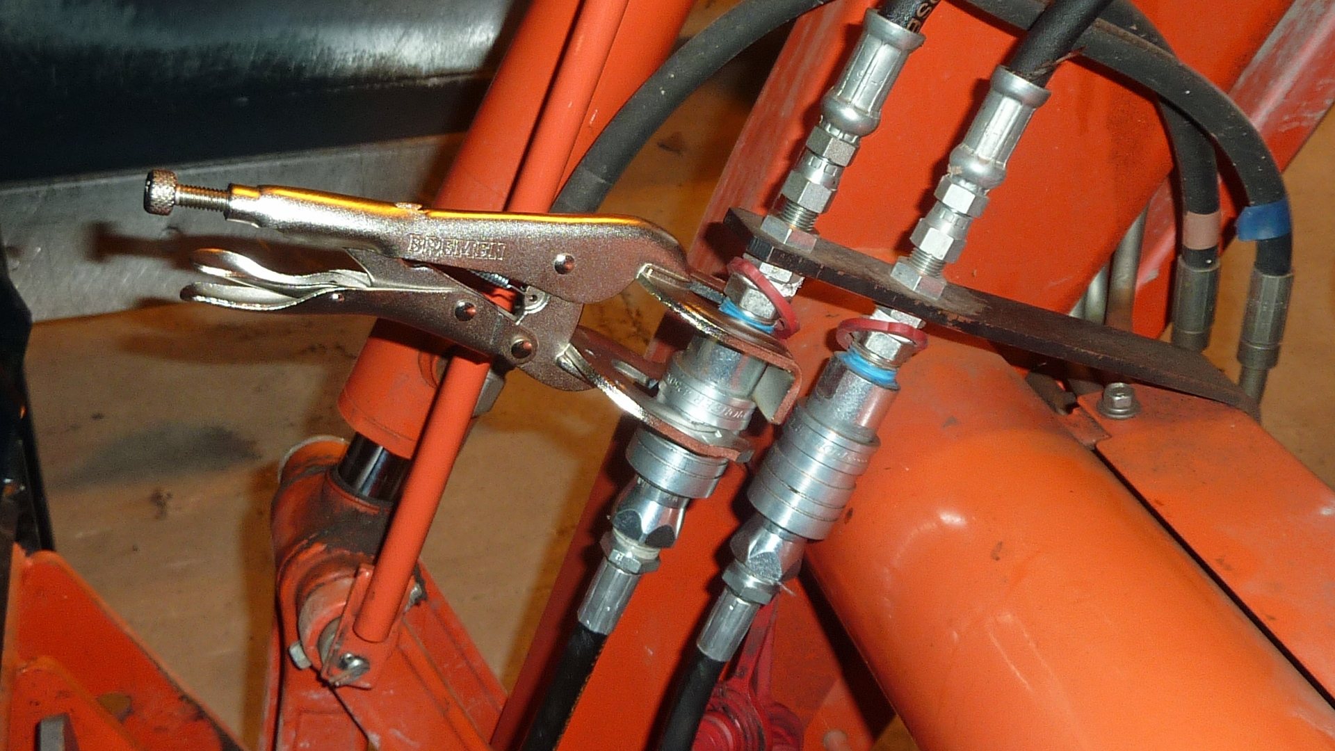

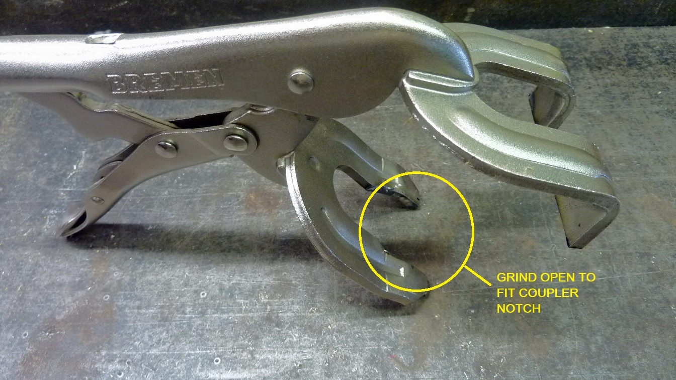

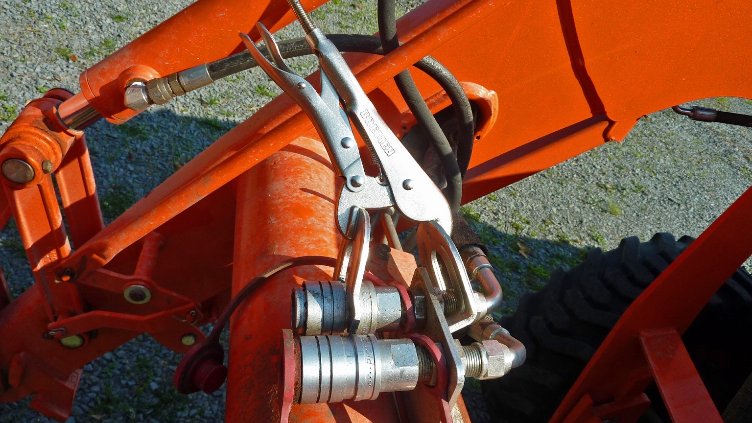

Why spend $90 when you can make your own tool from one of these for $12:
View attachment 857653 View attachment 857652
Open up the jaws with an angle grinder to fit the notch in the coupler body. Takes 5 minutes.

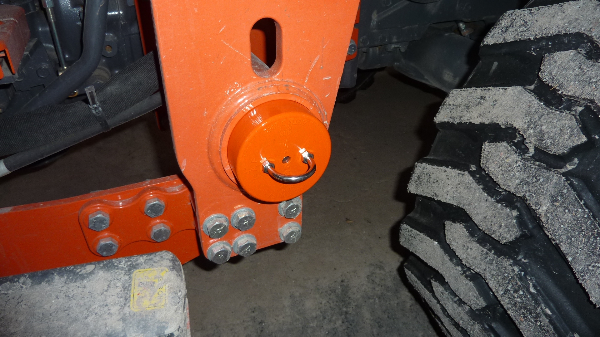

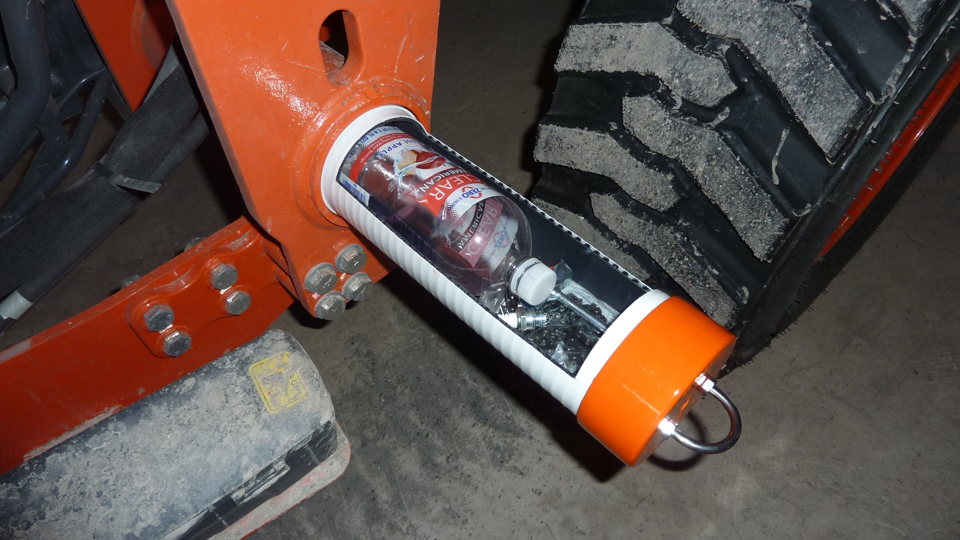

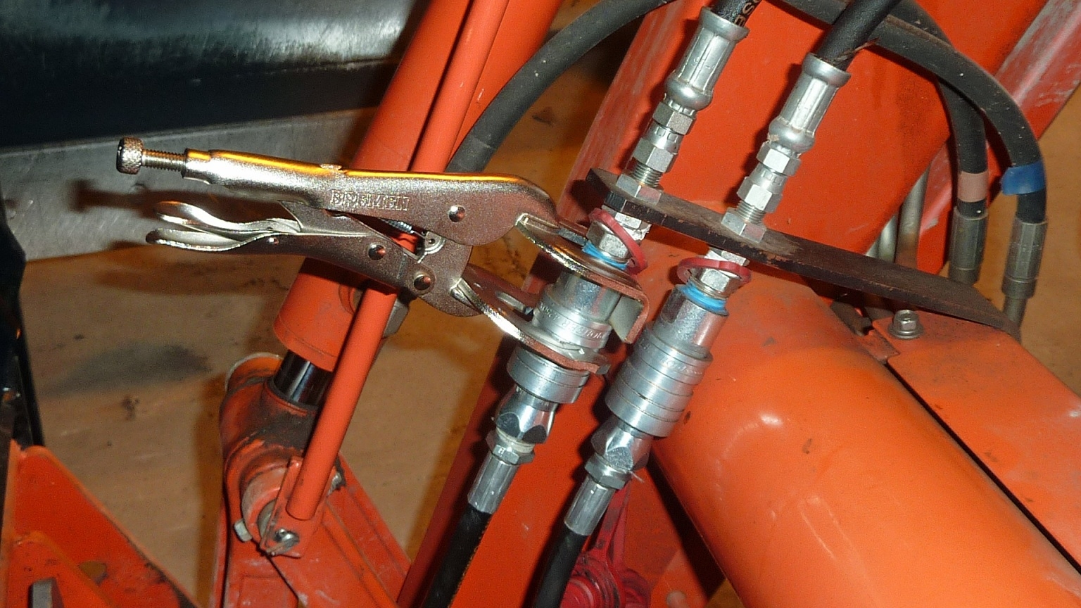

I use this tool and it stays on the tractor.
I carry it in one of these so it's always handy:
