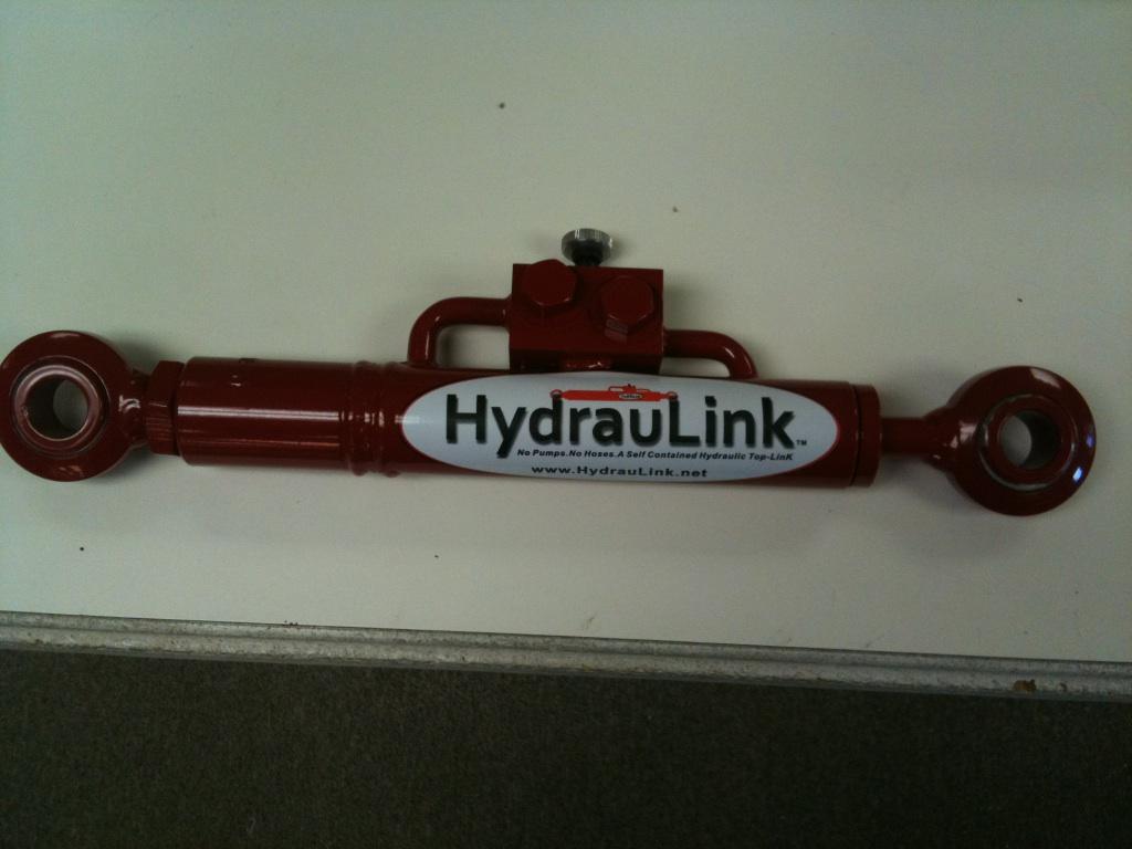

I've always had more time than money, but every now and then my laziness kicks in and I'll purchase something to make the process quicker, easier or both. That's how I ended up with my Pat's Quick Change and I don't regret it. Since I have the lift arms covered I began pondering the top link. I don't think I would ever put down the money to add rear hydraulics and a hydraulic top link, but I stumbled across this item that I believe could make life easier economically. Has anyone ever used the the Hydraulink ? I'm looking at using it mainly with my rear blade. How rugged is it, and is it as easy to use as advertised?

I have also looked at this-online- and looks pretty neat. I just wonder how you get a bush hog adjusted up? With a box blade with forks down I can see it tipping forward but a cutter that doesnt stick in the ground? I dont see how it will tip the back of the cutter up? Same with a tiller it will roll if you try and drag it so it will not tip forward? I hope someone jumps in that has one...

Ok, check my thought process here. On a rotary cutter, the front to rear height alignment is handled by the rear wheel adjustment. The 3pt only raises and lowers the entire deck at the same ratio. There is no toplink adjustment required once the deck is leveled. The Hydraulink will add some play in the connection due to it's piston play, but the deck pitch should not change. There already similar play on a standard top link when the rotating hitch collar is attached, this would just increase that play slightly I would think. In a ground engaging implement, top link pitch adjustment becomes important, but not so much on a mower.

True- but I need to rasie the back of the cutter to load on the trailer so how would you do that? cant drop it and release value and move forward? I guess drop back tire of the cutter on the trailer while the value is released then close and drive away? I still like it and would like to chat with someone that has one... About to buy pat's system for my fathers day :laughing: So this might have to wait-- do you like your quick system?? Pats seems to get everyones vote around here..

Interesting product, but I love the full adjustment of my hydraulic top link... Makes my attachments more useful with on the go adjustments in angles etc!!! If you think you need it, then go the full hydraulic route...
/ Hydraulink Top Link #8
It does look like it fits nicely between a conventional screw top link and full hydraulic link.
I might have given one a try, but they do not have one that will fit a BX :( Will most likely be ordering the rear hydraulic kit and a hydraulic top link instead.

Sorry for the delay. I know it can be frustrating but we want to get it right the first time... no mistakes. Our cat 0 series prototypes are on the way to us now. After some solid field testing, we'll be placing an order for late summer/ early fall delivery. We certainly want your business but we don't want to rush things too much and give you an inferior product.
One of the comments we've heard over and over from our customers is that they appreciate the heavy, quality design that HydrauLink has. We want that to continue into our cat 0 series as well.
For anyone that might be interested, send an email to sales@hydraulink.net to be put on the category 0 waiting list. You'll be among the first ones to get it when it comes out.
NOTE: Technically, it's not a category 0 unit...it's somewhere in-between a cat 0 and a cat 1. But it is designed to fit on the BX series and similar tractors.

So here's a question that I have not run across before. If I am going to add the Pat's quick attach, which extend out the mounting points a couple of inches, would I use the current Cat 1 Hydraulink or the forth coming one specifically for BXs?

They just started offering a screw end for the tractor side of the Hydraulink which provides up to 4" of additional length. Hopefully, the BX version will have the same option. But it remains to be seen what the min and max lengths will be for the SCUT version.
/ Hydraulink Top Link #12
I should have this information soon... a week or two. However, if you have a SCUT with a quick hitch of some kind, you should take a serious look at the category I unit with sleeves for the connections. That should give you all the reach you'll need. Just a thought...

We just got our new prototype in for the SCUT tractors... TBN-ers are the first ones to get a look at it. Sorry the picture quality isn't as good as usual. We're going to put it to the test soon.

Quick followup to my question about which Hydraulink to use on a BX with the Pat's Easy Change. Spoke with Pat's this morning when I placed my PEC order and they said that the standard Cat 1 Hydraulink is the one to use on a BX with the PEC hitch.

Interesting. So if I get the SCUT version for my BX, I won't be able to use the PATs easy hitch. No real plans to buy a PATs now, but I guess that's something to be aware of when/if I buy a SCUT Hydraulink. Of course if they offer the optional 4" screw for the tractor side, maybe it wouldn't matter. I guess I need more info on the Hydraulink SCUT version.

Extended screws for the cat 0 have not been discussed. Obviously thought, if the demand arises, we'll make one. We are getting measurements now for the SCUT version. I hope to have them for you in a little while.
