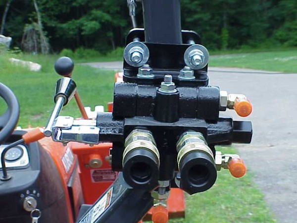

</font><font color="blue" class="small">( I'm not familiar with the term "rear auxiliary". Maybe someone else will jump in and help me out. )</font>
"Rear auxiliary" or "rear remote" on my Kubota is to operate hydraulically operated rear implements. In the case of my BX22, this is </font><font color="blue" class="small">( a singe remote valve that is designed as a sectional/ stackable valve allowing for expansion if required. It is available as an detent valve section or a float valve section. The valve kit requires a hose kit to complete the installation. The valve uses the tractor hydraulics to operate optional implements. The Maximum flow rate available at the remote is 3.7 gallons per minute (gpm).)</font>..... From Kubota Product Information Bulletin PIB-2003-019 Dated:06/09/2003... Hope that this helps and is the information that you are looking for.... Junk...
