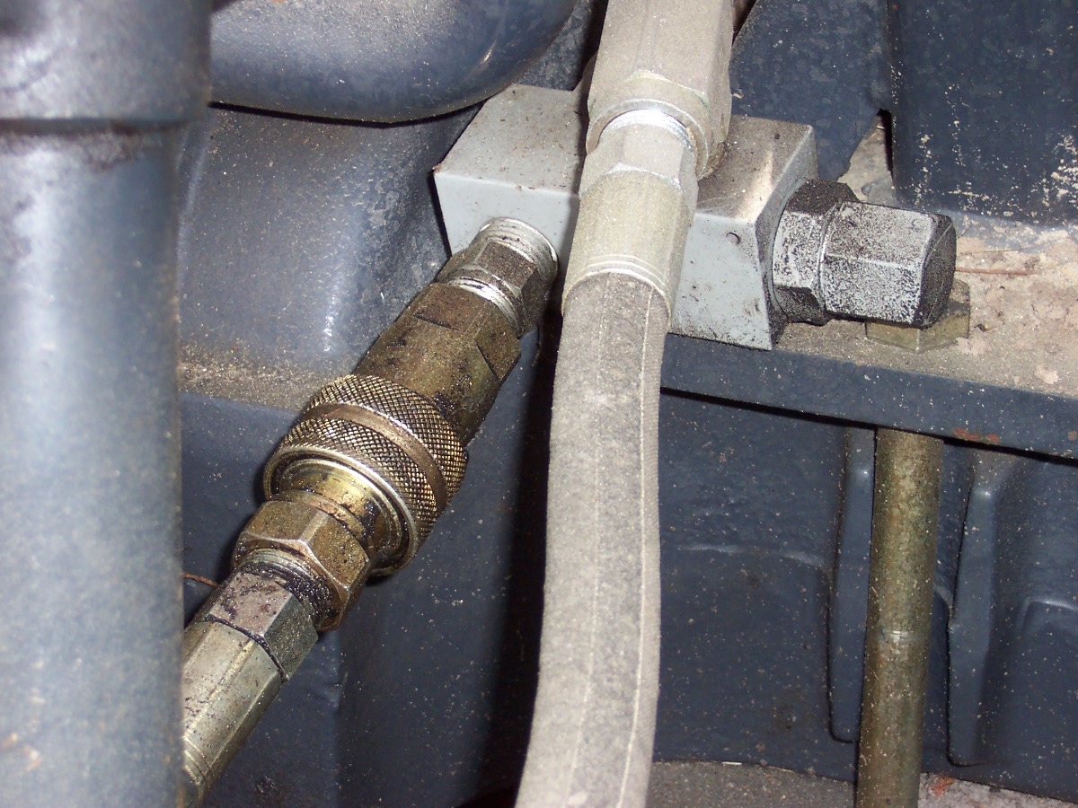

I hooked up the rear hydraulics myself on my 3510. I put a pressure relief valve in for safety because I have a Jinma Hoe and I didn't want to trust it for pressure relief. Nothing worse than dead heading hydraulics!
Nice addition!
