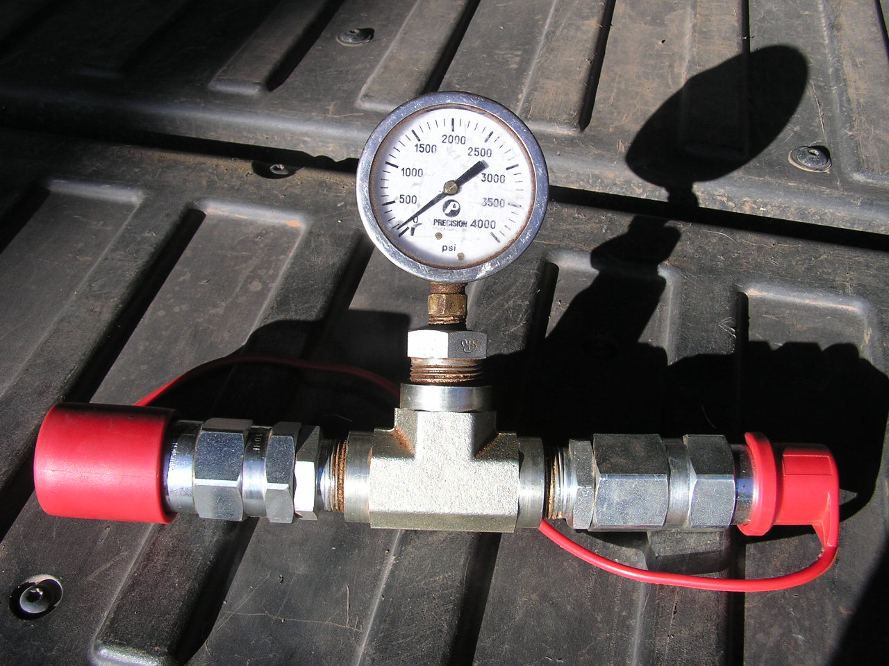

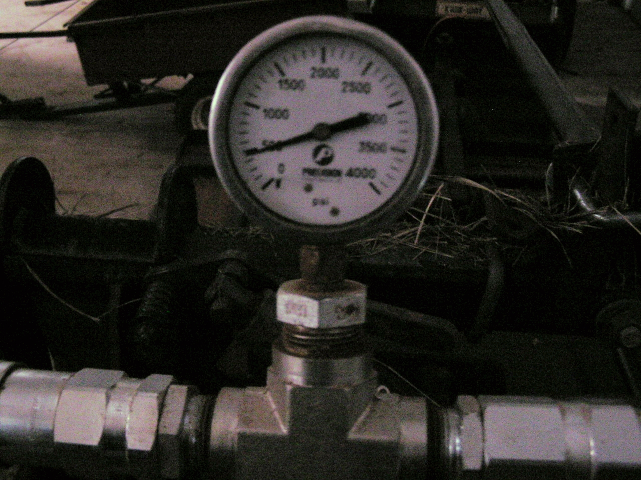

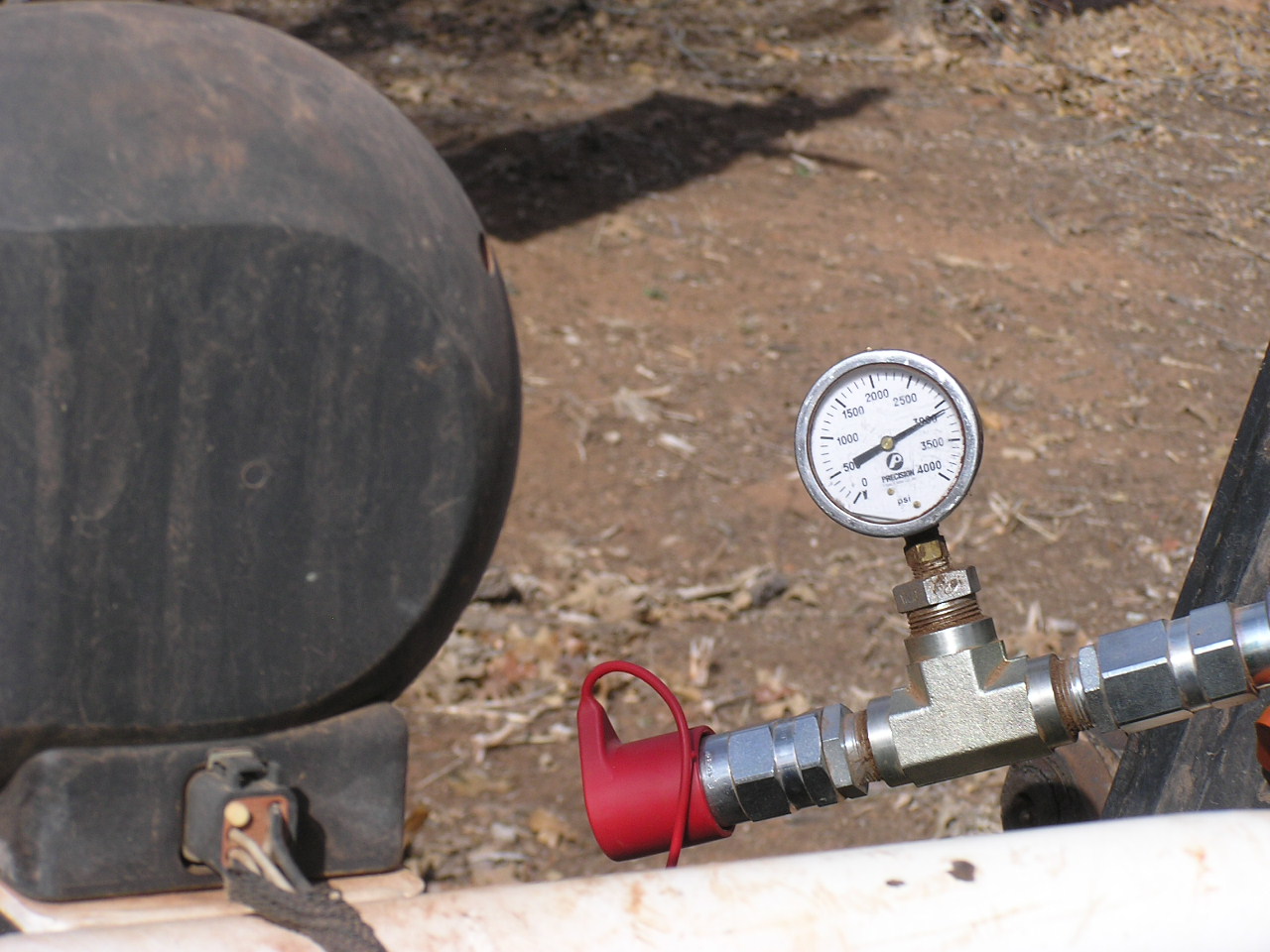

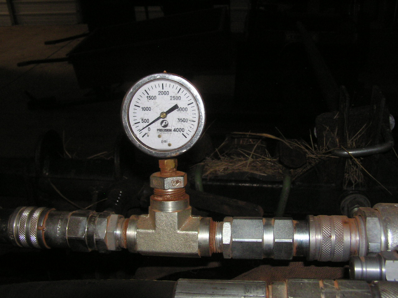

If you put a pressure gauge on a tee, plugged into the P connector on the loader, you can see if the relief valve is opening.
This is mine with flat face connectors to match my machines:
Plugged inline to show operating pressure:
