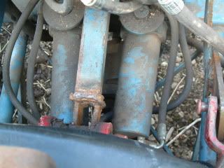

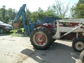

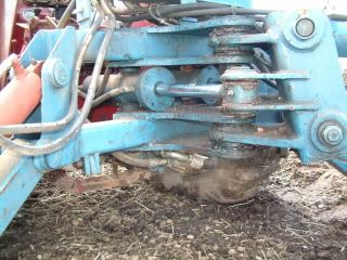

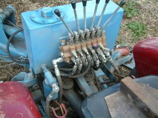

These are some pics of our backhoe attachment. The PTO powers the pump. There aren't many hours on this unit. My son was extending the hoe and heard a "clicking" sound. He says medium loud. It lasted about 30 seconds and then we couldn't use any of the hydraulic functions for the hoe.
I am a decent backyard mechanic but lost on hydraulics. i checked the resevor and added fluid. Hard to tell if it's that low since most cylinders are exteneded out. I hear no noise at all when he moves any/all of the levers back and forth. No obvious leaks or blow outs anywhere.
So now the tractor sits out in the rain and we can't move a thing. Any suggestions on where to start, or how I can get these cylinders retracted so we can move this into the shop to work on?
where and how do I begin to trouble shoot?

Start at the pump...Is it turning? Is there a shear pin between it and the PTO coupler? Is the PTO on the tractor working?
Edit:
You can retract the cylinders by operating the appropriate control and lifting the arms or outriggers with a hoist, the releasing the control.

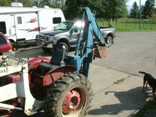

there is no ROPS, here are a couple of pics in better times. maybe I could use the boom with a chain hoist, OR...the winch from my Rhino??

I agree Kennyd, start at the pump.....the clicking sound could be a bad pto shaft, keyway or hyd pump shaft (snapped internally)
Hard to tell from the pics but is it a Vickers V20 vane pump..??
