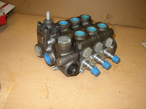

I have a 3 spool Hyd Valve and it has 3/4 inch threads on the inlet side and on the outlet side there is an Aluminum fitting that is tapped in the middle for a 3/4 inch return line. There is a plug on the top of the valve for another return line. This is a Gressan valve and has F 20 stamped next to the outlet. The aluminum plug seats tight against the outlet from the spool on the inside of the valve body. Can the 2nd line on the outlet be plugged so that I can use this as a normal valve. Thanks Ivan
   / Hydraulic valve #2
How about a picture of the valve?
The other ports could be a second return port or a PB port or an unloader port.
Does it look anything like this?
