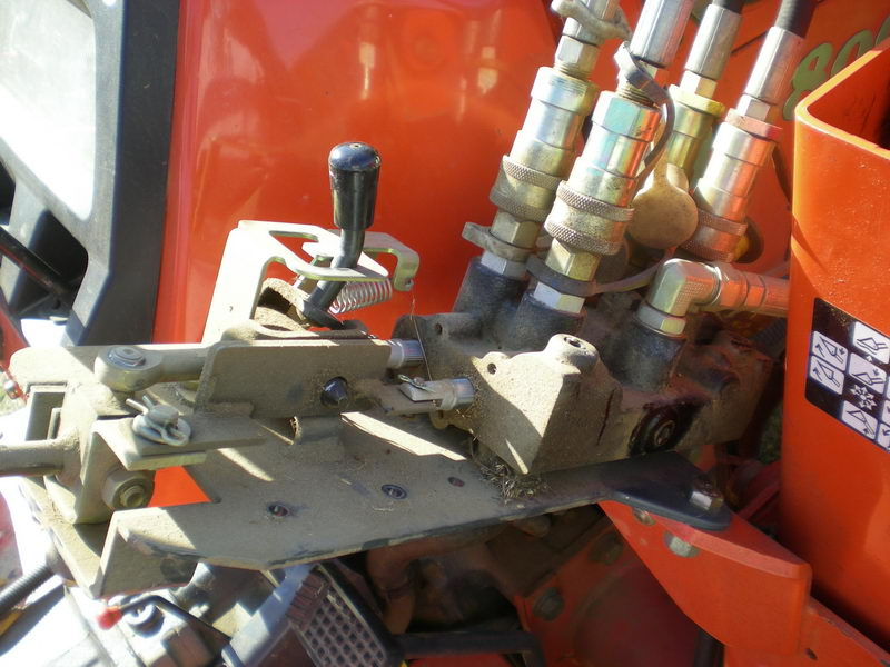

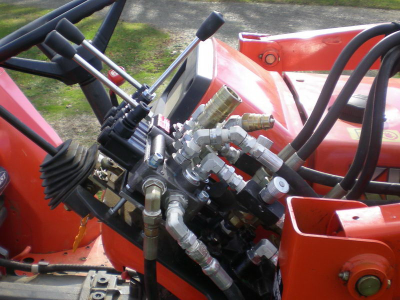

I used hoses that had 3/8 NPT but I tied in Parker needle valves for the top and side links. Allows for precise control. Grapple just needs open / close.
I used a bunch of 45* and 90* adapters that could have been built right on the hydraulic hoses. Discount Hydraulic hoses, I would call them once you know what ends you need and have the valve mounted so you can meeasure it correctly. Use a water hose to route your lines to where you need them, and measure the hoses.

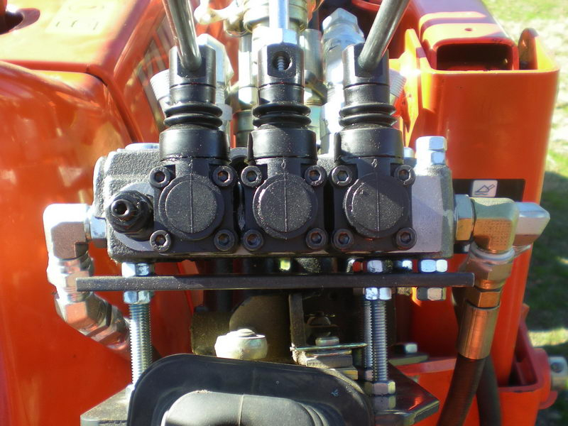

For the record, I mounted my valve right on top of the FEL control. I did that since I could just move lines from the FEL to the new valve and buy one hose to connect the two together.

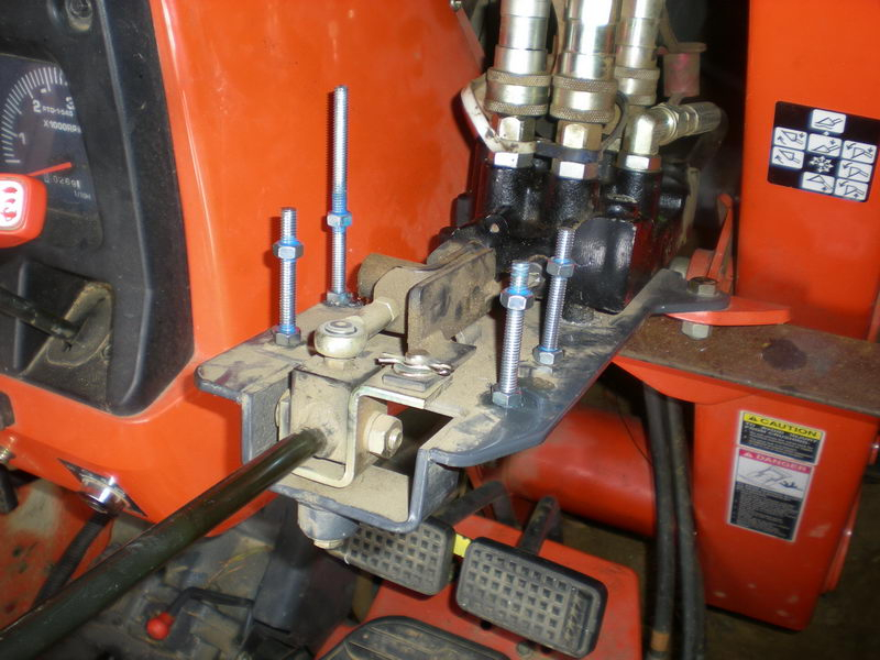

I used flat 1/4" stock with threaded rod to make a place to mount the new valve (one threaded rod went through the new spool, the 1/4" stock which continued into the original hole the the plastic cover for the FEL was held on to.
I removed the power beyond from the FEL, screwed it in to the new valve, bought a hose to loop from the FEL power beyond and screwed it into the new valve's IN port (power in). Then since the two return to tanks were so close, I used a "T" adapter to connect the two together.
It's a real birds nest but it's totally out of the way.

Also found more photos.... again not sure what might have changed over the years for the Standard L's FEL.
