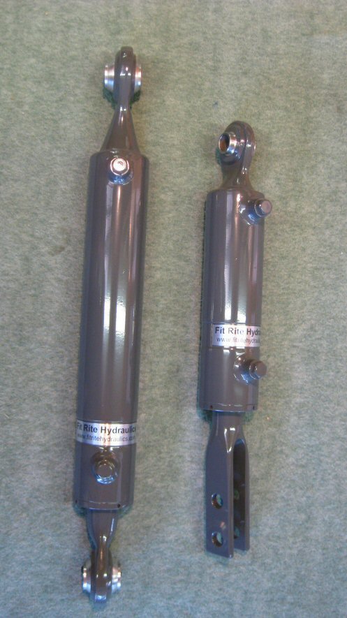

Just got my brand new MX5400 and want to get a hydraulic toplink. The dealer says I have 2 options. One that travels from 21-29 inches and one that travels from 26-34 inches. I have no idea what the pros cons are to each. Any input?
I use a rotary cutter, blade, box blade, tiller, and a disc.

My link has a 21-31" in length on my MX. I use a quick Hitch with an adapter link and it's seems to be perfect. I can lengthen it with the adapter if needed but haven't needed too yet. I think I would stay with the shorter one with a quick Hitch and the longer if not using a quick Hitch. The 31" would be too short .

Measure eye to eye on your current top link when it is at it's shortest (compressed) length and fully extended length and that is what you want to try and match.

Yup. Match the OEM manual link lengths, unless you or somebody else has a reason for doing something else.

Take a look at this link. Find something that is close to matching up to put the cylinder pin-pin distance to match when extended half way.
I typically provide a 2 1/2" dia cylinder with a 1 1/2" dia rod having a working length of 23 1/4"- 35 1/4".
Keep in mind that the base end uses a cat 1 (3/4") pin and is only 1 3/4" wide ball swivel and the rod end should have a narrow (1 3/4") cat 2 (1") end.
You will not find this anywhere but from me. But you might get close enough and with a few modifications get by and not have to wait almost 6 months.
