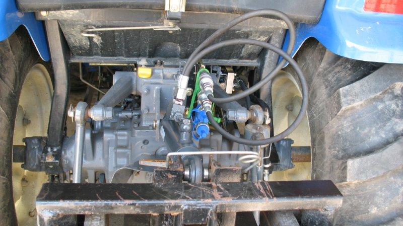

Still waiting on the new washers from Mark at CCM. Got a little frustrated with the wait so I removed the bango bolt one more time and coated all mating surfaces with Loctite 545, non-fouling, sealant. Let it sit overnight and tried actuating the HTL for a few minutes this morning. So far so good, no leaks. I bought the whole kit from CCM including hoses. The hoses came with straight NPT fittings that threaded into the DPOCV. At full up position on the 3 pt lever control the hoses are very close to the tang for the toplink hook. I suppose I could remove the tang to get more clearance or buy more fittings (angled). I opted to just clock the DPOCV to about 10 degrees off of 90 for the clearance. A simple fix for anyone else that is concerned.

I flipped mine 180 degree to get more clearance, and better hose movement than when they were out the top. Also added 90 degree elbows to make a better fit. Sticking straight up was a definite clearance problem for me. Here is pic using shorter lines too.
