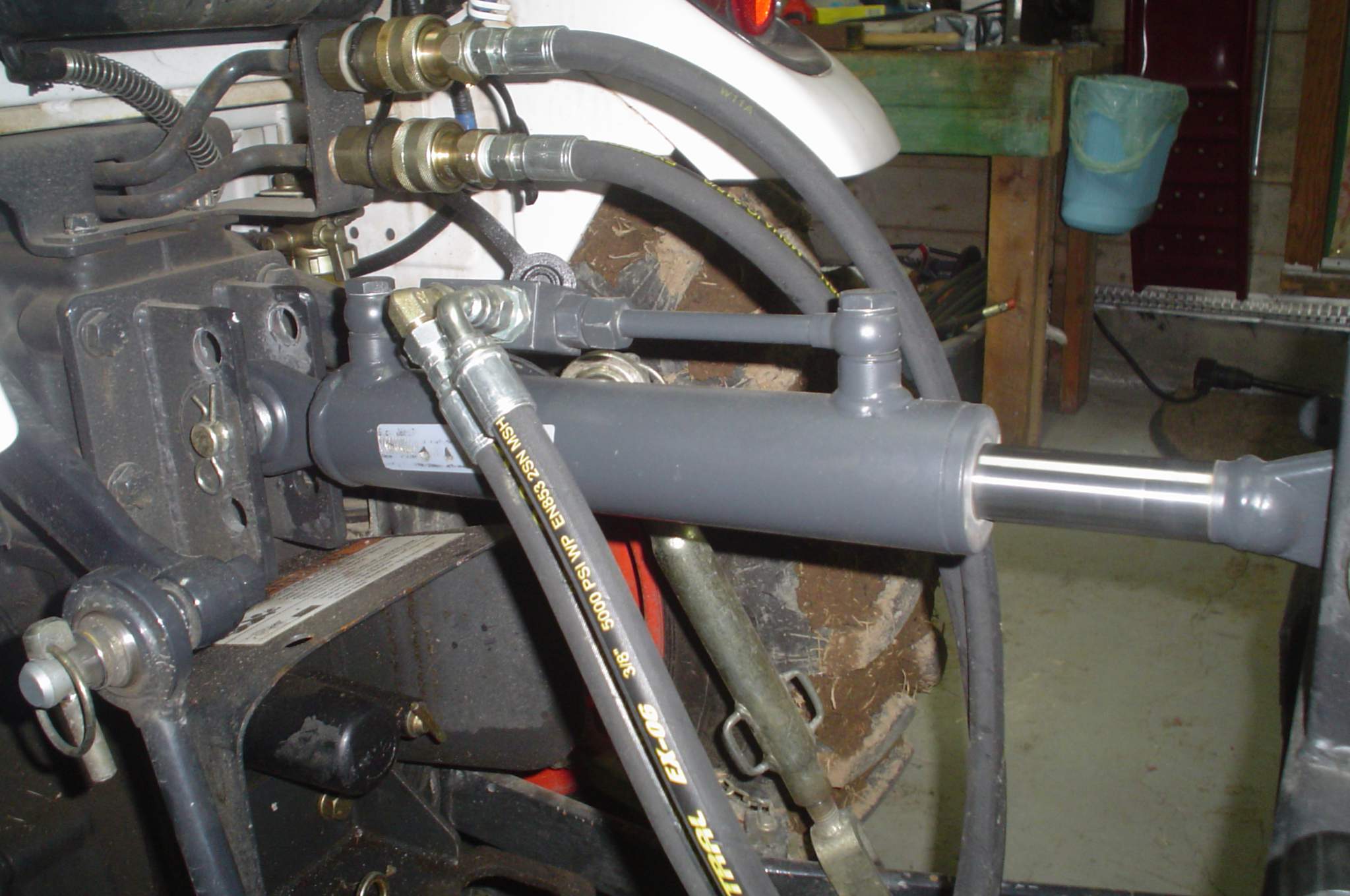

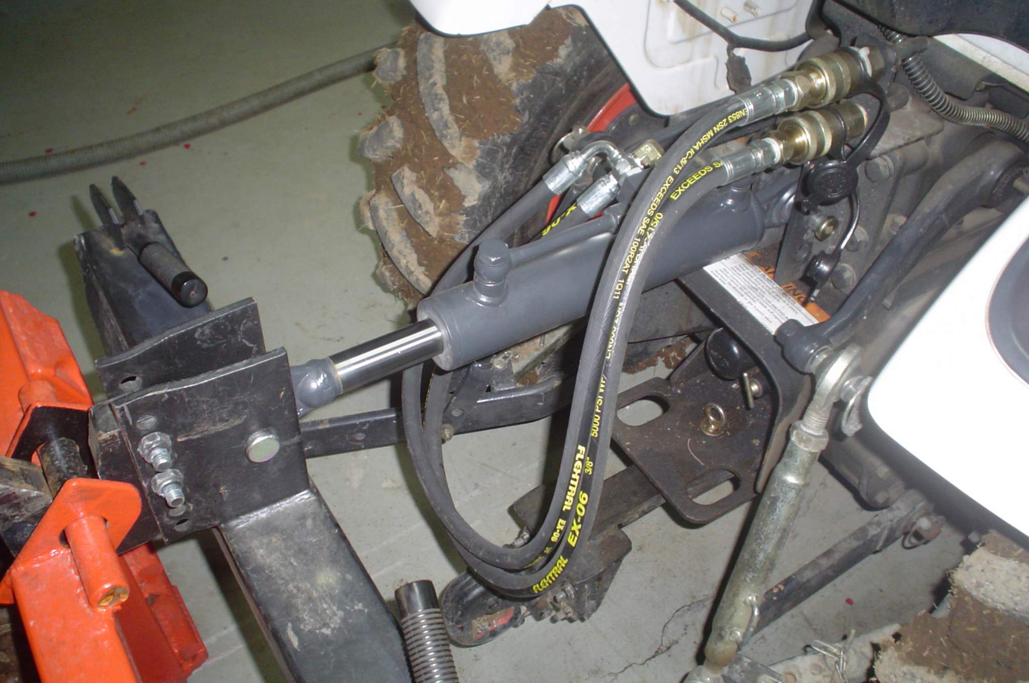

How do you run your hoses for your toplink? I cant seem to get a good configuration to set the hoses, it works one way but not the other. If you can pist how you have then that would be great, heres an old photo i currently run them under and back up to the couplers
I haven't had any issues running them this way.

That's the way Brian said to do them, Pointing towards the implement.

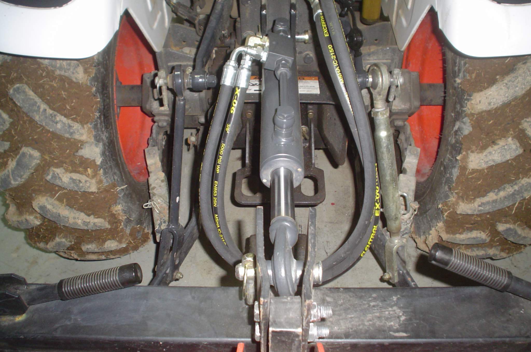

As mentioned above, smaller diameter hoses will put less stress on the fitting ends when it's bent double. Here's a pic of mine with 3/8" hoses. 18" and 30" hoses. That length would be dependant on what tractor you are using and the location of your remote couplers.
/ Hydraulic Toplink Hoses #17
Do you remove your hydraulic top link if using your PTO??
Sorry I took so long to answer. No I leave everything as is, even when using my tiller. Just take it off when mounting the backhoe. :cool2:
/ Hydraulic Toplink Hoses #18
No worries. From the pics it looks like the hoses would be laying on the PTO shaft. Just wondered how you prevented that. Thanks.
/ Hydraulic Toplink Hoses #19
My PTO shaft is inside of a plastic tube, so no rubbing issues.
