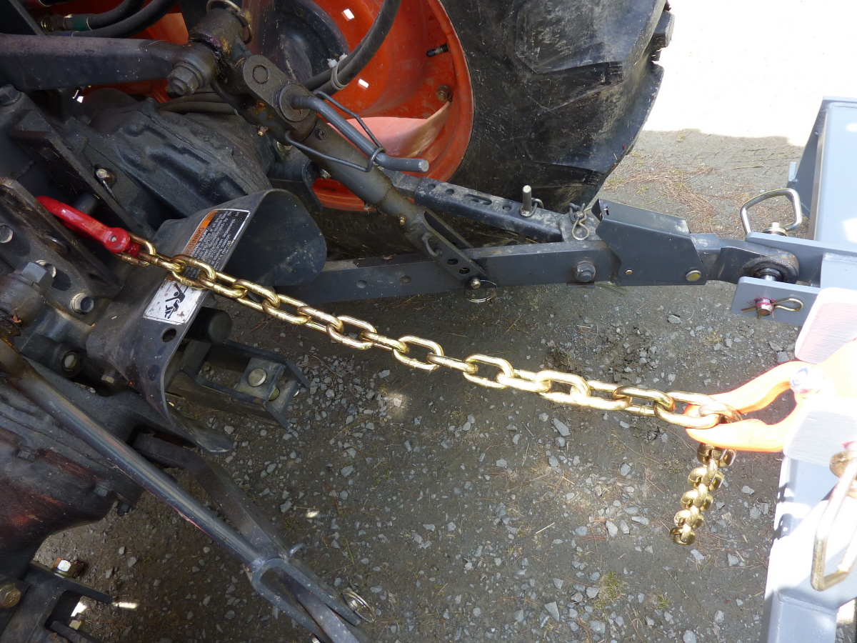

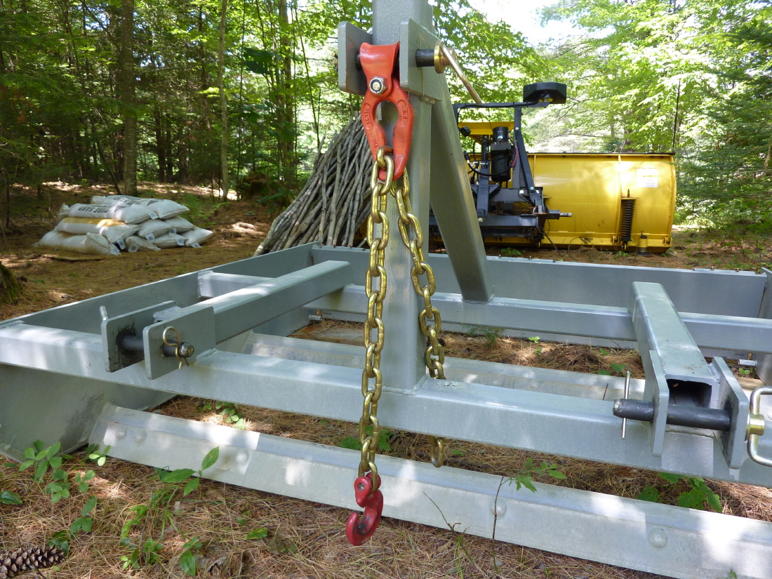

Just to clarify, you're saying attach the toplink to the BB with a short piece of chain instead of the standard hook-up. So I'm thinking that would allow the ANGLE of the BB to change, right? (the "angle of the dangle") But the HEIGHT would remain fixed because of being attached to the lower links. If this is correct, seems like an improvement....will have to try it to see.
Can anyone provide pics of this set-up? Would it work with a QH? Thanks.
A chain instead of a toplink, using a brush hog is common practice.
What mbu was trying to say was it will not work well on a box blade.
You will just have to try it and see if it works for your driveway.
Also be warned, without a fixed top link on a box blade, as soon as you try to drive forward, the top attachment point of the BB (where the top link connects) will rotate toward the tractor and smack into whatever is in the way possibly causing damage.
That will happen if the scarifiers are down and can be prevented by putting the chain through a short piece of pipe.
A heavy box blade might work with a chain for light leveling, there is only one way to find out.

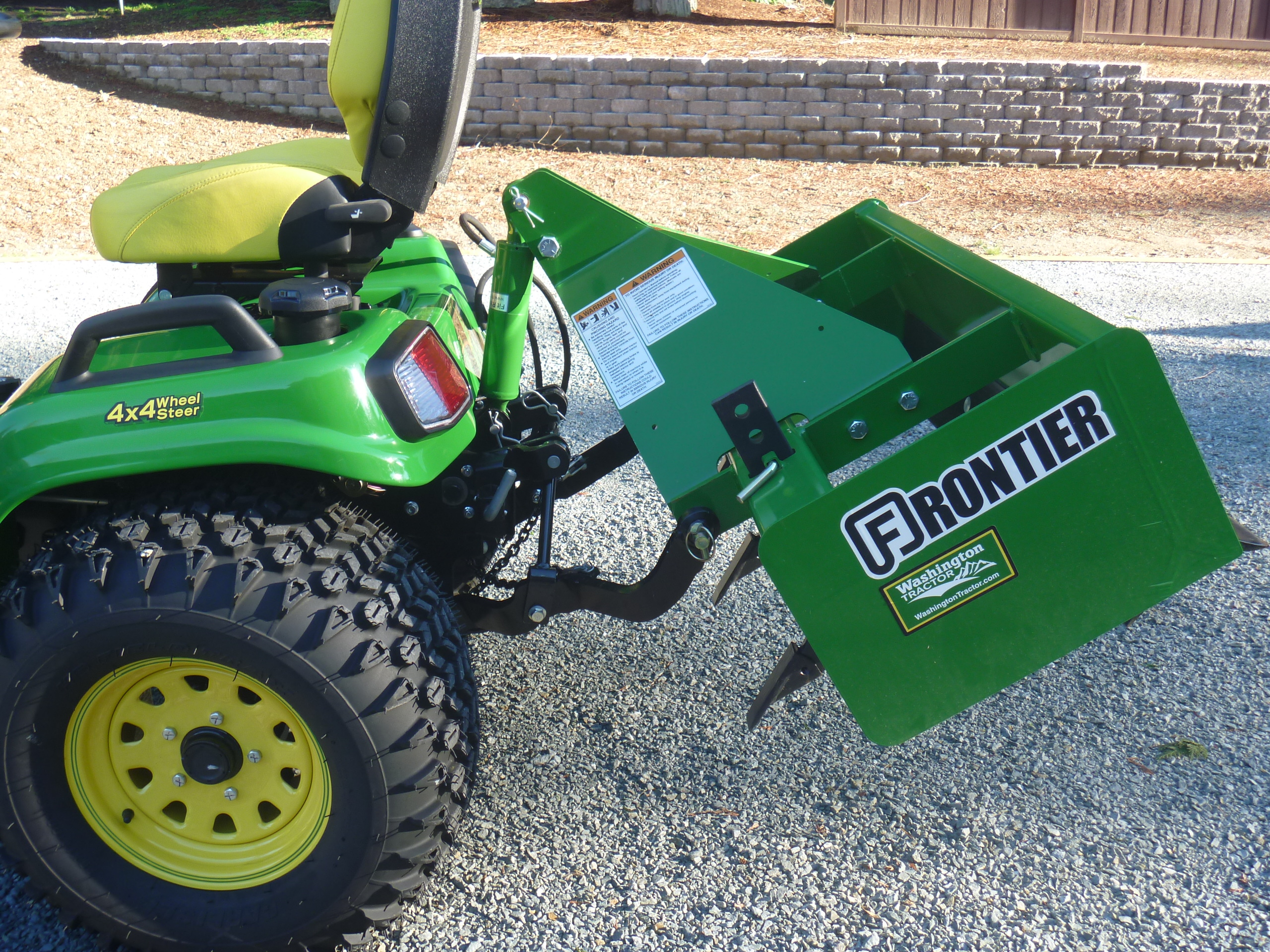

have read a lot of comments about hydraulic top links,seems like it would be a handy addition to smaller tractors,with the limited lift they have
It sure is handy! I have one on a garden tractor which has a Cat 1 limited lift 3pt hitch. Retracted it can get the box blade or landscape rake way off the ground for traversing dips and shallow ditches.

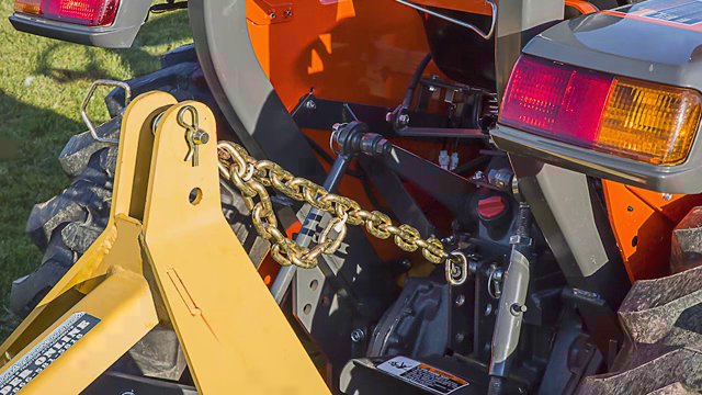

Speaking of a chain on a LPGS, Found Gordon Gould's setup on an image search:
