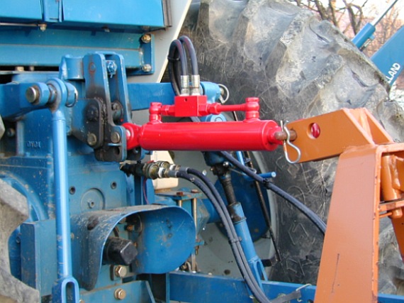

I got my HTL on Friday from CCI. Didn't instatll it till today, actually this early evening. Works well. I didn't get to use very much. Just played with it for about 1/2 hr with the rear blade. Hoses are a bit long but they came as a kit with the HTL. Better to long than to short. I'll have to see, right now they work well being as long as they are. I may make a bracket that hold them. One thing I like about the double pilot valves are that you can disconnect the HTL and the position is held with out having pressure on the couplers. That had never crossed my mind but seems to work well. The idea of being able to adjust the toplink on the fly was a reason for getting it. Another more important reason was that with large implements it is a real pain to adjust the toplink to get the implement level. Usually required adjusting the position control and then turning the toplink a few turns and then doing it again. Not any more /forums/images/graemlins/grin.gif...
Attached are some pictures.

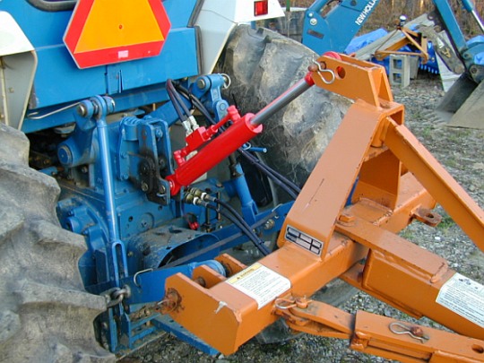

   / Hydraulic top link questions
#40
Another view.
