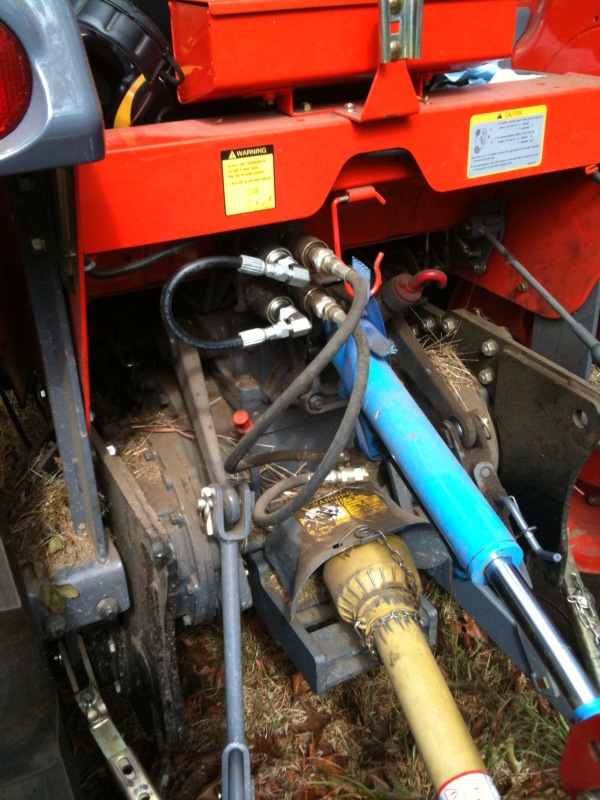

You know,, the top link in your pic does not need tractor hydraulics??
It is self contained! :thumbsup: ,,, just open and close the little valve.
What do you mean? I don't need to run hydraulic lines from my diverter? What open and closes the values to move the cylinder?

Most (?all) hydraulic top links are run from rear remotes and controlled by the levers in the operators station. Nothing to do with FEL controls or diverters.
See my hydraulic toplink connected to rear remotes in photo.

This sounds like a good addition to my tractor. How do I go about determining the length of the Hydraulic top link I need for my tractor. Do I measure my current top link fully retracted and fully extended and use those measurements.
Also I already have a third function on the rear of my tractor. Is that all I will need to work the hydraulic top link
This is what I recommend to determine what will work best. You need to figure that you need at a minimum of 3" of stroke in both directions. Typically I try to build units to have 1/2"-1" more retraction than extension, just helps out to be able to get the implement up that much higher when in rough ground or loading onto a trailer.
Yes your 3rd function will work to operate a hydraulic top link. :thumbsup:

1870 hours on this tractor,, nothing was ever connected to these ports,,,
and nothing was ever connected to the PTO,,, either,,, :confused2:
i am surprised the PO did not torch off the valve control lever,,
that would have made it easier to get on the tractor,,,
