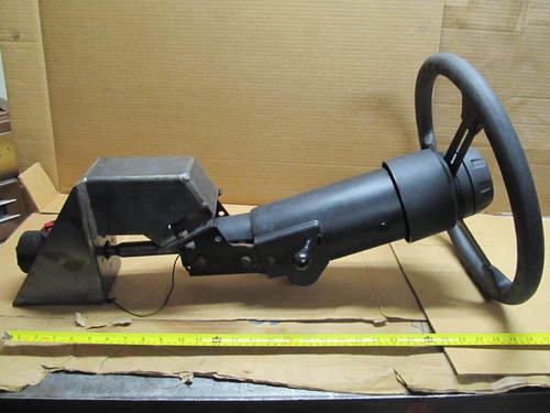

Would a person be crazy to not snag this unit?
(power beyond - 6.1 cubic in per revolution - 2000 psi - 5 gpm - $100)
Would really like to add power-steering to the Ford 1700 with loader (pressure relief set at 2000 psi and rated at 5.3 gpm per the Ford specs).
I suppose the steering valve has to be first in-line with power beyond feeding the loader valve (which also has power beyond).
Or can the loader valve be first to drop the flow to the steering valve?
Or should I pass on this one?
-Neil
   / hydraulic steering column #2
I think I would get it, If that is a char-lynn pump on the end, that sells for $300 to $500. Make it work after the fact or resell it.
