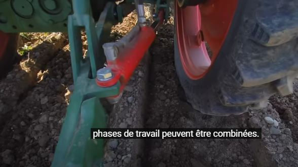

This is being used to hillside cultivate row crops. The 3PH is unique in its location between the front and rear wheels of the tractor as seen in this video:

The cultivator bar is where it should be as it is the easiest to see and make quick adjustments. Many belly bars on tractors through the years
   / Hydraulic Side Shift On 3PH
Yes and the Allis Chalmers Model G is a good example. The Fendt in the video looks like it utilizes a conventional 3PH just behind the front wheels for various attachments.
I can see some advantages of a cylinder operating at least one of the 3PH lower links particularly if the valve has a float option. Even the Quik-Hitch folks could make use of it for alignment when mounting an attachment.
