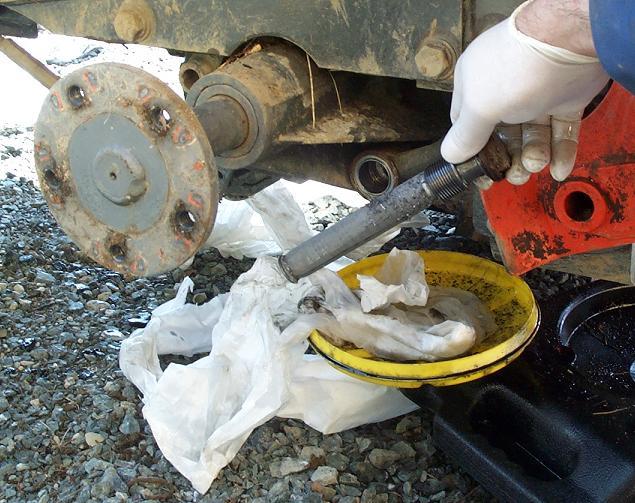

I have no knowledge of the mechanicals of your tractor but heres a pic of a similar screen from another model that was posted by another member, and a pdf of a page from the L4130 GST HST parts manual that I happen to have. Its part no 030. (I dont know if its applicable to your tractor). Most HST tractors have a screen each side but my quick perusal of the 560 page manual suggests there may be only ONE screen that services both the hydraulics AND the HST on the 4130HST, but I could be completely wrong about that. (A little knowledge is a dangerous thing eh.) But if that is the case, and your tractor is similar then a blocked screen is quite possible. Have you noticed the HST trans is lacking a little grunt lately too?

The screen just looks like a large bolt thats bolting an oil line to the side of the tranmission. But when you remove the bolt you'll see that its also a wire mesh filter. You'll have to drain the oil before you remove the bolt.

Z28gc222: I had a problem with my 2003 L3130HST a couple of years ago. I lost the use of the rear three point hitch-Happened the same time I did the 400 hour service. Thought I did something wrong. Turns out there is a screen in the rear hydraulics that came loose and got stuffed into a relief valve holding it open. Caused the three point to have no pressure. This screen is supposed to be located in between the trans housing and rear spool block.
If you are having a problem with just the rear three point hitch, I can tell you where to get to it. The seat pan needs to come off. This gets you to the top of the transmission. There is a spool valve block bolted to the top of the transmission. Unbolt this block carefully and put on a bench. I unscrewed the plugs on the block one at a time until I found the wadded up screen in the relief. Pulled screen out-carefully-it could be under spring pressure. Put everything back together, reinstalled, and everything works! Just be careful to keep track what you take out and put it back in the same place. On the advice of my dealer, I did not put the screen back in.
