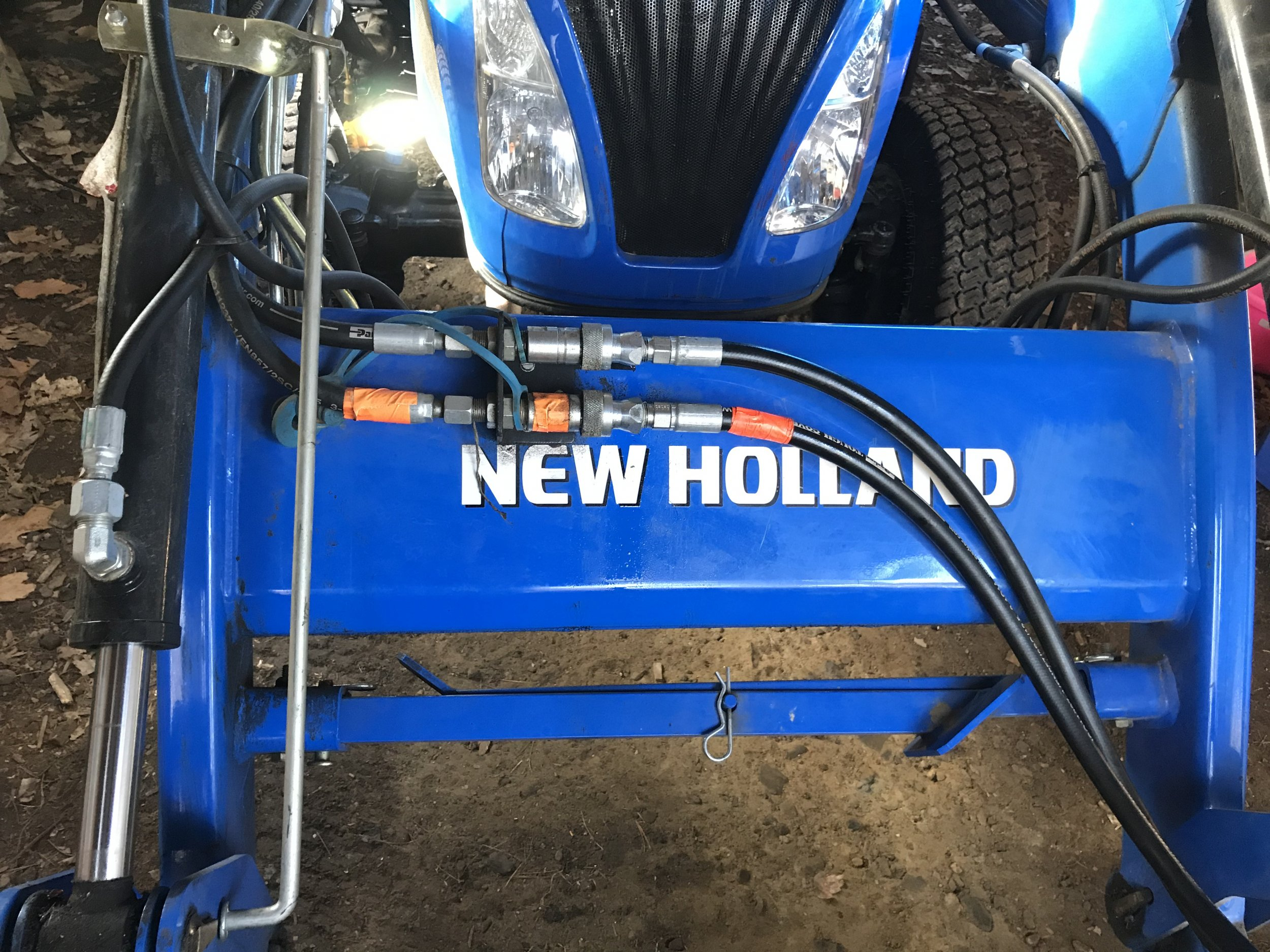

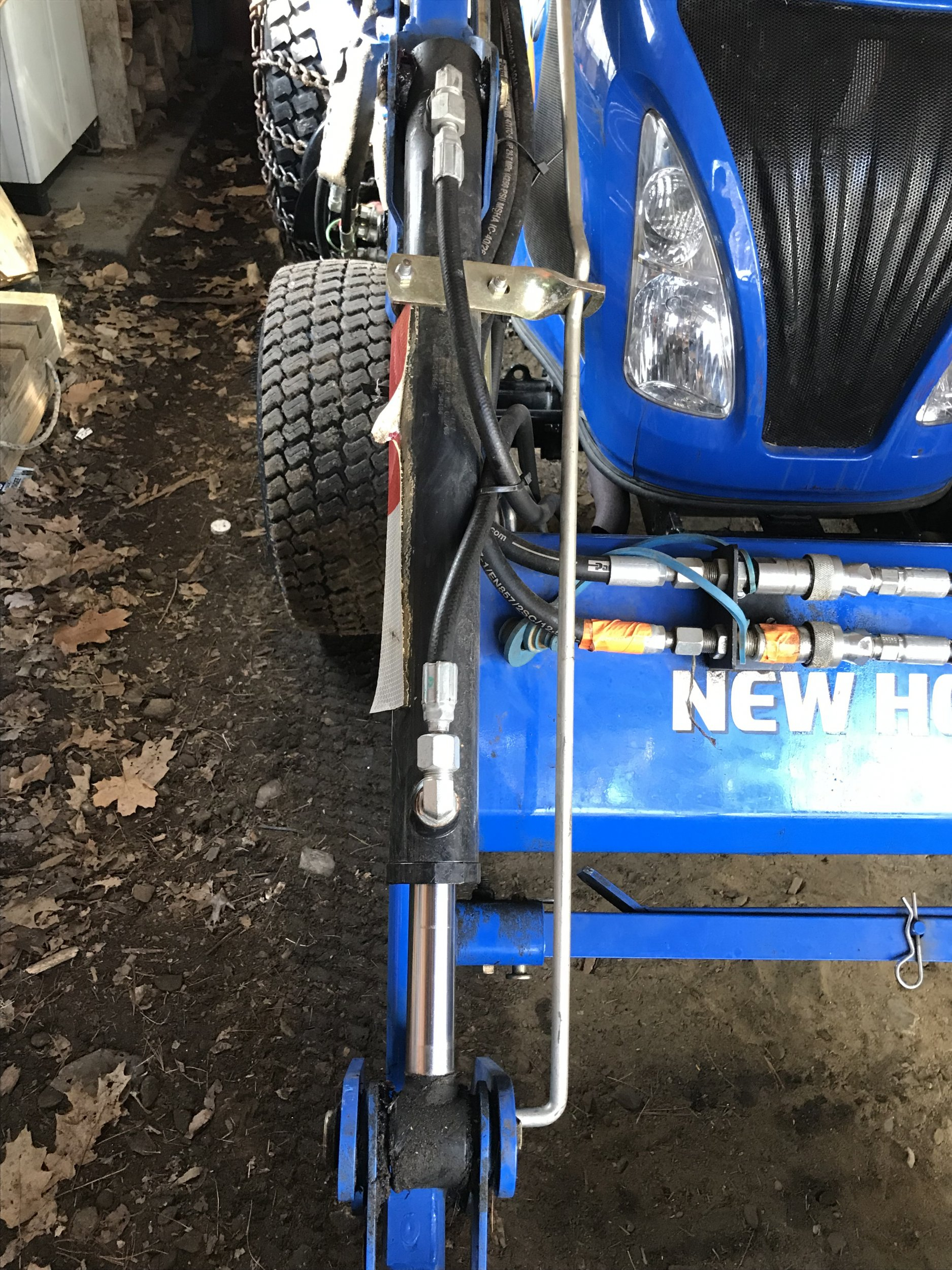

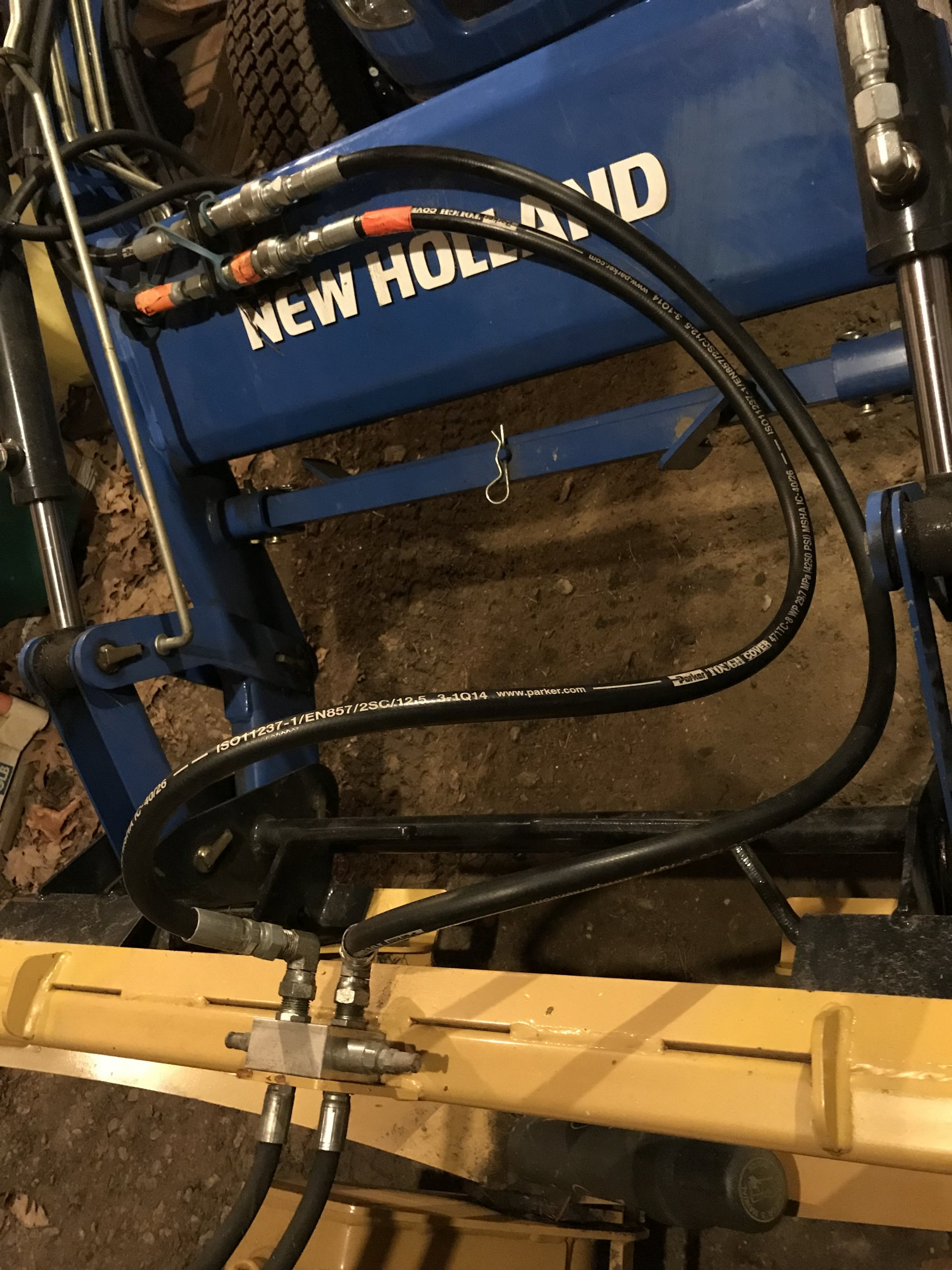

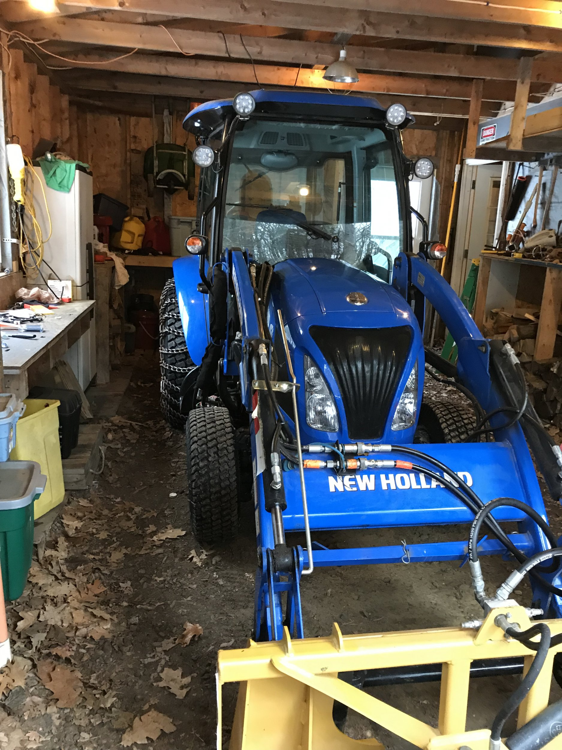

I ran my hoses from rear remotes to loader cross tube where I mounted a bracket to connect my grapple or snow plow. My hoses are about 48-50" long from bracket to implement. I drilled and screwed my bracket to large cross tube. Hope this helps.

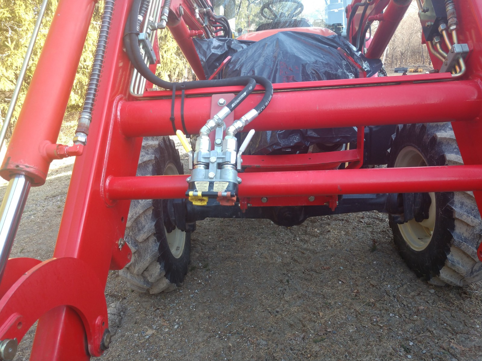

I had a nice Pioneer coupler on the shelf I hadn't used.

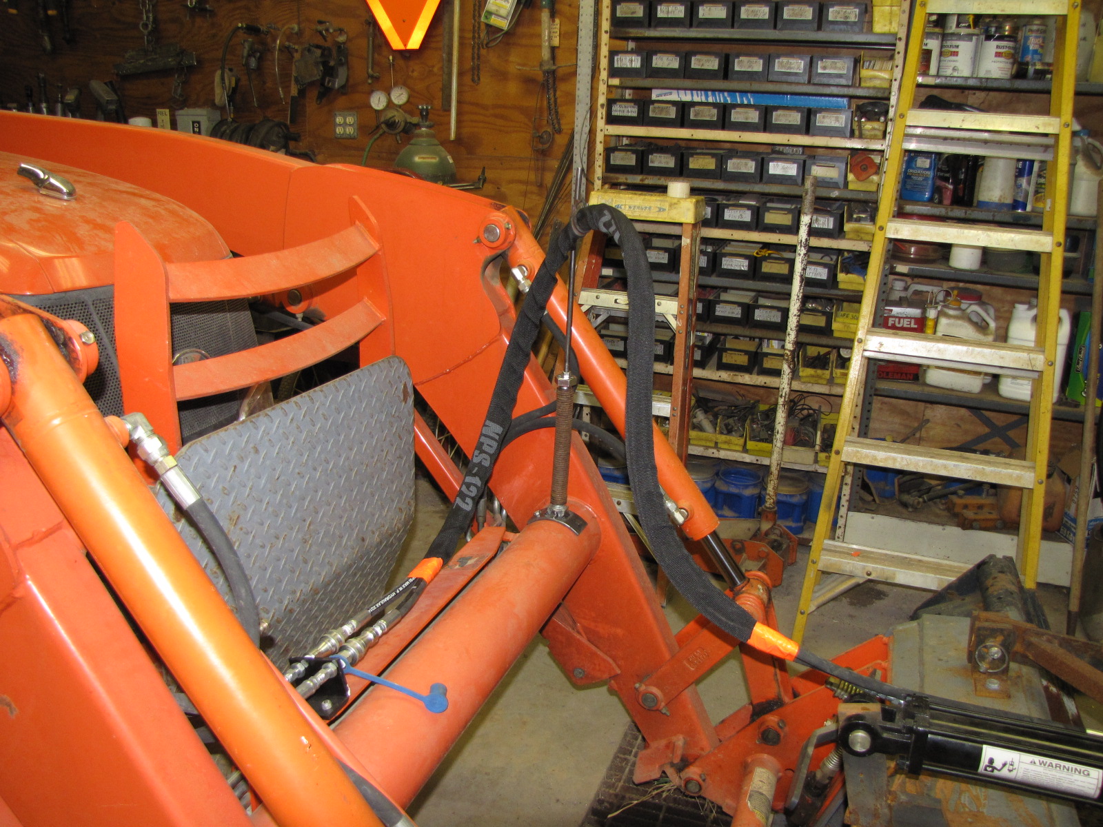

Ran 1/2” two wire hoses from rear remotes to front of FEL. Under, up the loader tower to the 3rd function cross tube. M5030. 12’ long. Welded two line hydraulic hose clamps (Surplus Center) along the way. Covered lines with protective nylon sleeve. Problem free for twenty year of rough grapple use.
