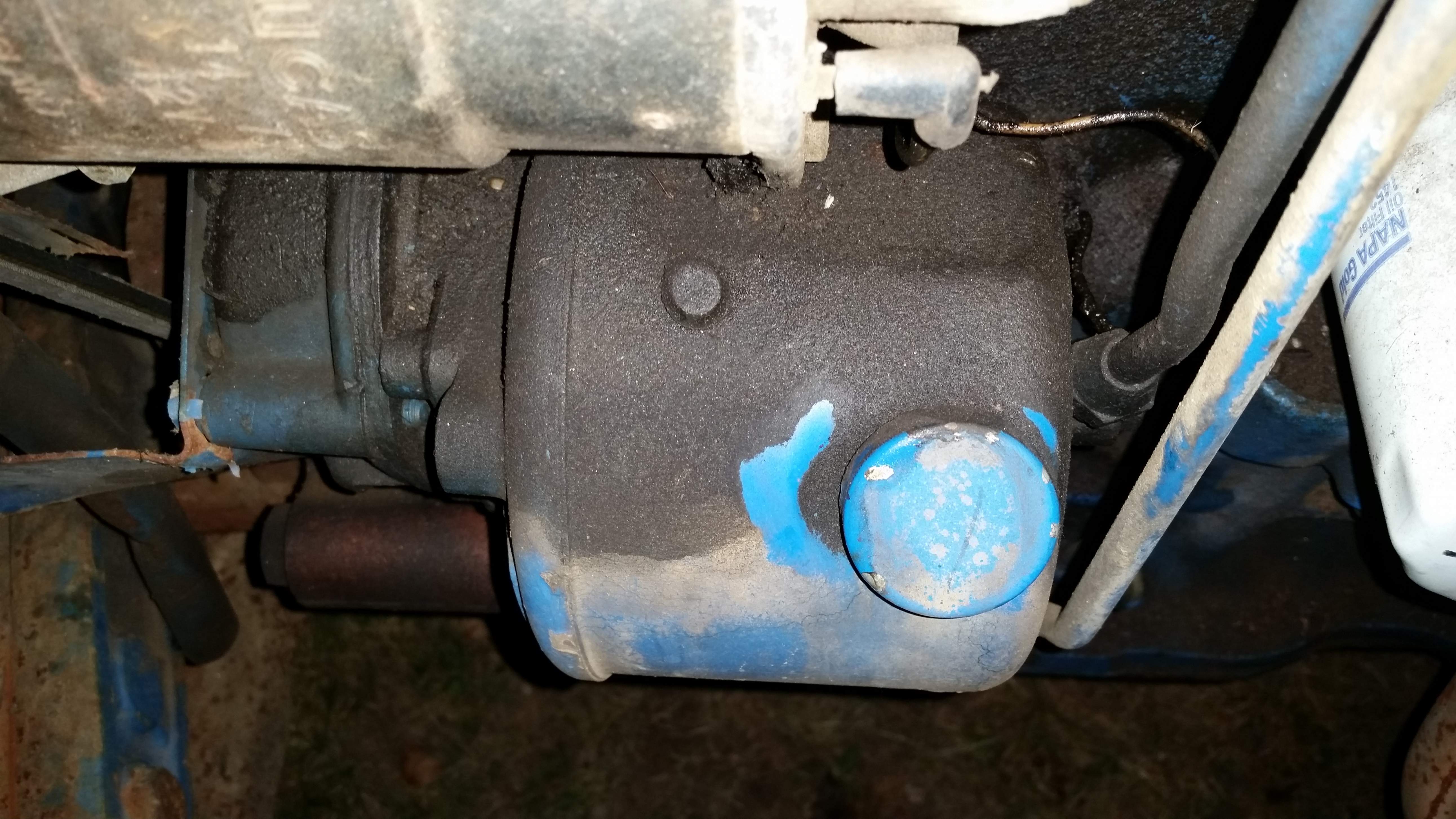

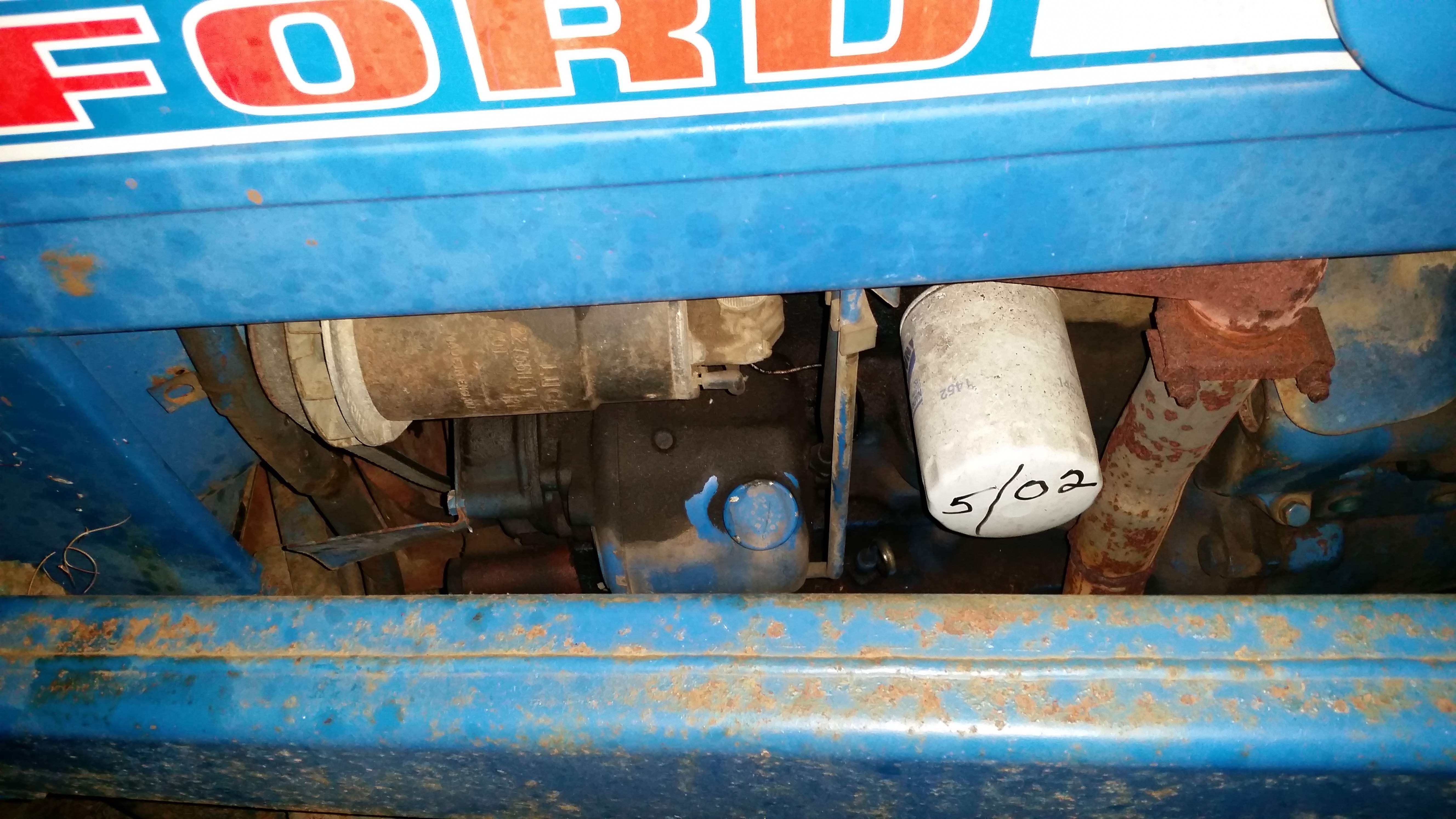

2015-09-23 19.09.56.jpg2015-09-23 19.10.15.jpg2015-09-23 19.12.45.jpg2015-09-23 19.14.59.jpg
Well here are some photos, these are the only places I can see for adding fluid.
This is my first tractor of which I bought about a month ago so I am totally illiterate, gotta learn sometime.

   / Hydraulic question on a Ford 3000 with 720 Loader #5
pic 1 is power steering resv... so is pic 2, pic 3 is engine, pic 4 shows the trans fill by the shifters.. and finally shows us where your loader is getting pressure from.. your top cover.. menaing it is using the rear /hyd sump of the tractor... finally now getting some where.
so far, you have missed a fill. :)
look behind the seat on the right side top of the rear end for another fill plug similar to the one by the shifter.

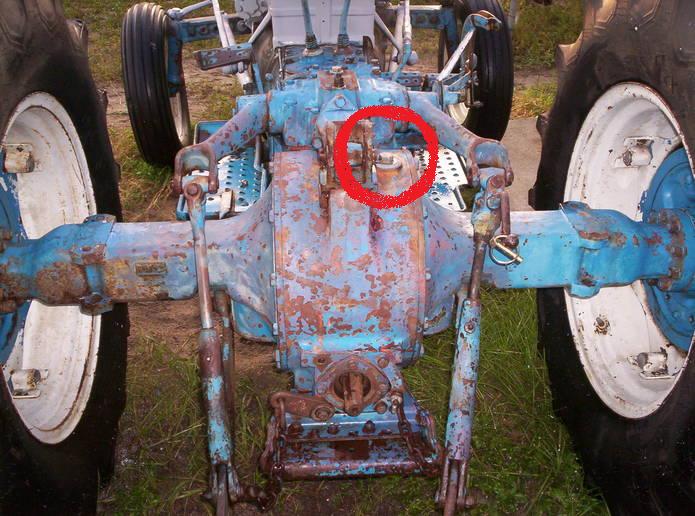

   / Hydraulic question on a Ford 3000 with 720 Loader #6
look here.... i've circled it in red on this 3000 i have.
That was it, thanks for the help.
