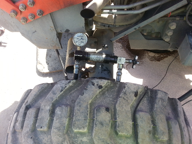

Customer complained that the loader didn't seem to have the power it once did and was slow lifting a loaded bucket. Not being from the school of "put a pressure gauge on it" I usually skip all that and eliminate the pump first.
Here's my flowmeter installed. At 2000 rpm the no load flow was about 10 gpm. At 1000 psi the flow had already dropped to 7 gpm and at 2000 psi the flow was less than 5 gpm. Had I put a pressure gauge in the system I'm sure it would have read real close to spec. Whatever that may be. With the flowmeter I don't need to know. If I would have still had 8.5 gpm or more at 2500 psi I would have started looking at other possible problems. Pumps can make pressure all day long but with no flow they won't do any work.

That's the right way Brian.....been doing it that way for over thirty years
I generally use 50 percent efficiency at max operating pressure (in your case 5 gpm) a point of absolute replacement.....new pump at 85-90 percent would be ok.....anything in between is a judgement call from the customer
I like to use the flow meter for monitoring after a new pump install too, the load valve makes a good break-in tool

70% is usually my threshold for replacement, especially if they are complaining about performance.

The pump was worn out from being worked. It didn't look like it was a lack of oil or cavitation.

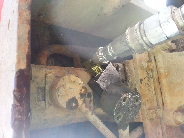

My L48 hydraulics have weakened to the fix it point. I'd like to do a flow test as per above but other than rebuilding cylinders I've no hands on experience. I'd be most appreciative if anyone would walk me through the procedure. Joe
