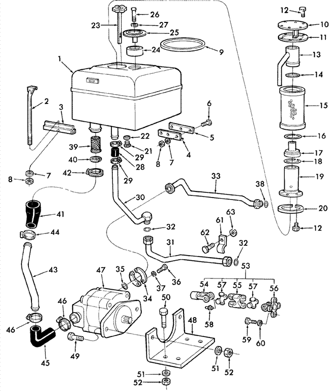

The pump is mounted about 1.5 ft from the front face of the engine. Connecting the two together a shaft with universals. One end bolts to the crank pulley with two bolts and the other slides over the pump shaft. I am not sure whether the pump shaft is splined or keyed. The pump is a gear type pump not a vane or anything else. I am not sure if it is dual or single but it only operated the loader before I added the backhoe.
Could something have happened to the pump when I split the loader control valve? I am sure that the backhoe is open center and fairly sure that the relief valve on BH works but I am not sure. My JD has power beyond so i guess that the loader valve could have been relieving when I bottomed out a cylinder on the BH, right?
Here is the diagram for my reservoir and pump.

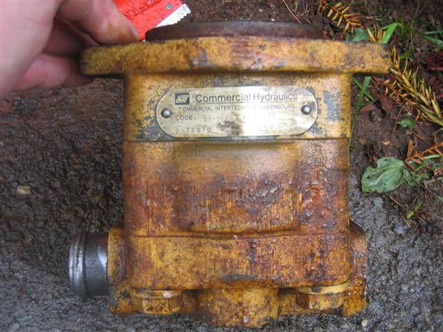

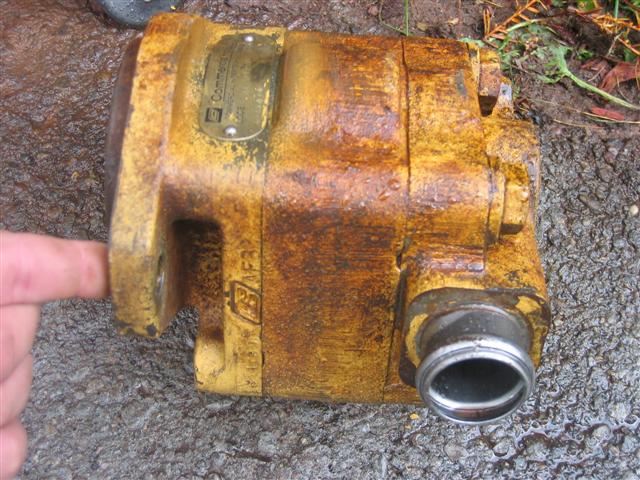

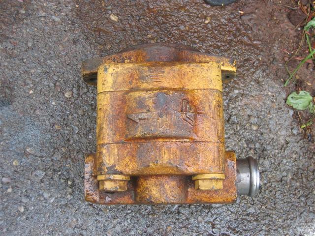

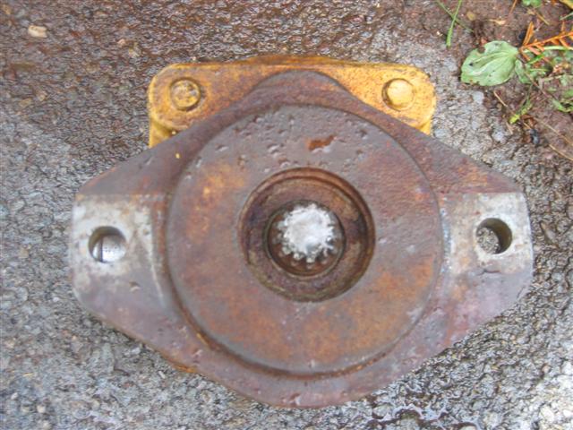

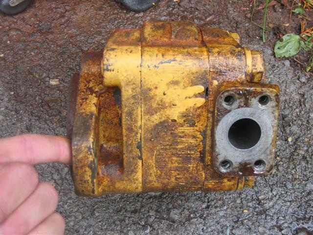

Alright, I got the pump off the tractor. The brand is Commercial. It looks to be cast iron and built in 3 sections.
/ Hydraulic Pump Broke
#14
Here are some photos of the pump.

Not a progressive failure from the looks of the shaft. No discoloration as would happen with crack progression over time. Can you turn the shaft w vise grips? Unlikely for an internal failure to cause a pump to lock up on its own, but a possibility. Pump turns as if the part of the shaft nearest the arrow goes that way.

No, I cannot turn the shaft at all. It will not budge. The inlet side of the pump has that steel tube inserted for a rubber hose and hose clamp. Is that threaded in there or held in there some other way?
/ Hydraulic Pump Broke #17
Its possible you had a pump failure that caused it to sieze, only coincidently associated with your mods. But it could be that overpressure broke something inside that stopped it and then the shaft broke. Have somebody that knows pumps disect it.
I dont know how the suction nipple is held in, sorry. Its not preventing you getting it apart is it? Maybe you can tell how its retained by looking at the inside
larry
/ Hydraulic Pump Broke #18
Commercial Intertech was purchased by Parker Hannifin several years ago. If you go to the Parker website, Hydraulic Groups section you can find the Commercial Intertech pumps and catalogs. A search on Commercial Intertech should also pull up some websites for distributors or suppliers of other, similar pumps. You can use the code on the pump to identify your pump with all of the options used in the build up (shaft, ports, flow rate, rotation, etc). You should be able to get parts, a rebuilt pump, a new pump, or a Commercial clone pump fairly readily.
Do you use the selector valve to port oil to the FEL or BH or for some other purpose? Do you know if the selector valve is open center or closed center? You'll probably want to used an open center selector valve so the pump isn't dead headed when the selector valve is in mid stroke.
