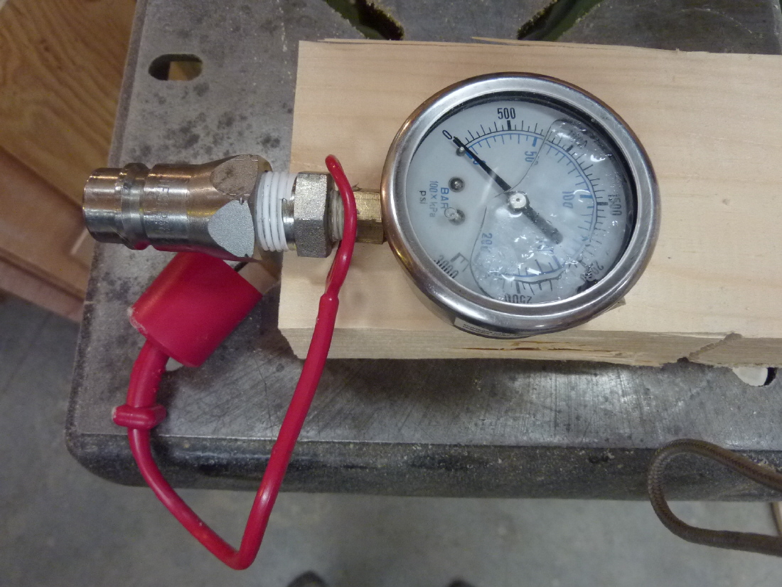

I got mine here: Bottom Mounted Pressure Gauges
Here is a picture of what I have. The gunk inside you see is glycerin. A vibration damper. Right now there is a male QD that fits a rear remote female QD on my tractor. Put on what ever fitting/hose you need for the measurement port you need to connect to. A short hose with a 1/4" male NPT is often handy.

Ken's Bolt On Hooks sells them now too. It's a 0-5000psi liquid filled gauge with a 18 inch (or so) hose and an ISO 5675 male plug. It would save you the trouble of putting one together. I was a little over 40 bucks, and I got in a few days. He has a few different sizes, I'm guessing you have 1/2 inch quick couplers.
   / Hydraulic pressure #15
drener I got on from NAPA auto parts it was in stock $30.00 Grainger had one for $58.00. NaPA was also closer to me.

So J.J. I should have measured the psi with a load on the scoop to find something closer to the max?? I only had the scoop itself on the TPH @ the time.. & was 1700-1800 psi. (just 4 my own info) I am happy with the way it works..
the only complaint I have 4 the scoop is the lifting spindles are 30 inches apart and the ones on my mower & BBlade are 26/27 inches. I am going to have a shop move the scoops to about the same so settings can be left alone when changing implements.. @ 30 inches there is barely any room left between the tires..
