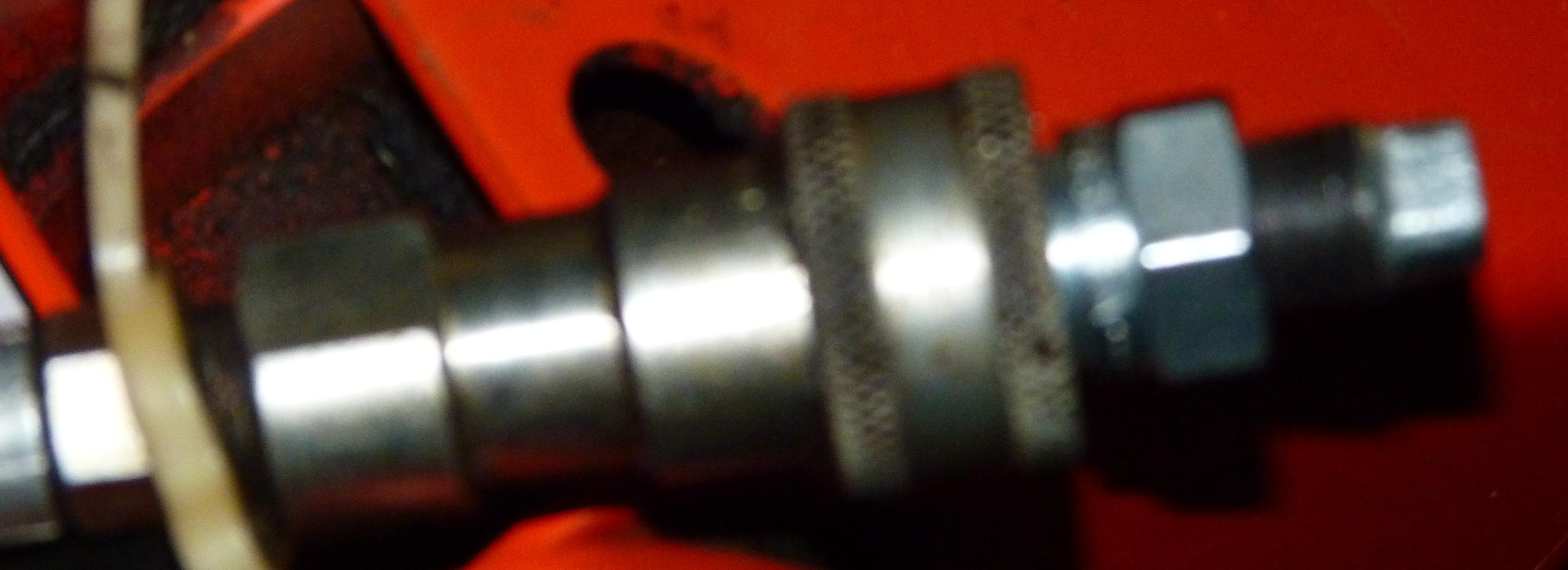

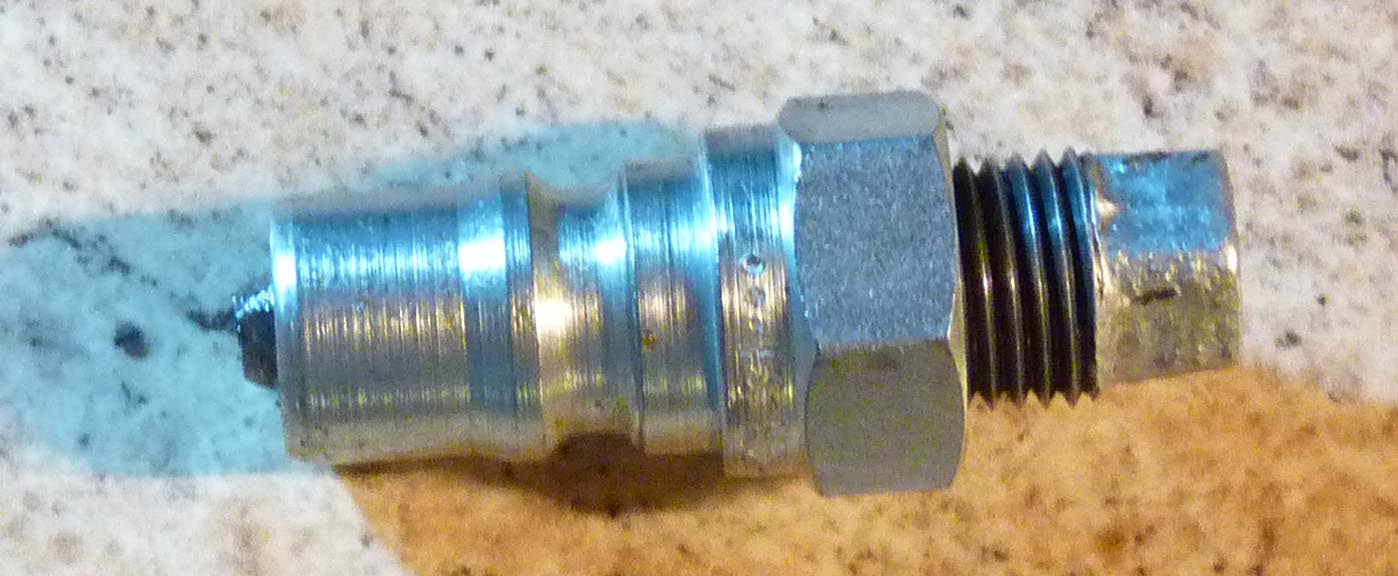

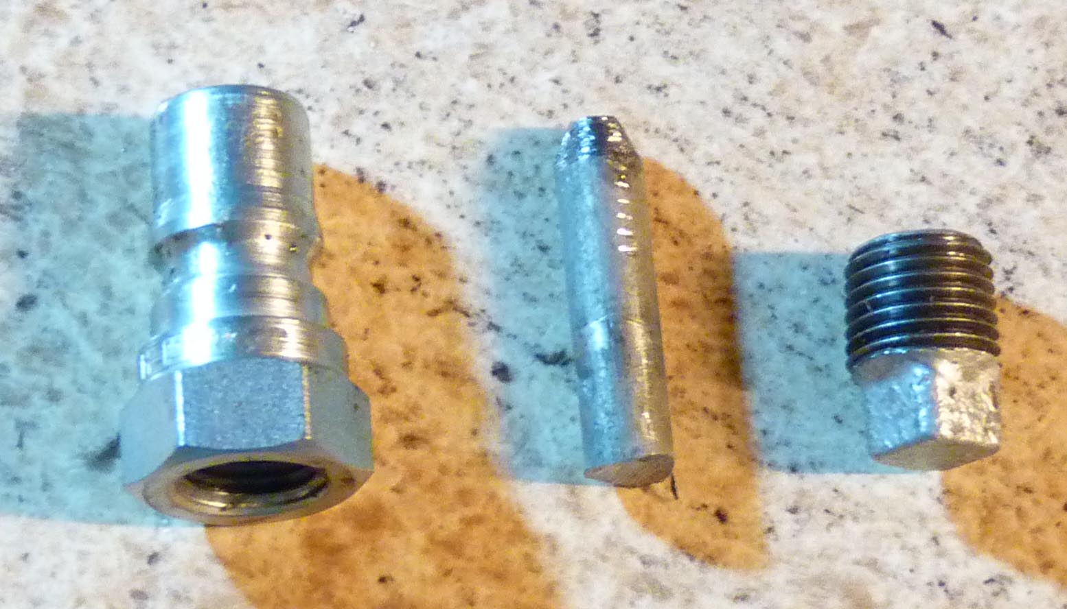

Often I would remove my FEL in the morning and try to put it back on in the hotter afternoon. But, the pressure in the FEL hydraulic lines would be too high to attach the tractor lines. So, I built this cheap little device. It is simply a male hydraulic fitting with the 'ball' inside removed. I then put in a metal rod with a rounded end. It is loose inside until I tighten down the male pipe cap on the end. Works great. It took about 15 minutes. Most of that time was spent trying to find the right sized punch to remove the ball.
<img src="http://www.tractorbynet.com/forums/files/kubota-owning-operating/433210-hydraulic-pressure-release-diy-release1-jpg"/><img src="http://www.tractorbynet.com/forums/files/kubota-owning-operating/433208-hydraulic-pressure-release-diy-release3-jpg"/><img src="http://www.tractorbynet.com/forums/files/kubota-owning-operating/433209-hydraulic-pressure-release-diy-elease1a-jpg"/>
That looks like something that's real handy to have in the toolbox. Cheap too. Thanks for the tip.
