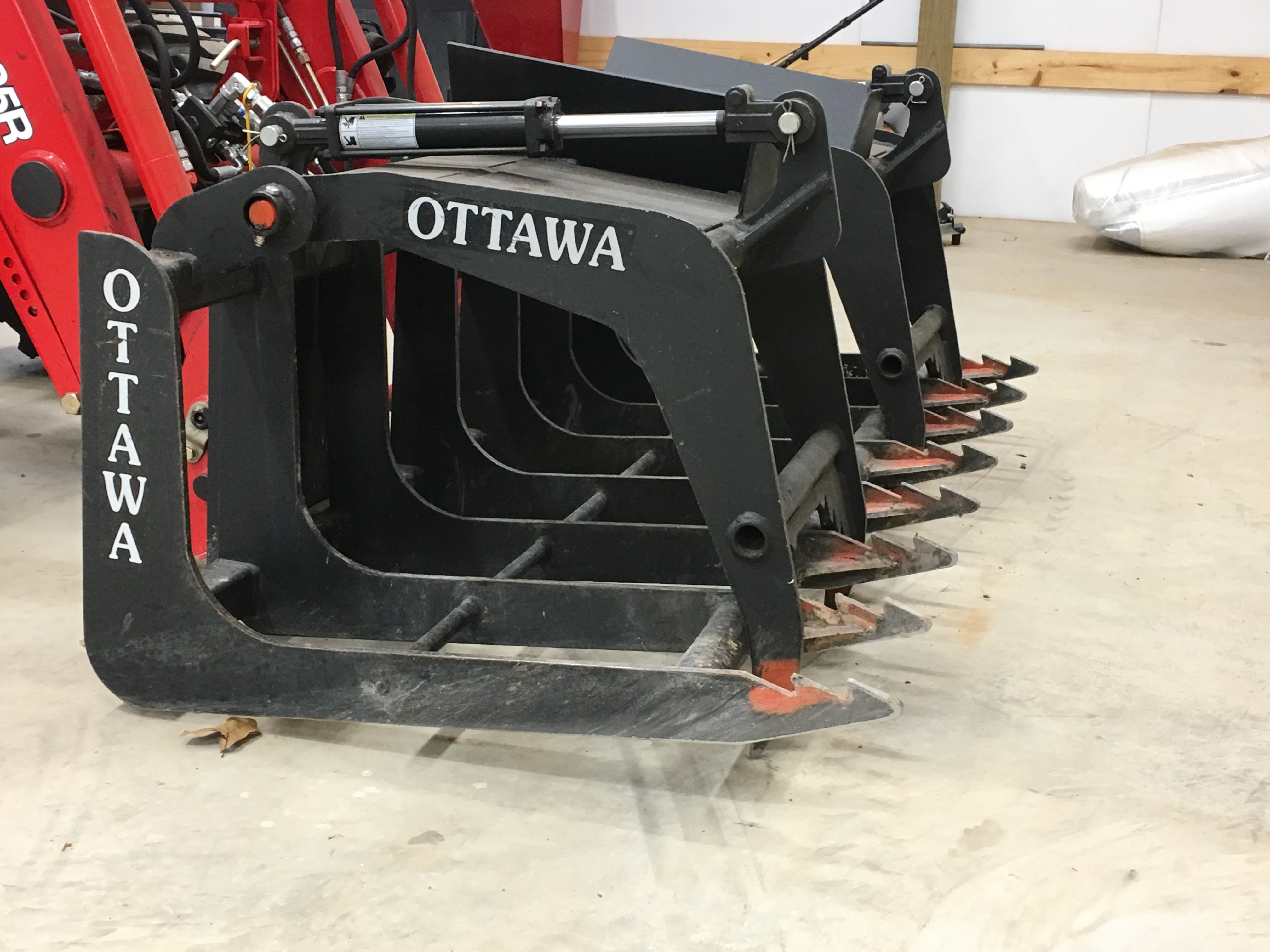

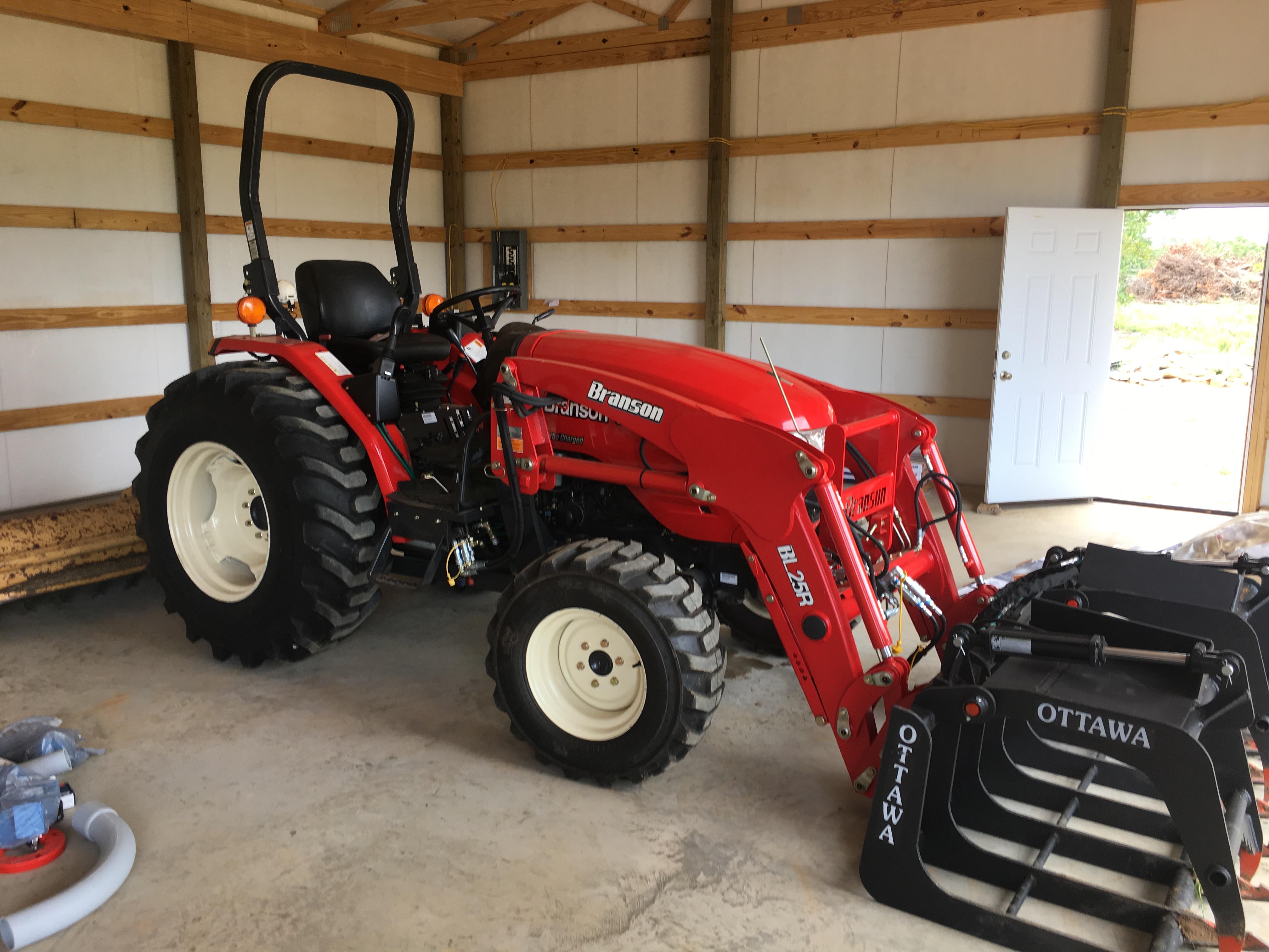

I live in North East Oklahoma. It's an awesome fly-over state. My original grapple weighed 800 lbs, and the new EA Wicked Root comes in at 400 lbs, so this grapple saved me half the overall weight and much better functionality.
Original grapple:

Wow! That's a huge difference, especially seeing as the old one doesn't look much wider than the new one.
