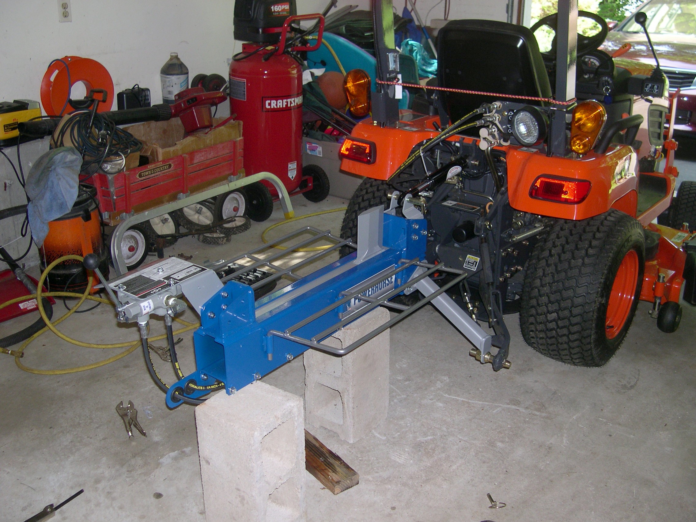

Read this thread on adding rear remotes to a BX, other than a BX24/25. Best option out there and what I did.
http://www.tractorbynet.com/forums/kubota-owning-operating/125660-bx7326-rear-aux-kit-install.html
I use one set of remotes for a hydraulic top link and I do use the other to run the small Powerhorse 3PH splitter. If you're not splitting cords and cords of wood each winter, or white oak, this unit is well matched to the GPM that the BX delivers.
I really need to get some pic's of the splitter in action. This is from when I installed it last year.
