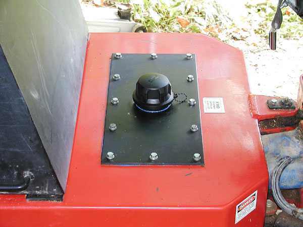

When I rebuilt my 1845 I just took the cover off and wiped the interior down with a rag. Evacuating the system was not an issue - it got evacuated when I took all the hoses off. /forums/images/graemlins/tongue.gif There was more gritty stuff in there than I might have imagined - apparently they never cleaned the tank after welding it up. /forums/images/graemlins/smirk.gif

<font color="red"> Did you say that you reached down inside of your tank. </font>
Yeah. remember this pic?

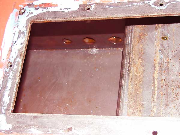

And here's one with the cover off, looking in at the three suction ports.

<font color="red">Did you flush out all the old fluid by putting the suction hose in a new bucket of oil, and running all the pumps and cylinders. </font>
No. I replaced every hose that was in or went into the engine compartment (38 I think) so everything was pretty well drained. I decided to ignore the little that was in the cylinders and pumps.
<font color="red">I was thinking I could use a pressurized tank of say kerosene or other solvent and spray all inside the tank and then drain </font>
I don't think that would work if your fill cap is centrally located above the tunnel. The tunnel pretty well blocks access through the filler. Also, much of the stuff I removed was heavy, like welding slag. Plus there was a thin coating of grit, like very fine sand not metal filings, on ALL the interior surfaces, even some on the top! Go figure. This stuff must not have been circulating or the pumps would be history - it must have been in place at fabrication time and stayed put. I'm not sure what spraying that stuff would do but it in a way it might be better to let it be. Of course my tank may have missed a step in the fabrication process and it may be the only one with this stuff in it. Yeah, right. /forums/images/graemlins/tongue.gif
