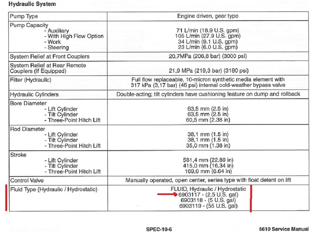

I don't have a dealer nearby. Anyone KNOW what oil is in a 2013 hydraulic system so I can get some locally?

CHECK YOUR OWNERS MANUEL--IT SHOULD GIVE YOU A SPEC. #. IF YOU DON'T HAVE A BOOK, LOOK IT UP ON LINE.
   / Hydraulic oil?? #3
My G series manual: other than the three Bobcat branded hydraulic fluids, the specs are 4C to 49C+...VG100; minimum VI 130. For -40C to 27C, VG46; minimum VI 150
I once looked up what oil Mobil had that would match those specs....Mobil DTE 10 Excel 46 VI 164
Not cheap oil though....I bought the Bobcat brand because the price wasn't bad and I can get it down the road.

In the Versahandler I use 10W-40 motor oil, because of this reference in the service manual:
The hydraulic fluid part number 6903117 is the same for Toolcat:

No the Toolcat is new enough that it has not been changed.
