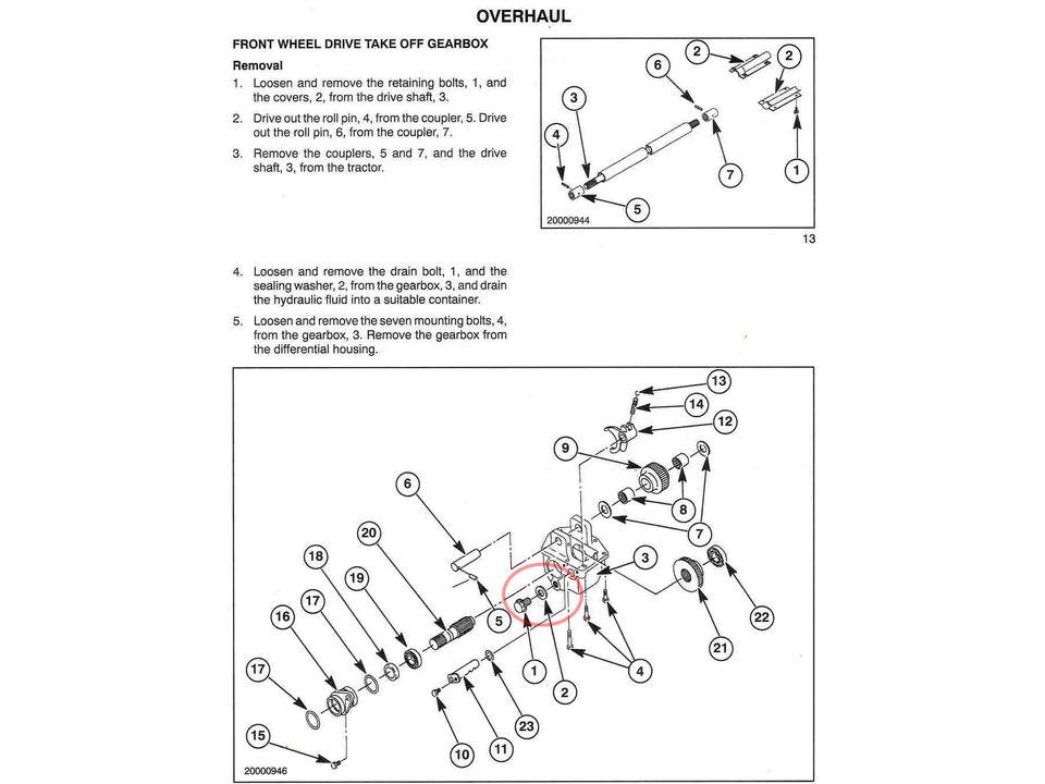

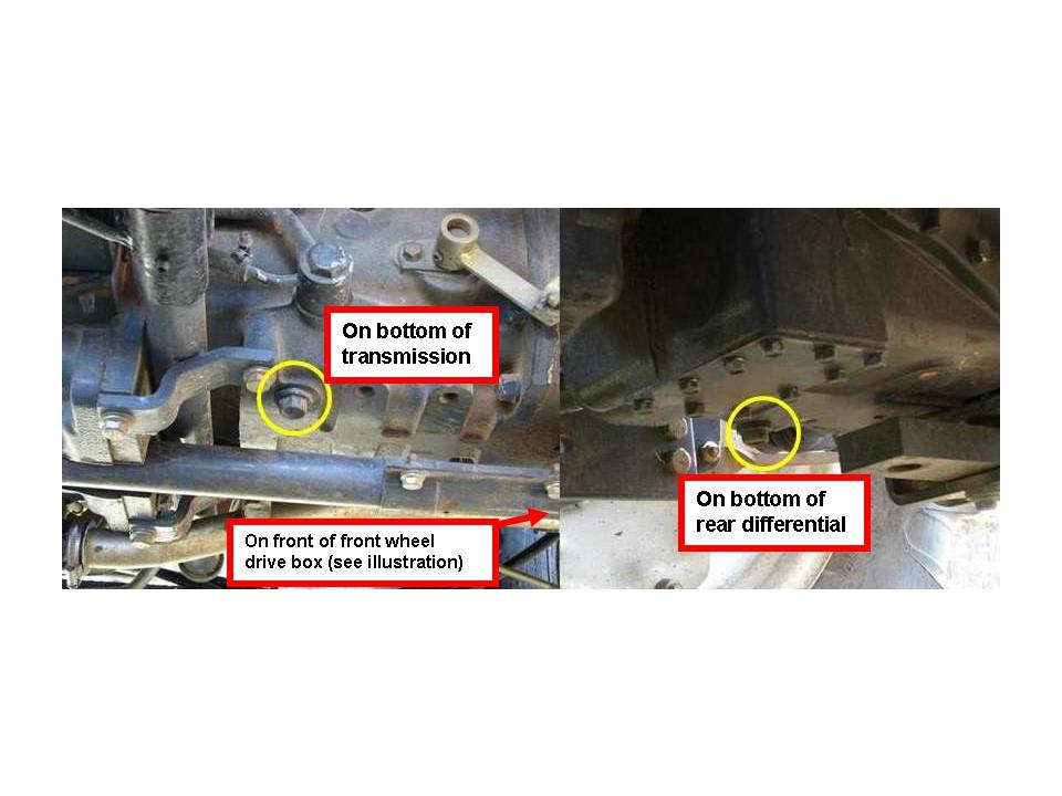

5. Now, to locate your drain points. There are three drain points for fluid as shown below. One is under your transmission, one is under the differential, and the other one is on the gearbox that drives the driveline going up to your front wheels. The photo and illustarations attached show the locations. The drain on the front wheel drive box is the lowest and will get the most fluid drained out of your reservoir.
Find a wrench that will fit these drain plugs and have it handy. You can use an adjustable wrench, but that is also a good way to round off the hex head on the bolts. I recommend a wrench. I believe they are 17 mm or 19 mm, but I don't remember for sure. A regular 1/2" drive metric socket set should have a size that fits.
When you remove the first plug, you'll get a rush of fluid. I guarantee it will be more than 6 gallons, so have the second bucket close to scoot under the drain as you scoot the near-full bucket away. You'll spill a few drops of fluid, so having some cardboard under the tractor also helps catch the small spills. If you have a very large catch pan over 8 gallons, you won't have to worry about this, but scooting two 5-gallon buckets has always been easy for me.
