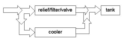

For my custom tractor project I am going to need an oil cooler as I don't have room for a tank that would have the capacity to adequatley cool the oil. Given the fact that this will be installed so the fluid goes through before it returns, is the radiators ability to allow sufficient flow inside or is the overall size more important? The reason I am asking about flow is my pump is going to be putting out 20 + gpm depending on rpm and I don't have the cash at this time to buy an official hydraulic oil cooler. However I know I can get a decent size transmission cooler off of a pickup for next to nothing and I already have a fan w/ shroud I can mount to the cooler...

There is no way a pickup truck tranny cooler will flow 20gpm. You could use it as a bypass cooler though.
'return -----------(relief/filter)----------- tank
' l l
' l l
' ----cooler------------
The trick is to put a slight restriction in the line between the Tee's. The best way is a 15psi relief valve or a filter with a built-in bypass. Second best would be a ball valve. The cheap way is to weld a washer on the hose barb. Just make sure the pressure ahead of the first tee doesn't exceed 30-40psi when cold at full engine speed, otherwise you will blow a hose off (assuming you are using hose clamps).

you dont need a cooler that can flow your total gpm... have the return line T with the full size return line and a smaller (say 3/8 or 1/2 in) line the runs through the cooler and then Ts back into the return line. like so:
...just saw someone else brought up bypass cooler. then use a standard automotive size and you should price up one relativity cheap.
do you think JD uses a cooler that can flow 50GPM?... not to my knowledge.
also i dont see why restricting return line flow and causing excess back pressure a good thing? if its to "force" more oil into the cooler. I doubt it will add any cooling performance other than hamper pump output. not to mention building pressure and working the pump harder adds heat.

That does change my options then to go that route, in that plumbing configuration. That drastically brings the cost down.

"also i dont see why restricting return line flow and causing excess back pressure a good thing? if its to "force" more oil into the cooler. I doubt it will add any cooling performance other than hamper pump output. not to mention building pressure and working the pump harder adds heat."
It depends on the exact parts being used, but you are almost certainly going to get more cooling by putting a restriction inline. The oil will take the easiest route back to tank, and an open line has a lot less restriction than an oil cooler. (especially tranny coolers for a 3/4t pick-up with -4 lines) Do you need full flow....certainly not. You might get enough flow by orienting the Tee's such that the flow has a straight shot into the cooler, but has to take a 90° turn to get into the straight section.
As far as excessive back pressure goes, that is a concern if you block the line too much. That is why I recommended not exceeding 30-40psi when cold at full engine speed. Once the oil warms up the pressure will drop to 5-15psi and will not hurt system performance. (filter blockage pressure alarms/gauges, if present, are usually set for 30-40psi.)
In general a bypass cooler is not as easy to install because you have to tweak the pressure balance to get adequate performance. The benefit is that you can get away with a cheaper cooler.
And for your information I know that these types of systems are used on off-road machines straight from the OEM. I was personally involved with at least 5 different designs.

I hate to point this out but the oil would fill the cooler like a tank and would go to static flow.....Won't work like you want.:confused:
This would work more like a heat sink on a electrical circuit :confused:
The input tee would have have a smaller orifice on the one leg to force more flow through the cooler other wise it would be pretty much worthless
And oil coolers have an insert in those tubes so that the oil is forced to flow against the inside wall of the tube so it will cool...Those are not just a hollow tube so there is a flow restriction that goes with those also
