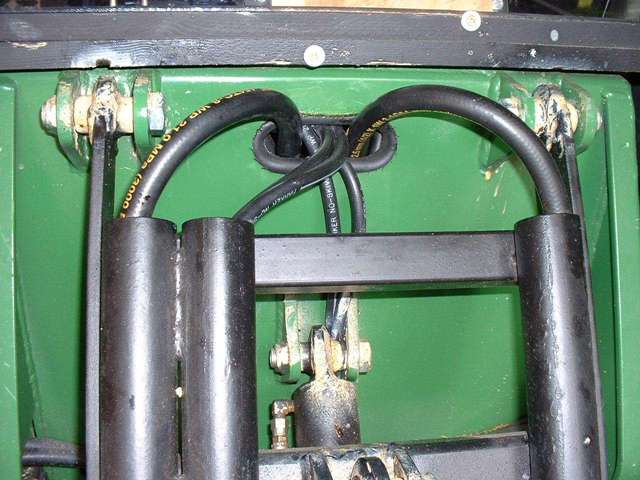

Good advice Peter, on the split hose protection your right. I've lined the front cutout hole where I found hydraulic hose's rubbing. I noticed notches or wear on two of them. Picture below of the fix. That was last year so far it has worked great. Guess I should be checking the ones down in the engine compartment also. Never thought of vibration doing any damage. ;)

Just FYI:
In 4.5 hours of tractor use, two of the drive hoses had rubbed down to bare metal on the bottom of the tub.
On my 1445, one of the brake hoses in the tub has about 11 other hoses resting on it. Yes, Virginia, it will probably need some spiral wrapping. All the brake hoses cross rather sharp edges just as they enter the motor housings, and two of mine had minor nicks in them already.
