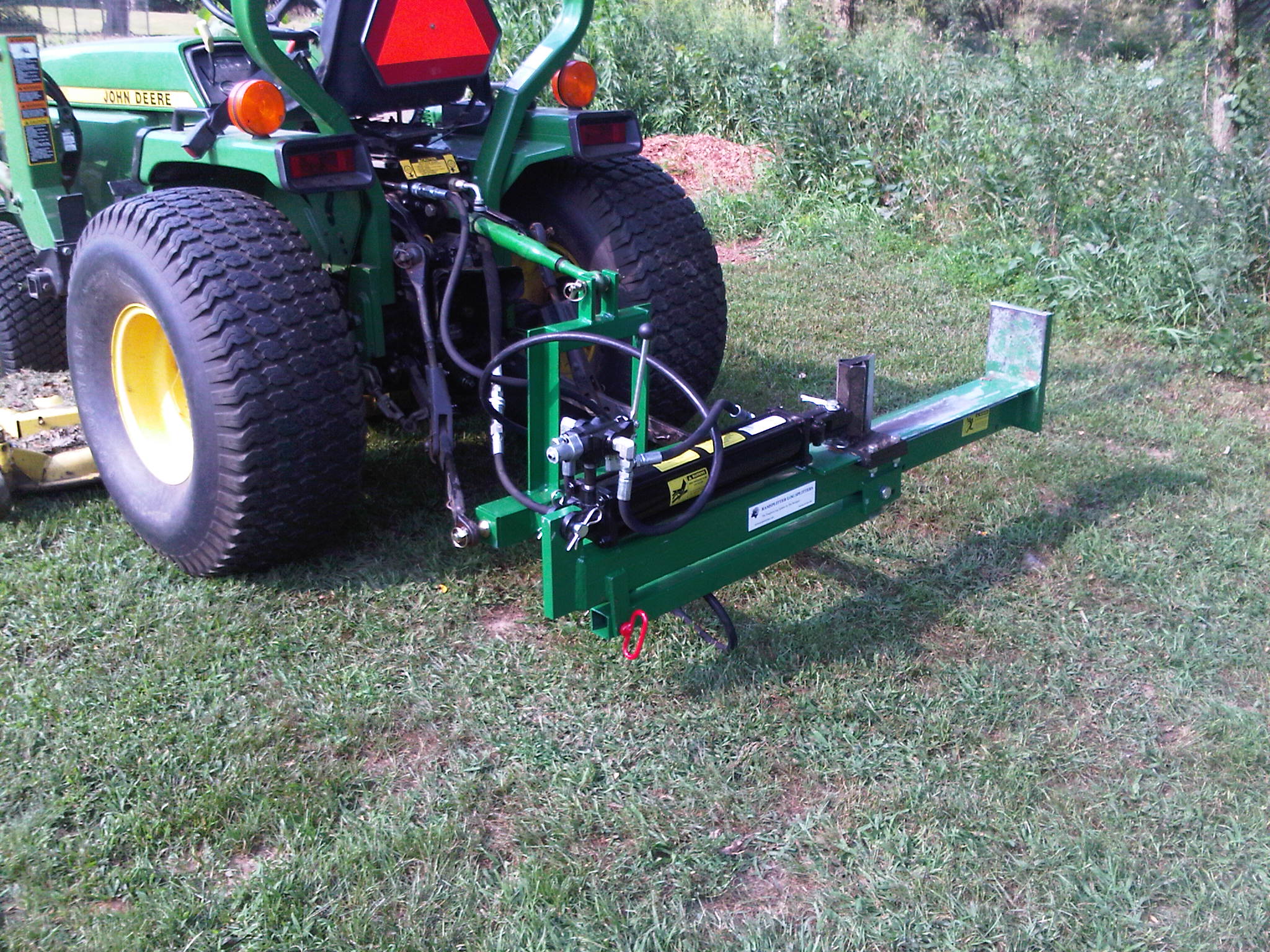

Another option:
Has worked well for me. Can be dropped and still used if the tractor is needed otherwise. A result of getting a deal on the splitter and owning an 8N at the time.

I have a 16 ton ramsplitter for my 955. 7.2gpm, 2500psi. At 1800rpm it moves plenty fast. At 2500rpm it outruns me. I agree with earlier posts. If you are going 3 point, go with a 3.5 inch cylinder or less.
