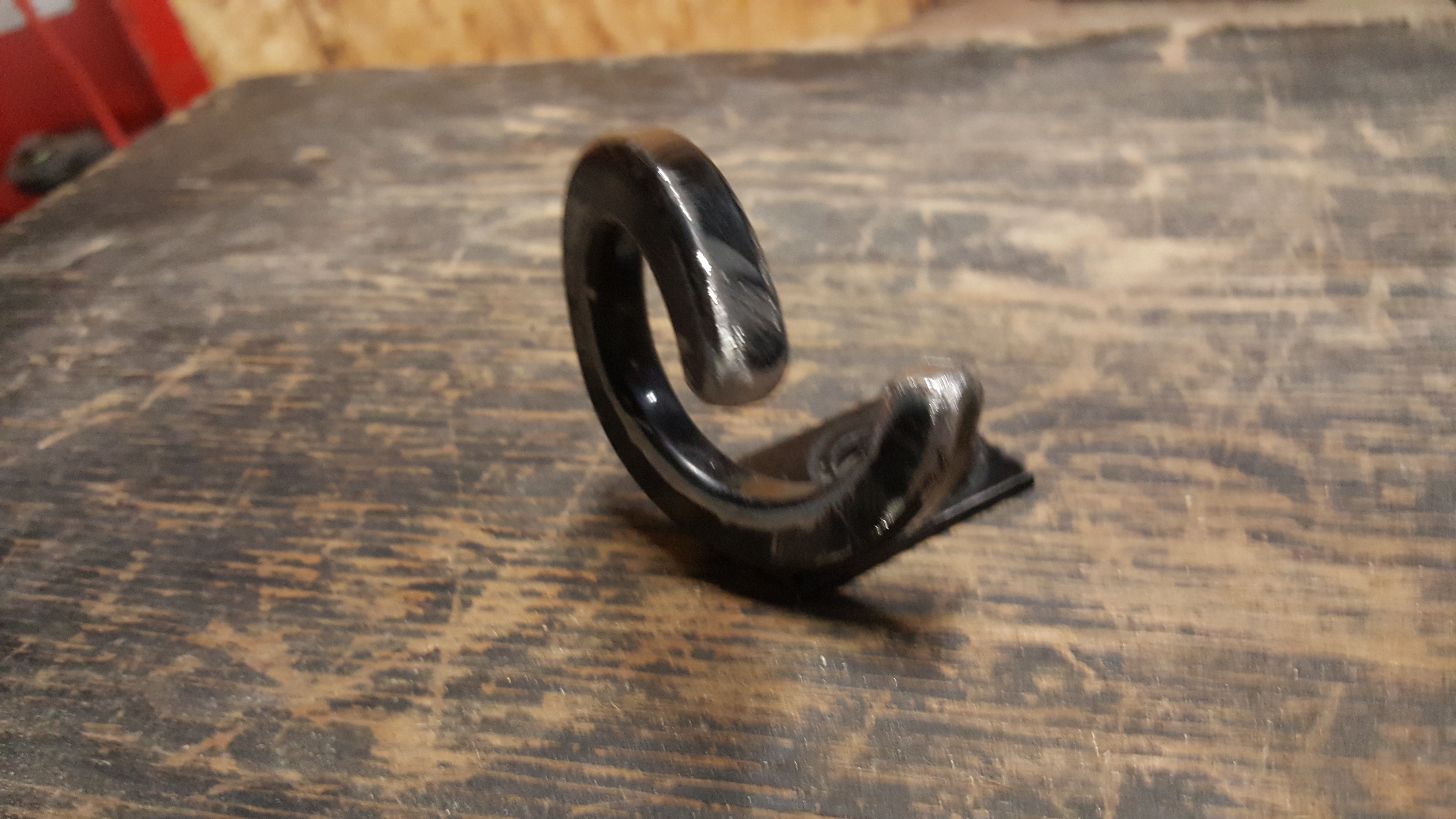

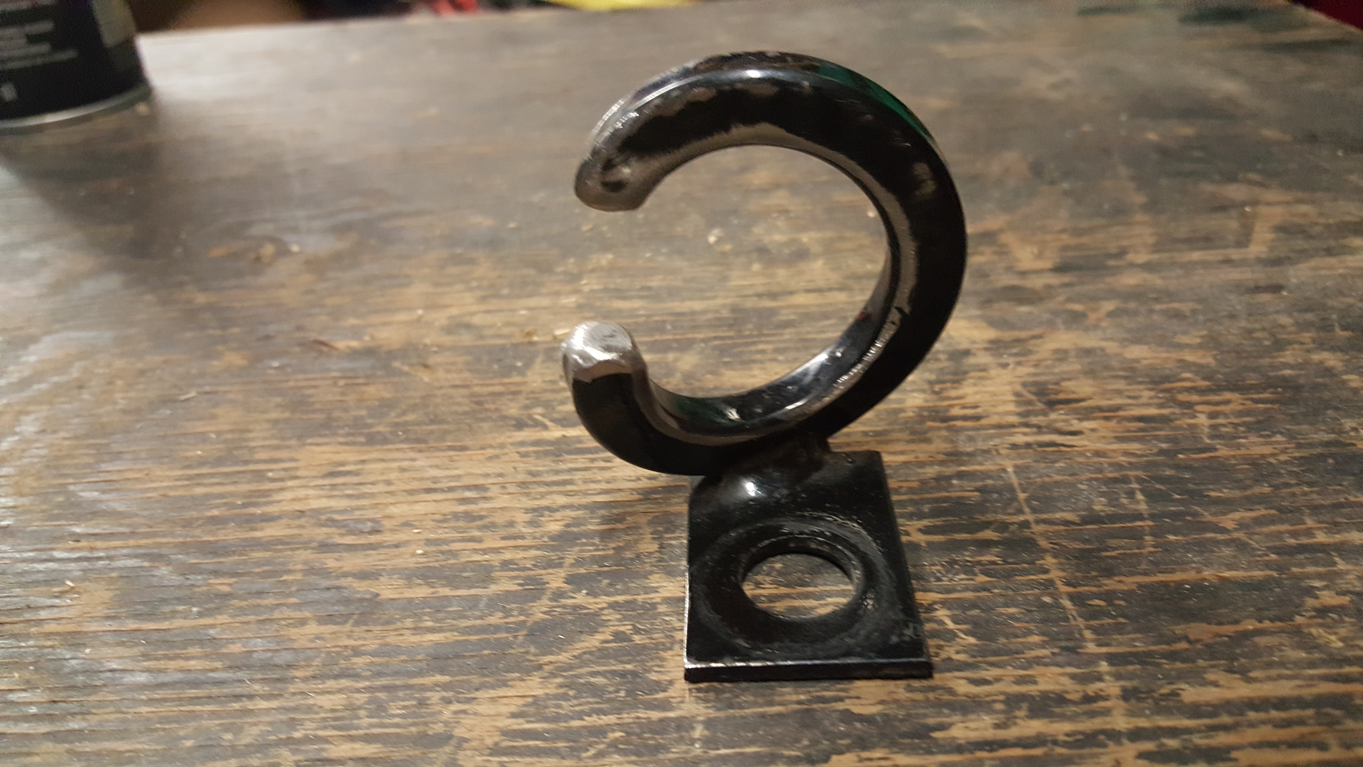

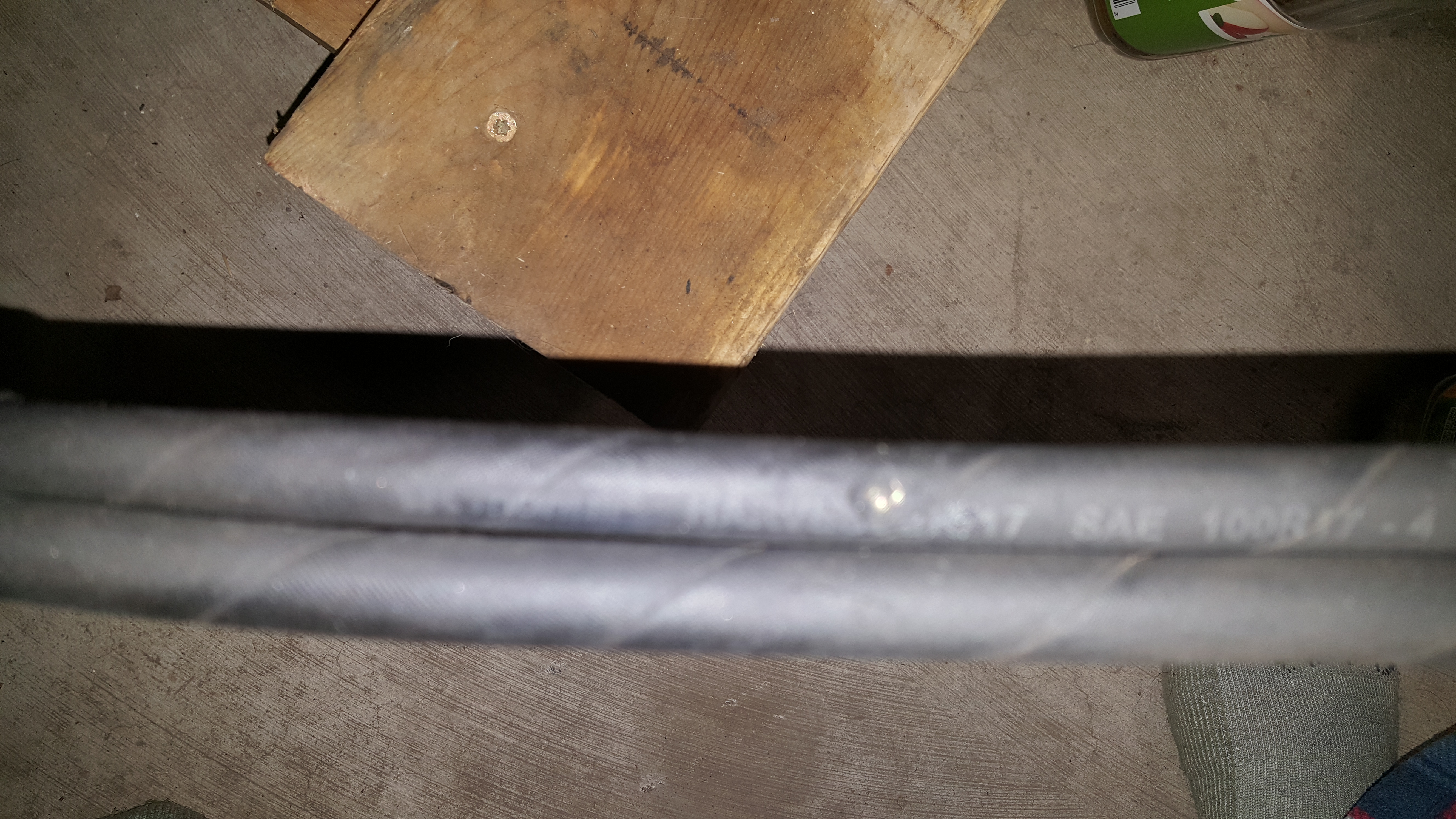

Last spring when I removed my Quick Hitch and Dozer Blade from the front of my tractor, I noticed a wear spot in the hydraulic hose (Blue connection) from the Quick Hitch.
This wear concerns me and I'm going to have both hoses remade at a hydraulic supply shop.
The wear area comes from the hose support bracket that is fastened on the outside forward right hand side of the tractor frame, part # MF4263066M91.
This bracket has sharp squared off corners on both of the opening ends, and I have always zip tied the hydraulic hoses to this bracket, but sometime during the winter the zip tie broke and fell off.
Today I ground all of the sharp corners off of this bracket and repainted it before reinstalling it.
These sharp open corners on this hydraulic support bracket have always concerned me but now I will not need to zip tie the hoses to it anymore.
Hope this helps others with the same design/flaw?
I should of taken care of this over the summer, but I just plain forgot about it until today when a couple of inches of snow was falling...
KC
Edit: Forgot to mention the 2 pics are after I ground off all of the sharp corners, and it seems MF made this bracket out of keyway stock material.

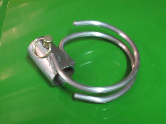

It sure would help if the legs of the hose guide overlapped more. This is a guide I made for my grapple. You don't need to overlap this much but a good inch more on the OP's guide would help.
   / Hydraulic lines rubbing issue for Quick Hitch and Dozer Blade #9
The overlap is only needed to keep the hoses from coming out of the holder. The OP's holder doesn't mount like it's pictured. It actually mounts with the opening upward. So the weight of the hoses is keeping them in the holder.
I like your holder made from round stock. No sharp edges to worry about.
I forgot to mention earlier, in regards to the hoses pictured. I wouldn't worry about replacing them. It appears they just have the outer coating rubbed off. The exposed steel is where the hose gets it's strength and it appears to be fine. :)
