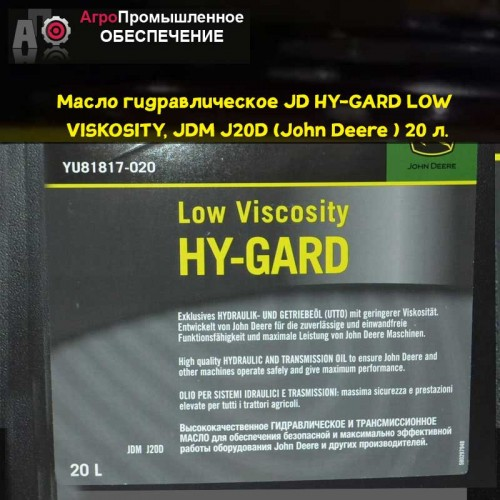

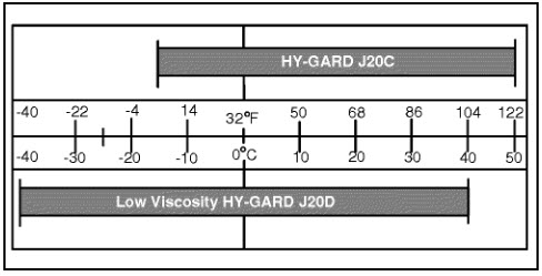

Don,
Hydraulic leak from hoses? Fittings? Gaskets?
-25F is drastic. Both Yanmar and John Deere require J20D for hydraulic fluid in extreme low temperatures.
Or in 20L bottle.

Thx makes sense !

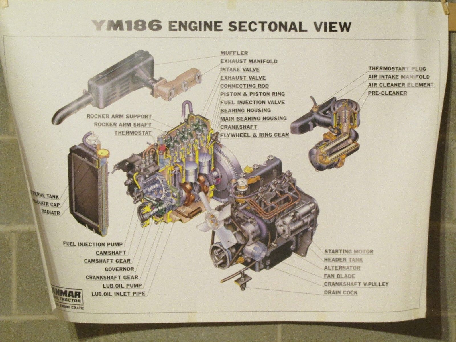

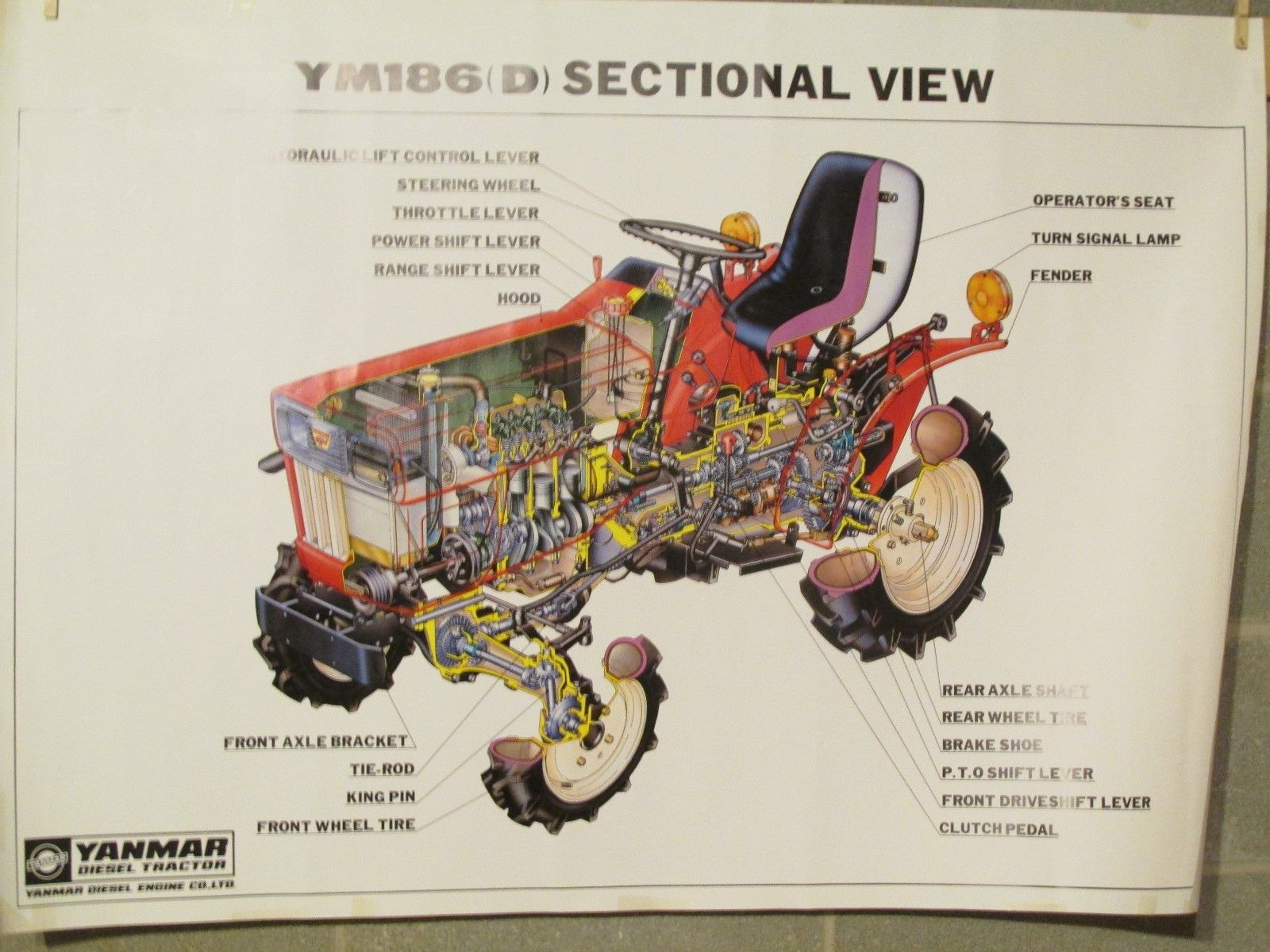

From member rScotty brochures
Tractor Ernie had these posted some time ago,
If your leaks were with the power steering, it's a typical occurrence too.
