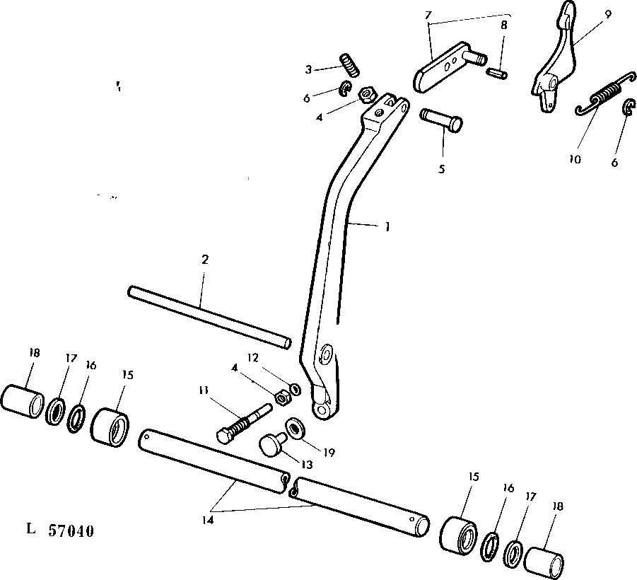

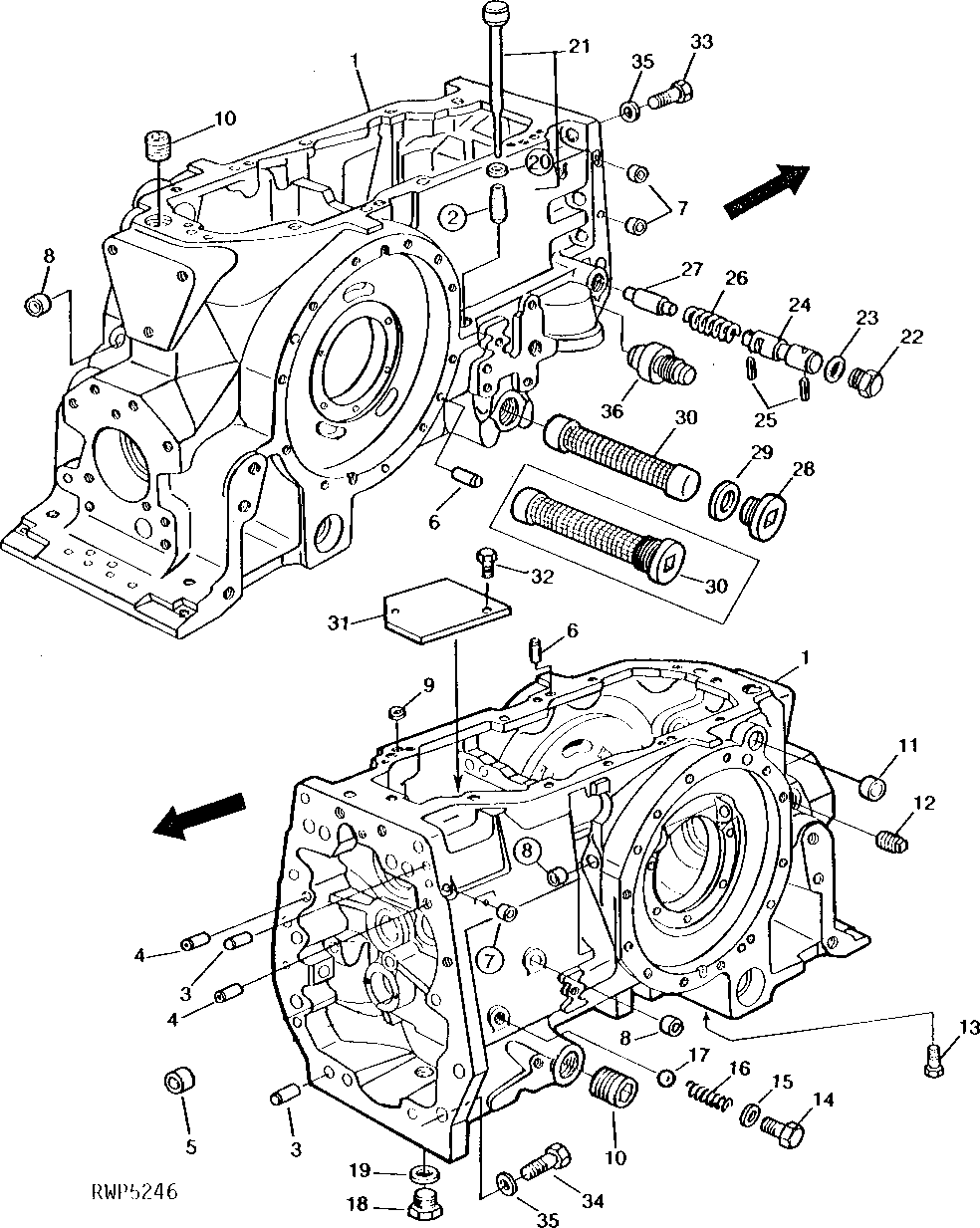

I have a hydraulic leak at lower lift arms at case. It has pin at bottom the bars attach to. Are they seals on this. Can this be a easy fix or is it major problem.

Oil leak is aa relatively easy repair. Drain hyd oil,put L/D control lever under seat in "D",remove draft arms and slide shaft out. Inspect shaft & bushings for wear,R&R seals re-install shaft and draft arms eliminating any side to side motion in shaft with shims. While you have oil drained would be a good time to check cleanliness of sump screen(parts key #30)
