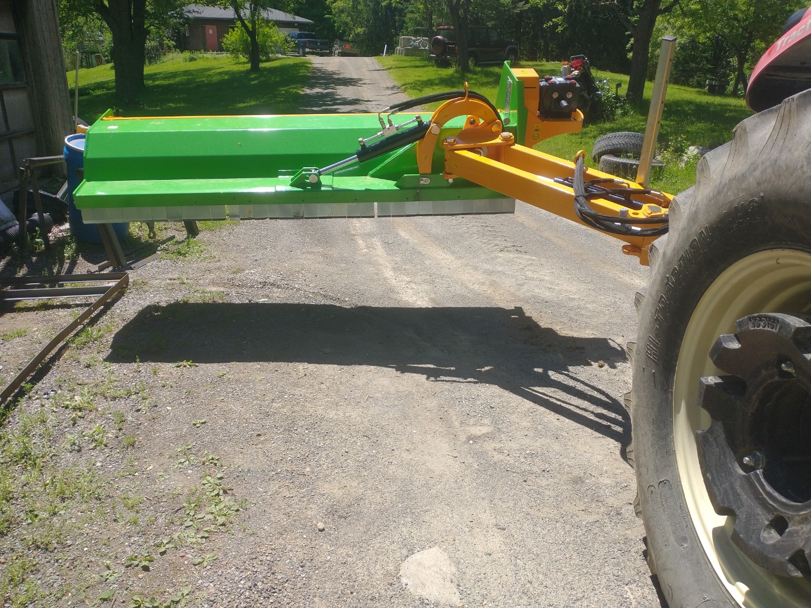

This weekend I put together my new ditch bank flail mower. DB Flail
I'm having an issue with the hydraulics "fading". The tip of the cutter, furthest from the tractor, is constantly dropping. After only an hour of cutting it's clear that this condition is not going to be acceptable.
Any ideas? Maybe a defective cylinder?
Thanks!

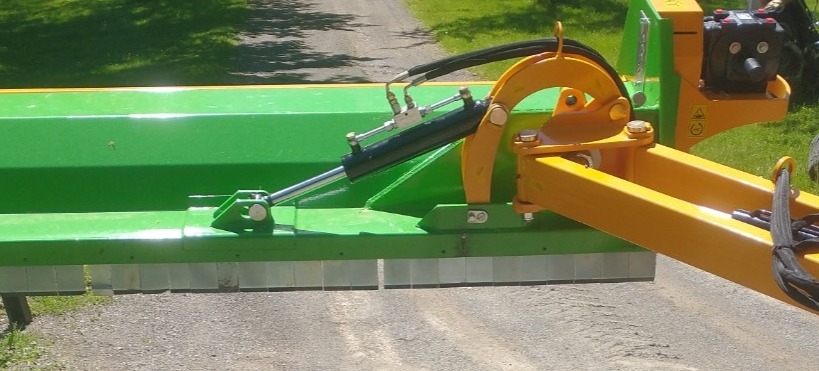

Mine has a "lock" or pilot operated check valve on the tilt cylinder.
In the close up picture you can see the lock valve, also where the lower pin (the rod end) goes to the deck there is a slot unless I'm carrying the deck I try to keep that pin centered in the slot.

Just a quick add if your cylinder has the lock valve, float on the remote will not work. You would need to trim it to keep the pin roughly centered in the slot.
