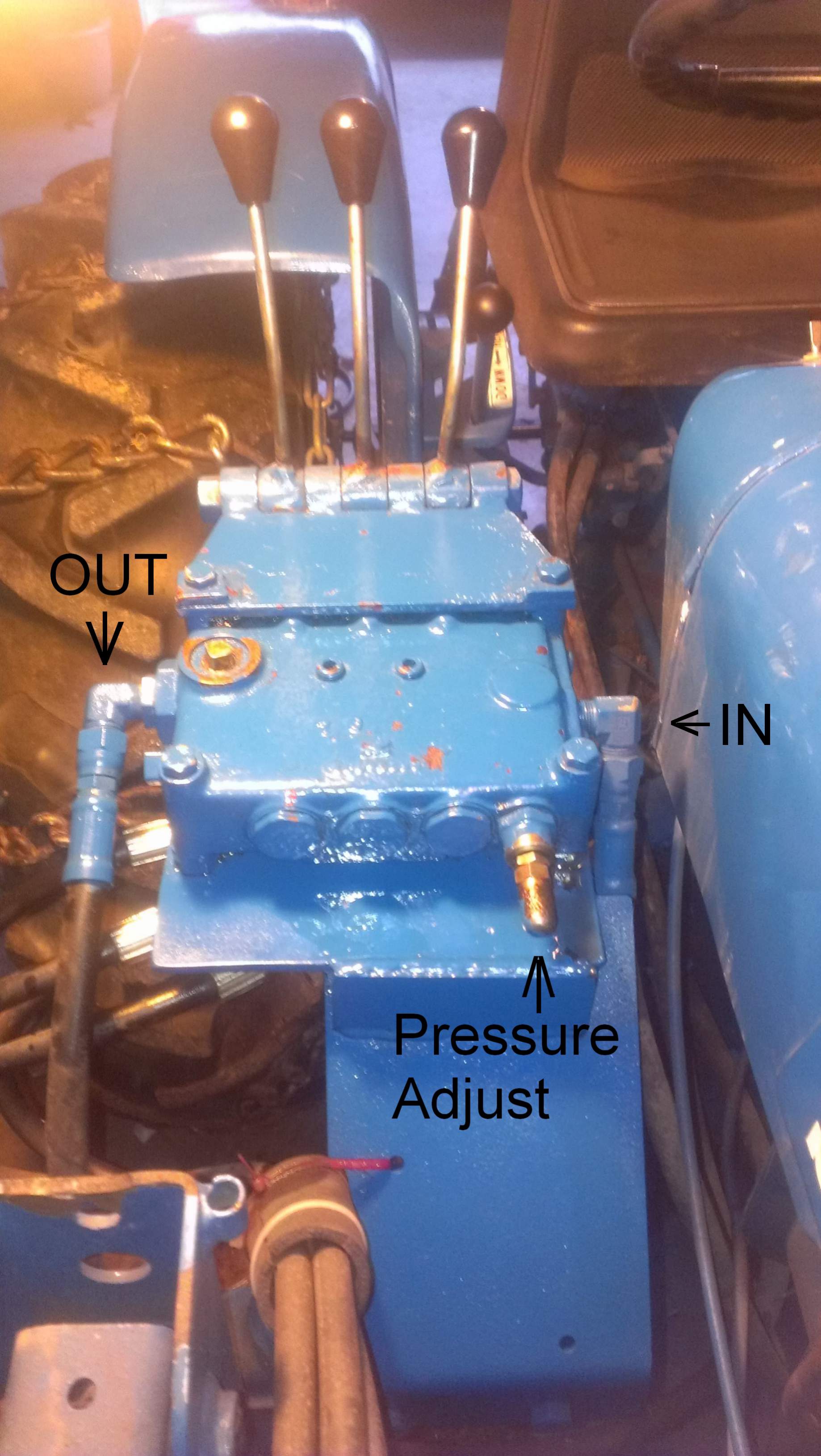

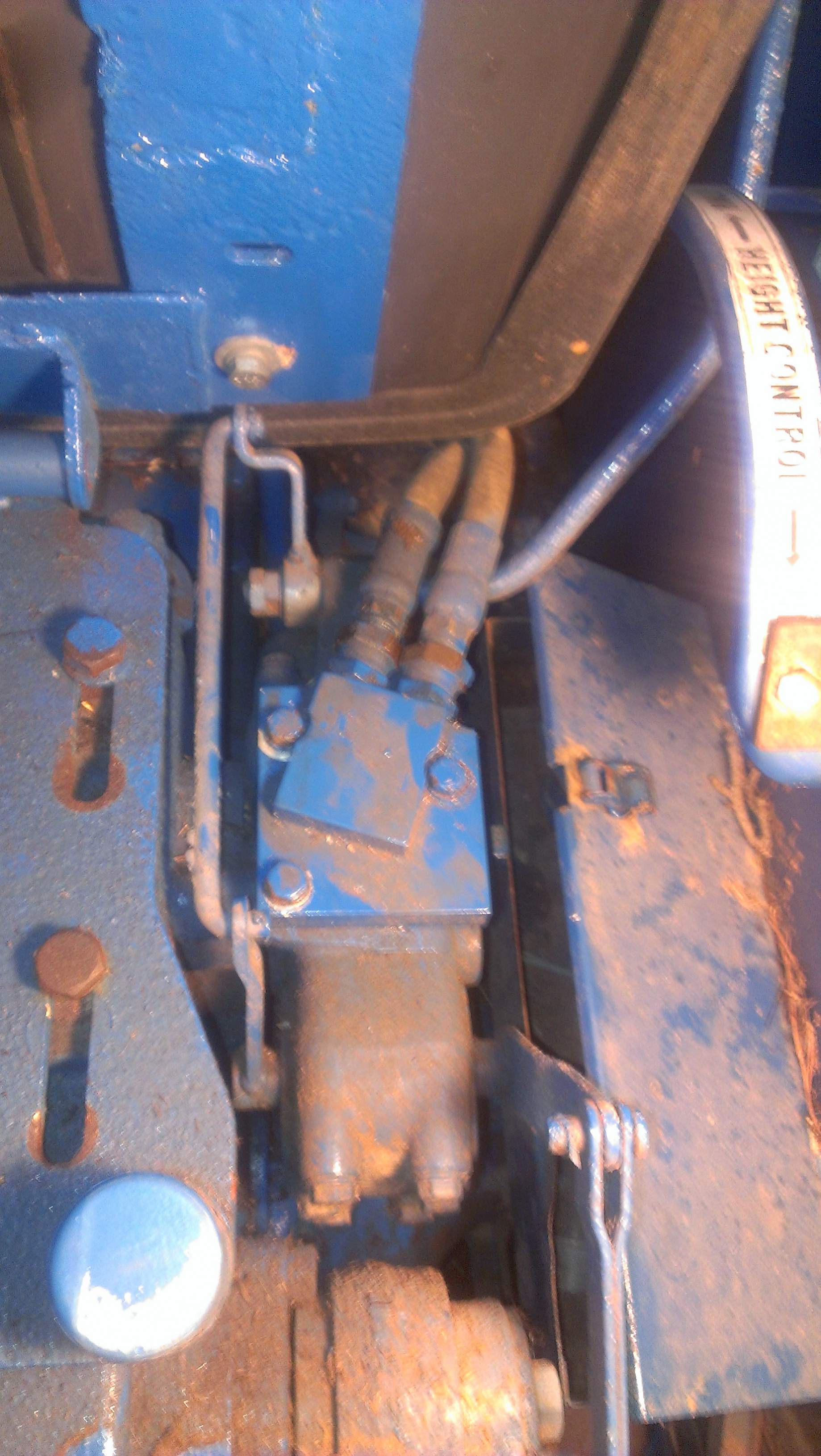

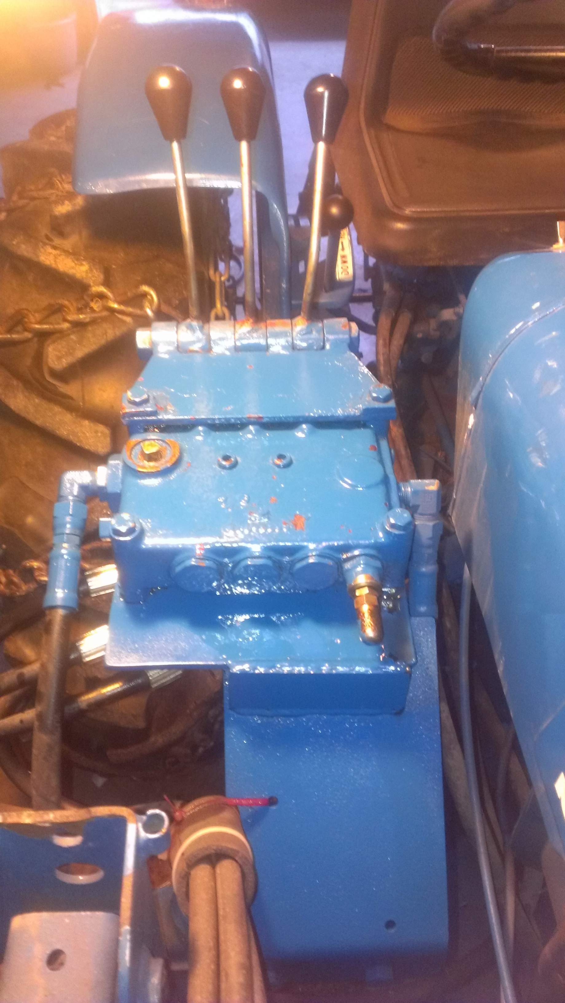

First pic is the FEL controls. There are six hydraulic lines. Two run to the top of the hydraulic "cap" by the rockshaft (pic 2). they other four run to the FEL cylinders. IMAG0013.jpgIMAG0014.jpg

I added some labels to the first picture.
What is the "OUT" hose connected to?
Is there a tee connector on either hose from your other valve?

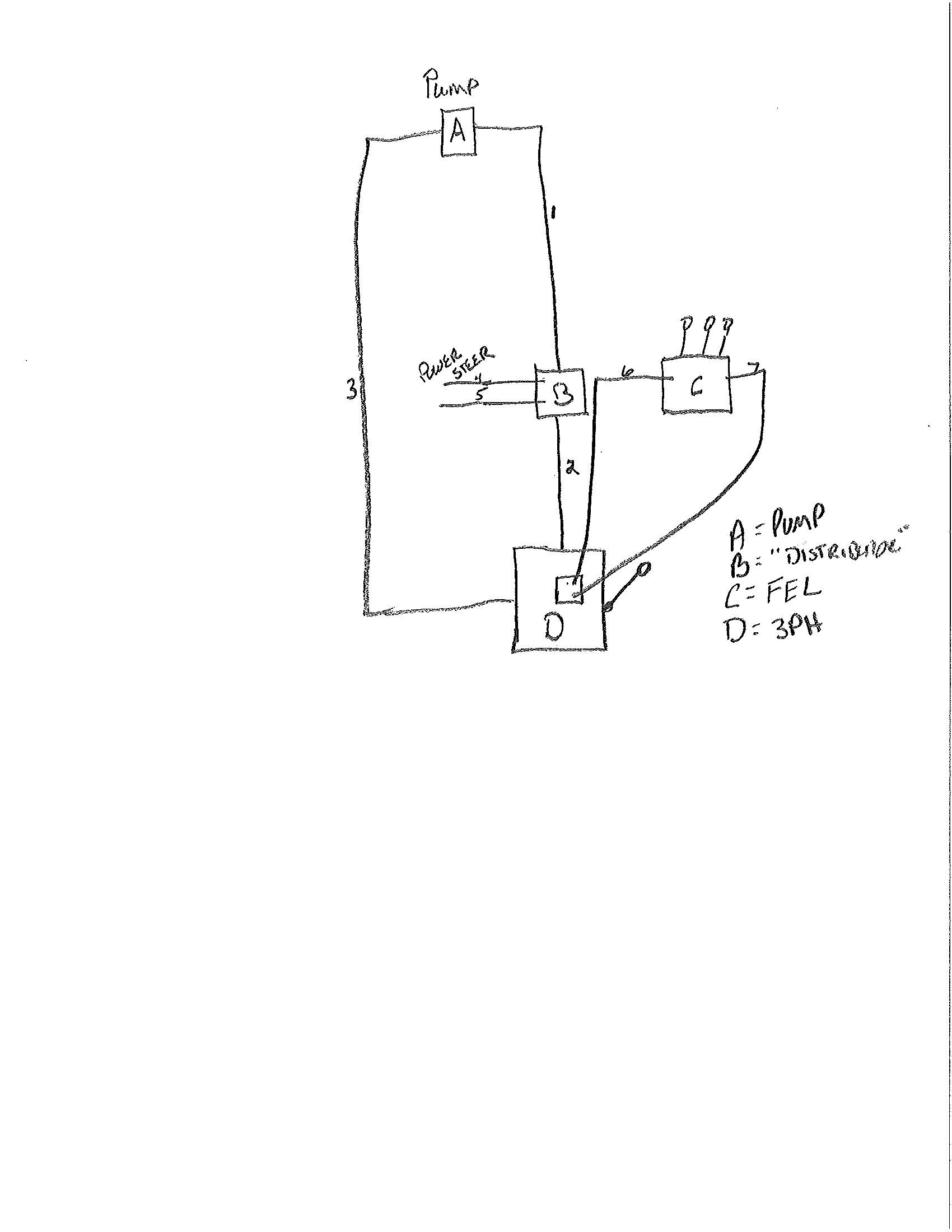

See Picture (drawing) attached. This may help us get a clearer picture on the hydraulic system. Pretty basic.
oldnslo: to answer your question, it takes ALOT of force to move them, barely humanly possible. The handles are being pushed toward the front of the tractor (away from driver).
kennyd: The fluid distributor is a "box" that the power steering lines ties to. Nothing more than that (see pic).
By looking at the pick, I think the line 2 (from box B to D) is either clogged, or the distributor (Box B) is clogged. Reason: when I raise the 3PH, rather than fluid come from distributor box (Box B, line #2 on diagram), is it sucking the fluid from FEL Control (Box C). I cannot think of any other reasonable explanation. Again, I'm no mechanic, but it makes logical sense to me. Unless anyone has a better idea, I'm going to tear apart that box and line and make sure they are clean.

That is not the way hydraulics work. Your problem is flow is going in the out port of the loader valve, causing the bucket to dump and the lift cylinders to retract. When did this start happening?
My idea is the problem is in the 3PH circuit.

If this is an open center hyd system, and the hyd flow is like this. Pump to loader, to 3pt , to tank.
J.J., in his drawing the 3pt is before the loader. The plate on the 3pt reminds me of the old Massey Ferguson system for adding a cylinder. You had to lock the lift arms to use it.
On most tractors, without loaders, the pump fluid goes to the 3pt, and there is some kind of distribution unit somewhere, similar to the Kubota hyd block.
When a loader is mounted, the fluid is now routed to the loader first and back to the hyd block, and then to the 3pt.
He could easily take a hose off and verify the flow path.
A hyd gage would help with the troubleshooting.
It is just not logical to have to raise the 3pt when you want to use the loader.
Which relief valve has priority, 3pt or loader?
