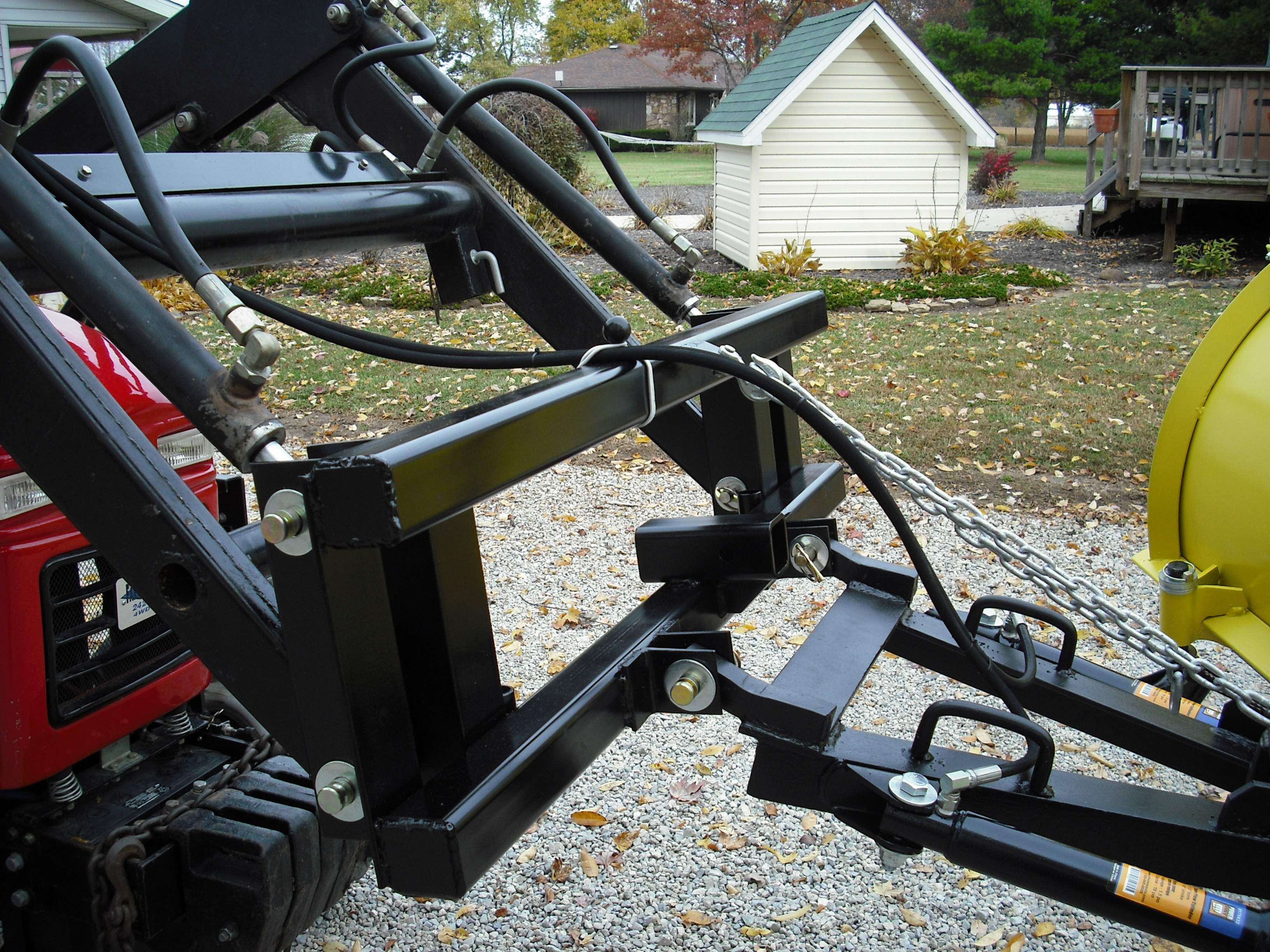

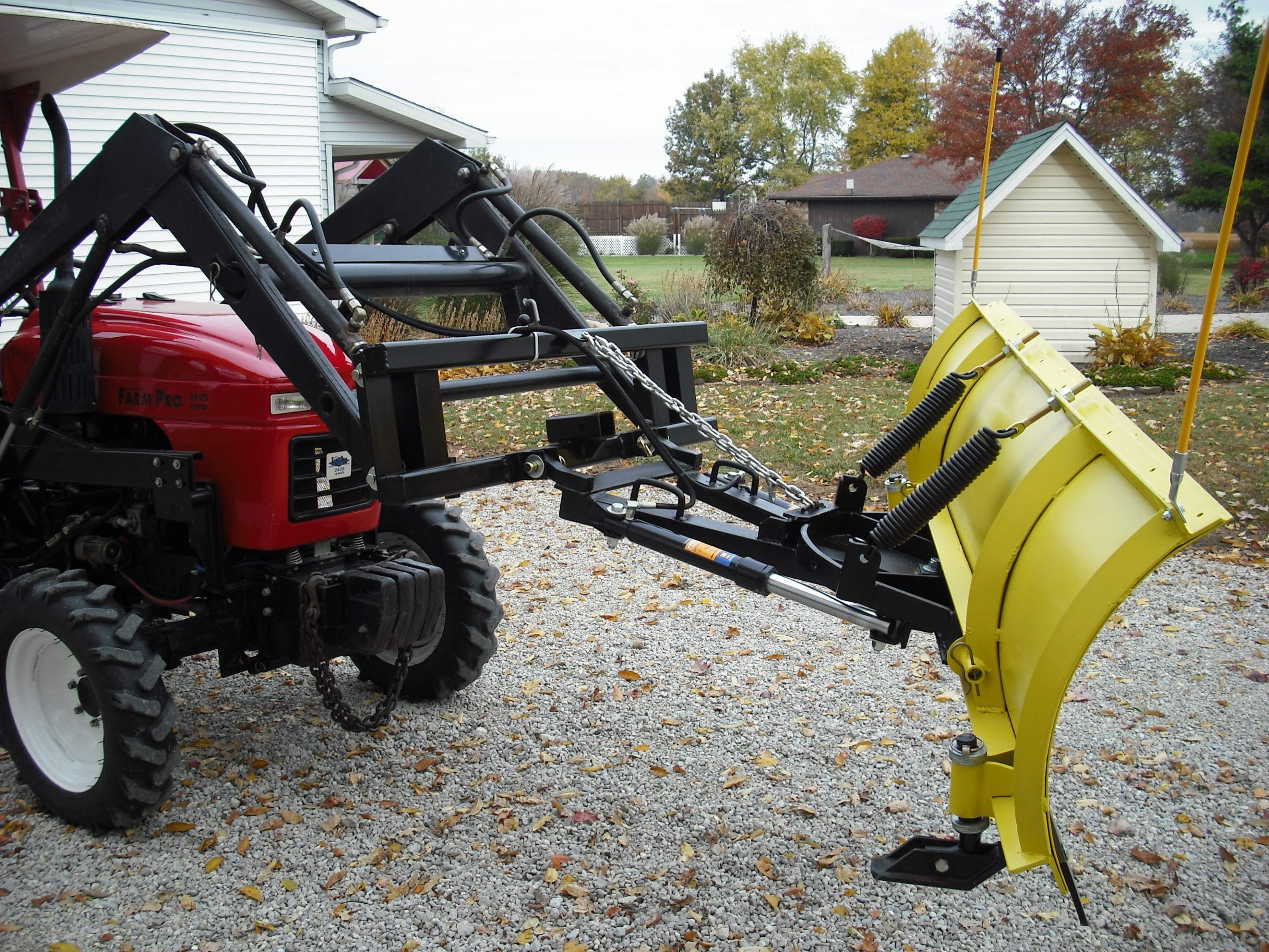

I used 1/4" hose 17' long to run the power angle on my plow. My system is 6 gpm I believe and it works great. I had 1/2"QC at the rear but not issues. My setup is just temporary when the plow is on.
Chris
