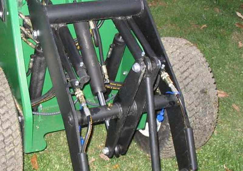

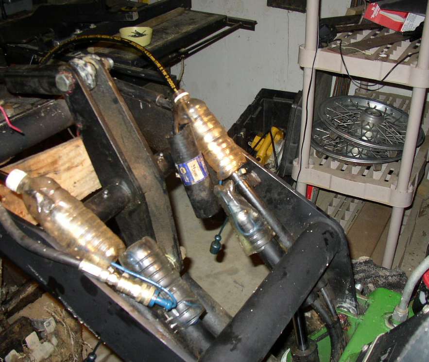

I was annoyed at how much dirt gets on and probably in the quick disconnects. I decided to protect the power take offs with water bottles. I cut off the cap end and just slid them on. Yeah, sometime they fall off (but rarely), but they are real cheap.
I also protect the quick attach fittings by slitting the side of a piece of radiator hose (used is fine) and slipping them over the fittings. These are not perfect, but it helps. I have attached a picture.
Does anybody have a better suggestion?
Oh, on some of the attachements which use the quick attach fittings, I drilled a hole in the water bottle cap, took the fitting off the end of the hose and slipped the hose into the bottle. I also cut the bottom off of the bottle. The bottle can then be slid onto the quick disconnect when in use and slid off to disconnect and connect.

   / Hydraulic hose quick disconnect dirt shield #2
Bob:
You can buy very inexpensive plugs for the hose ends that slide on to the hose over the connector. Then when the hose is not in use, you just plug it in to the connector.
If you look close at the attached pic, you can see them hanging down. (blue thingys)
Even with the plugs (which I use) dirt gets into the sliding disconnect ring. It sounds gritty and could not be good. I like the additional protection of the bottles.
Some think that I am paranoid. I just worry if I am paranoid enough.
