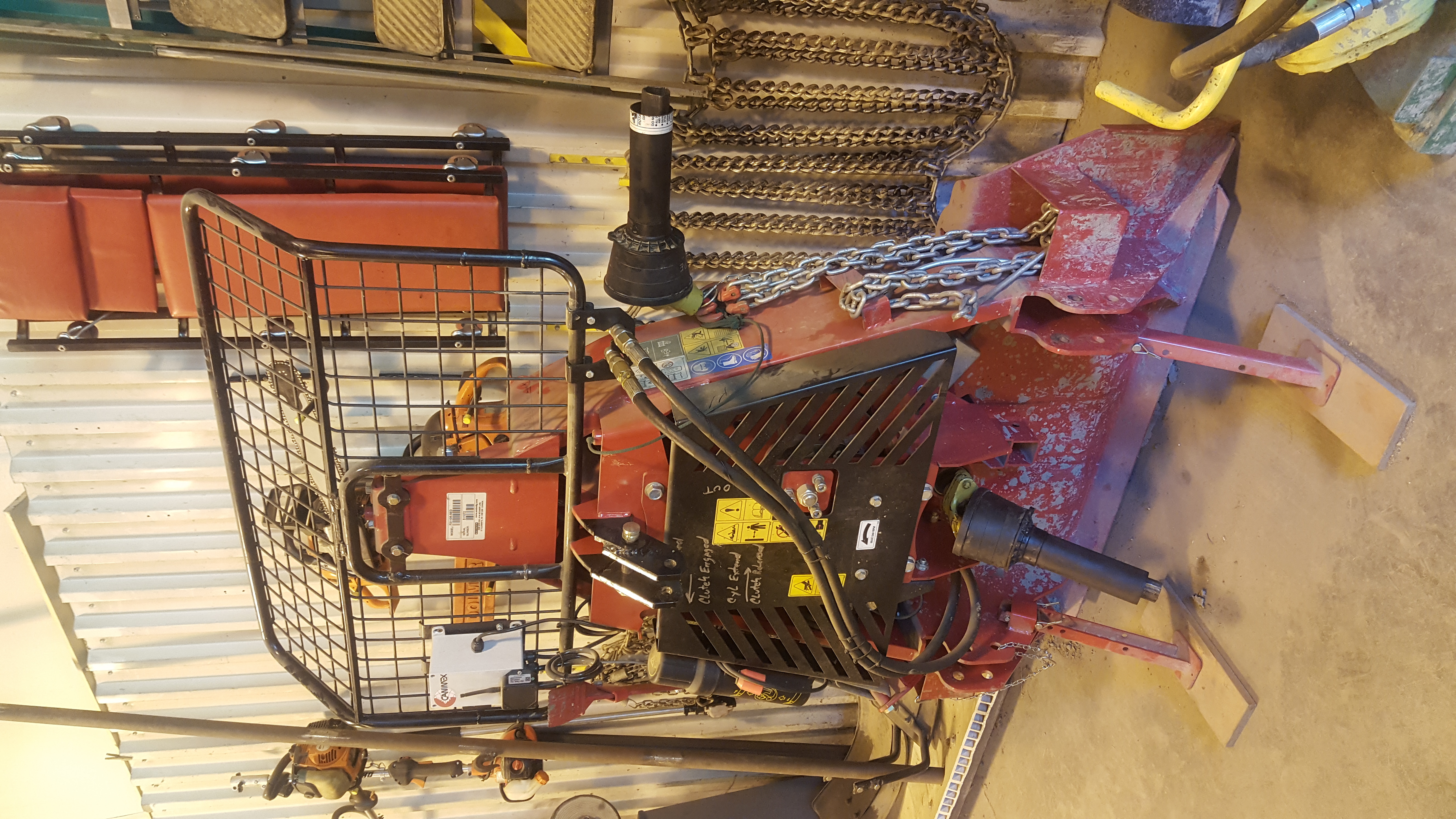

So I have 1 rear remote and that remote controls the front grapple. Rear back hoe dump trailer wood chipper and wood splitter. Often I disconnect the 2 lines from the grapple when I require another implement hooked up. Then I don't have a good place to store the lines and the next time they are covered on mud , dirt and dust. Is there a item like a dummy plug to hold and support the hoses?
Preferable something that's not going to open the hose ends so the oil all leaks out?

Another option 5089L209 Hose Hanger made by Wallenstein. Show in the attached pic. You may need to zoom in. Modify and mount 20180707_173310.jpgas needed. Later
