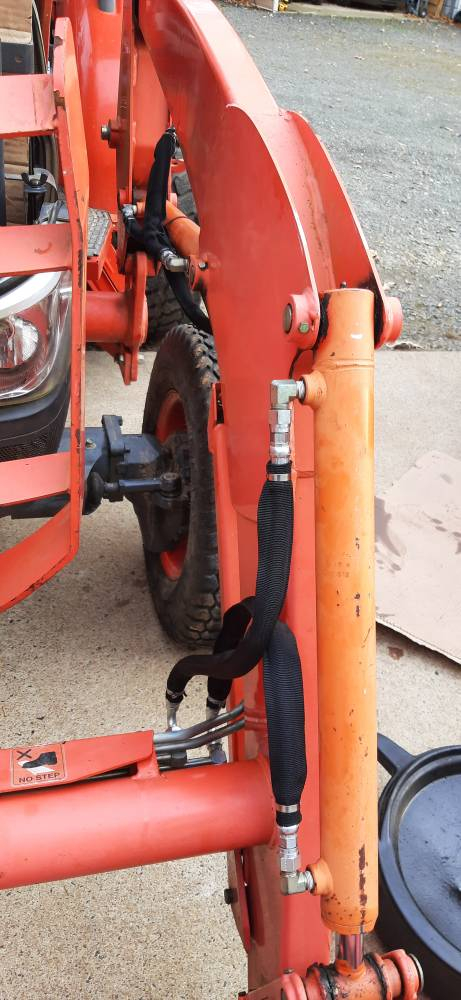

What did you cover them with ?
I use PET expandable braided sleeving. It's a lot cheaper than hydraulic sleeving. You can get 1" in 100ft. roll for about $22 off Amazon.
When you buy sleeving, keep in mind it's sold by the diameter of the sleeving and not the size of the hydraulic hose. So 1" will cover 3/8" hydraulic hose nicely. You can choose to melt the ends to keep it from fraying or cover the ends with electrical tape as I did. For hose that's subject to a lot of movement, I added a tie wrap over the tape.

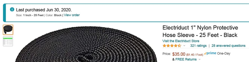

Just re-hosed the loader on my L3240, I use protective sleeving for UV protection and help prevent a mess/injury from hose failure mostly (abrasion resistance is also a plus on some applications).
I've ordered from some of the companies already mentioned but last couple were from this vendor, Electriduct 1" Nylon Protective Hose Sleeve - 25 Feet - Black https://www.amazon.com/dp/B07G5N23D...abc_W7MSBV21F4BDTAMSWVR9?_encoding=UTF8&psc=1 they also have a size chart in the pictures.
Hopefully I won't have any more hose failures as long as I own this tractor, at least from degradation. I also replaced the large sleeve that holds the 4 3/8th hoses coming from the loader valve.
