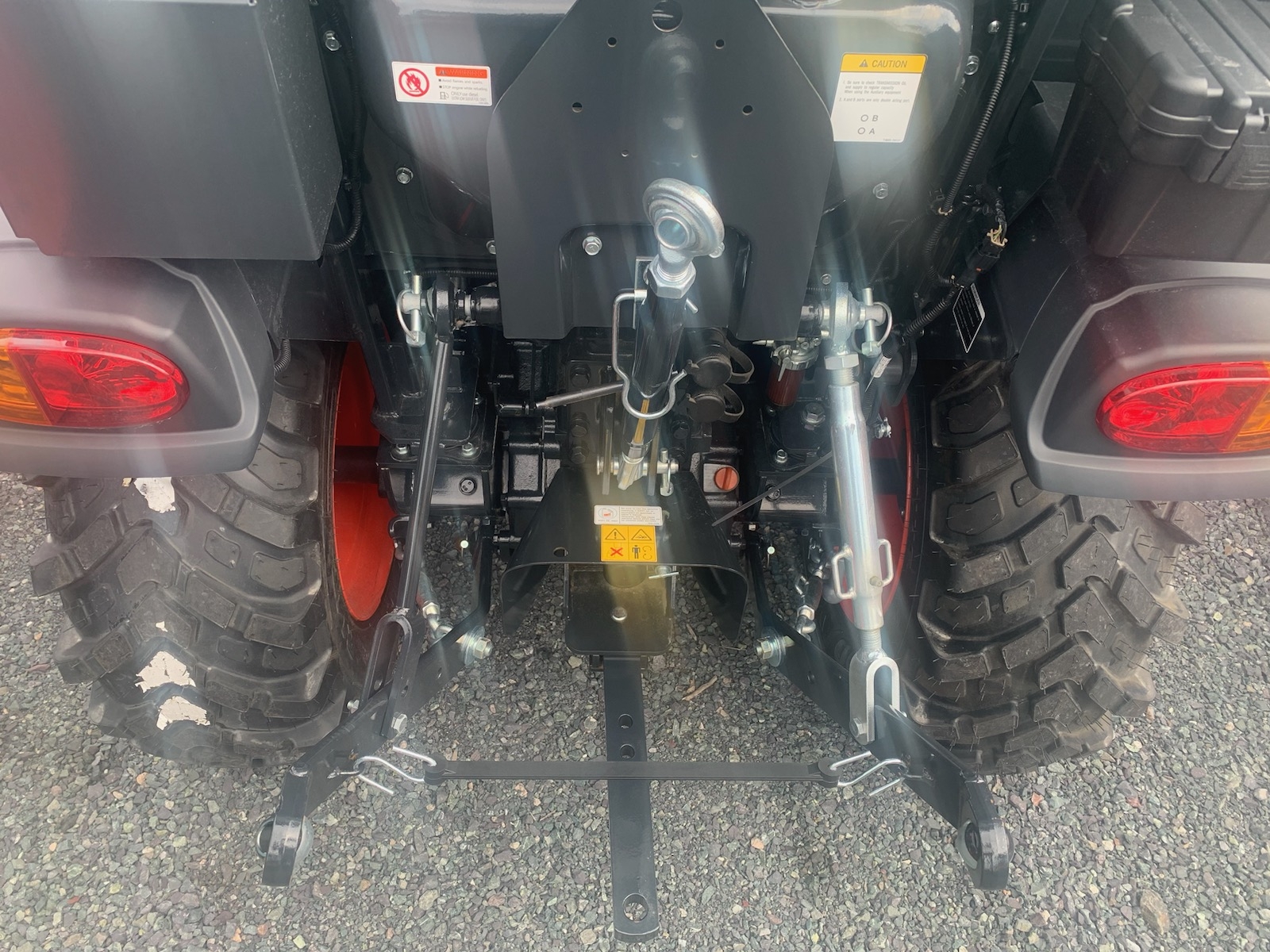

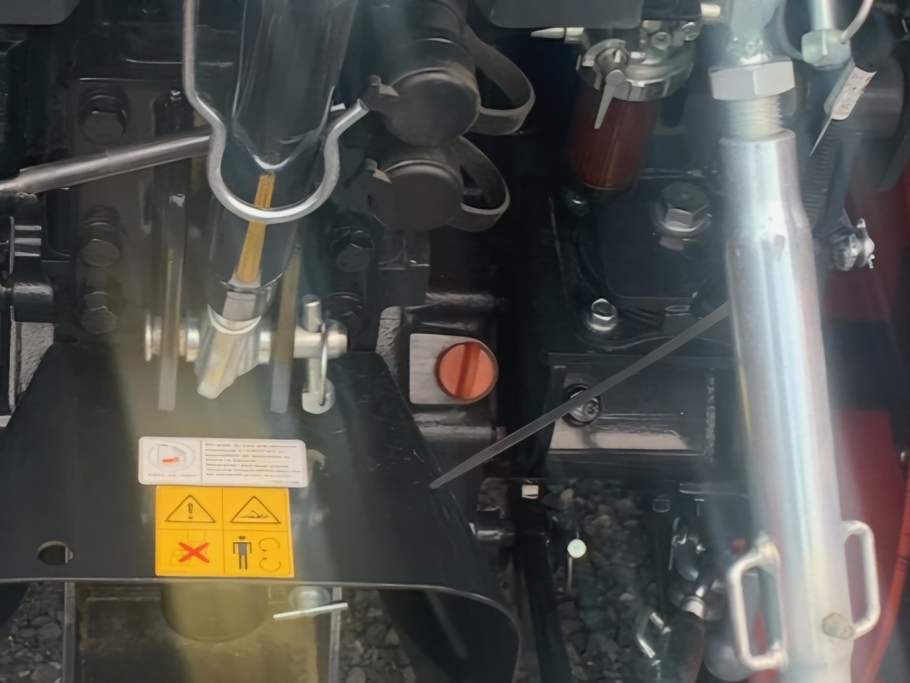

Can anyone tell me where the hydraulic fluid is checked and added in a Kioti CX2510....I think I found it but just not 100% sure.
Thanks in advance guys.

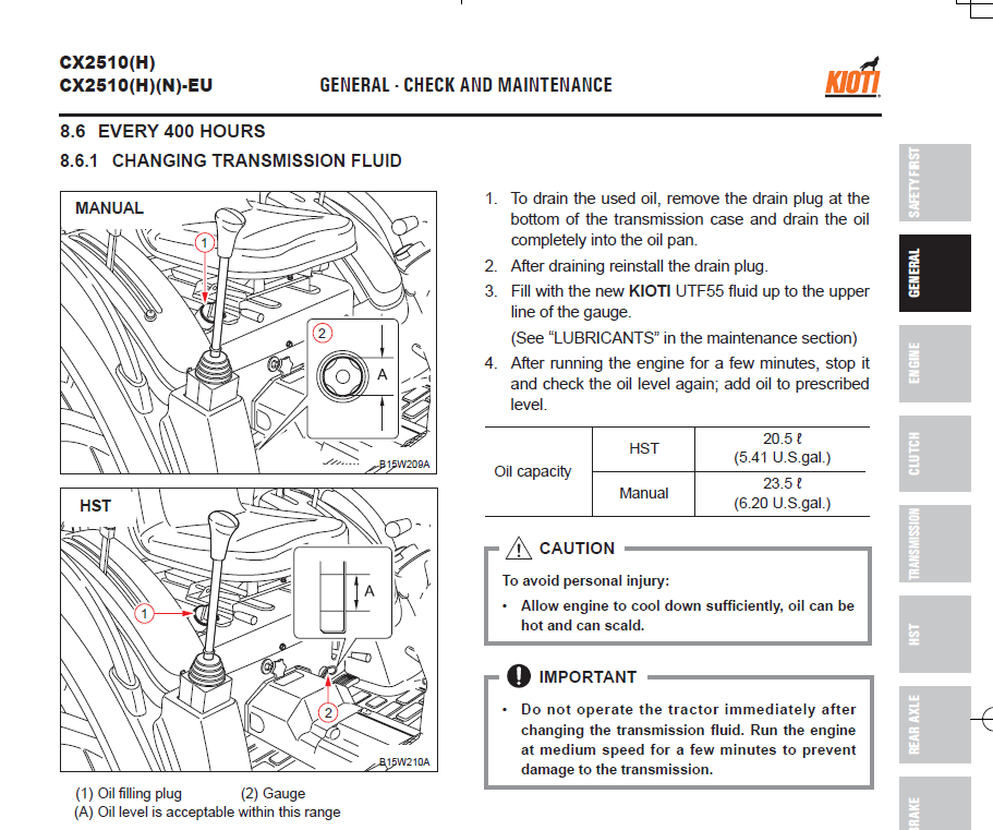

You check the fluid using the dipstick by your left heel as you sit in the tractor.
I was going to say that you add fluid on that orange fill port in the picture, but the manual shows otherwise. I guess you kind need to see if you have that fill plug they show in the manual or if that was changed.

/ hydraulic fluid #6
I was confused at first as well, as the filler tube merely says "oil".
There is no dipstick, just the sight glass as shown on the diagram ptsg put up.
The diagram leaves a lot to be desired, though. I don't know about the HST, but on the manual, the sight glass is down below on the bucket control side.
