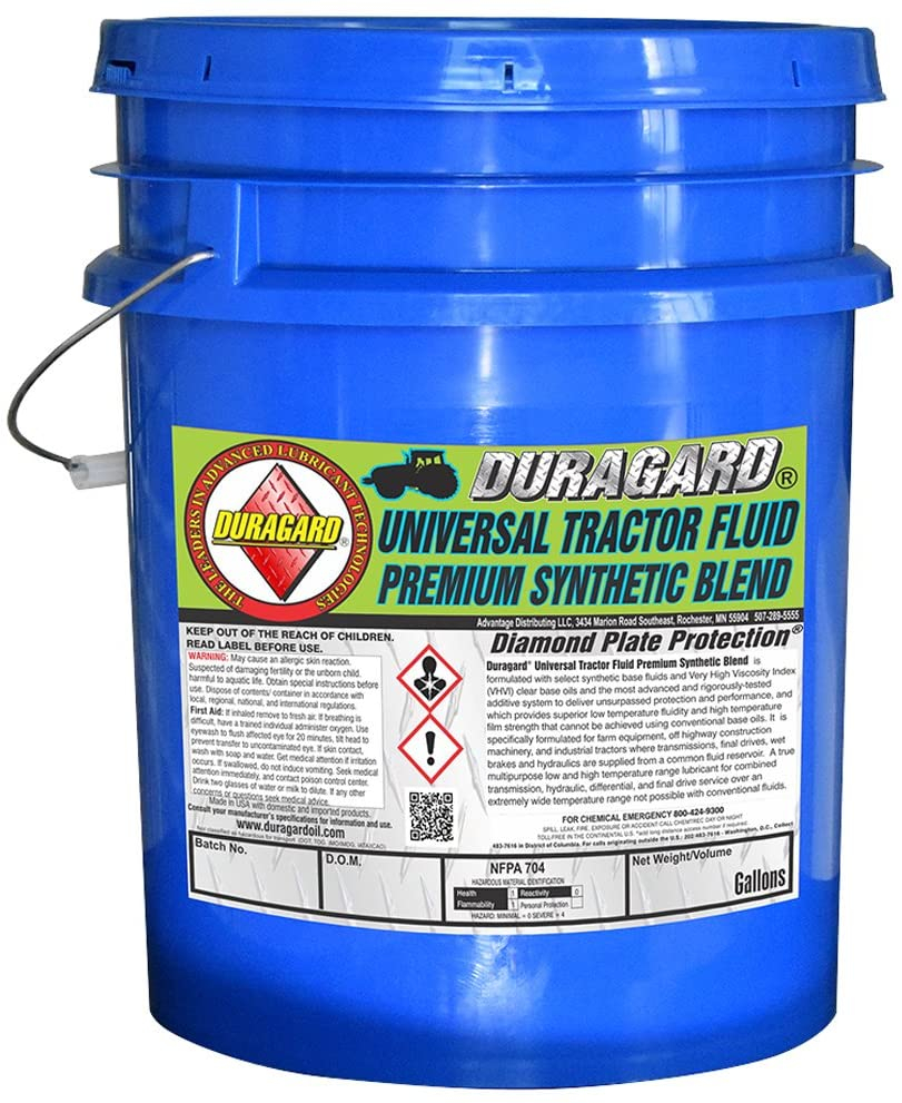

I'd use "premium tractor fluid". Which is an imprecise definition at best. My manual says to use Texaco TDF or 1893.I think the shop manual says Chevron THF500 or 1000. I can't find what 1893 is. There are equivalence pages on the internet for Texaco TDF and Chevron THF.
If you have good parts stores locally you may be able to get the Chevron at a good price. I can't find it locally. I have used Mobil 424 and Duragard semi synthetic. The vicsosity numbers on those are pretty close to the Chevron THF1000. It's hard to tell about the additive package but anything that is "premium" ought to have the additives for wet clutches and brakes that the cheap stuff does not have. The Duragard was inexpensive on Amazon with free shipping. It's also dyed orange which helps with the level in the window.

This?
Looks good. It's $89 on amazon. Tractor Supply has Mobil Delvac for $60 and their Travelers premium for $48, and O'Reilly's is $58 but they don't want to sell it to me for some reason. Friday, they had 1 5gal in stock and said they would call and have more on Tuesday, they didn't, and trying to buy online, I could get one pickup in store but not 2, said it's unavailable. Weird, that's a very normal, typical thing they do. Try to buy on line have it shipped, it says 'eligible for free shipping', go to checkout and it says 'not available for free shipping'. I hate it when stores do that, they need better shopping software. Especially considering when I tried to keep going to see what shipping would cost, it crashed and sent me to an 'oops' page, so, oops, I'm going elsewhere.

This?
This is the same one I buy on Amazon. I used the Tractor Supply premium universal before this. After having 2 hydraulic pumps go out after only 500 hours each I decided to try the Duragard. I have not hit that 500 hour mark yet using this. I can say when using my bucket or backhoe I do not get the same noise as I did before. But like others say, everyone has there opinion on what they like to use.
